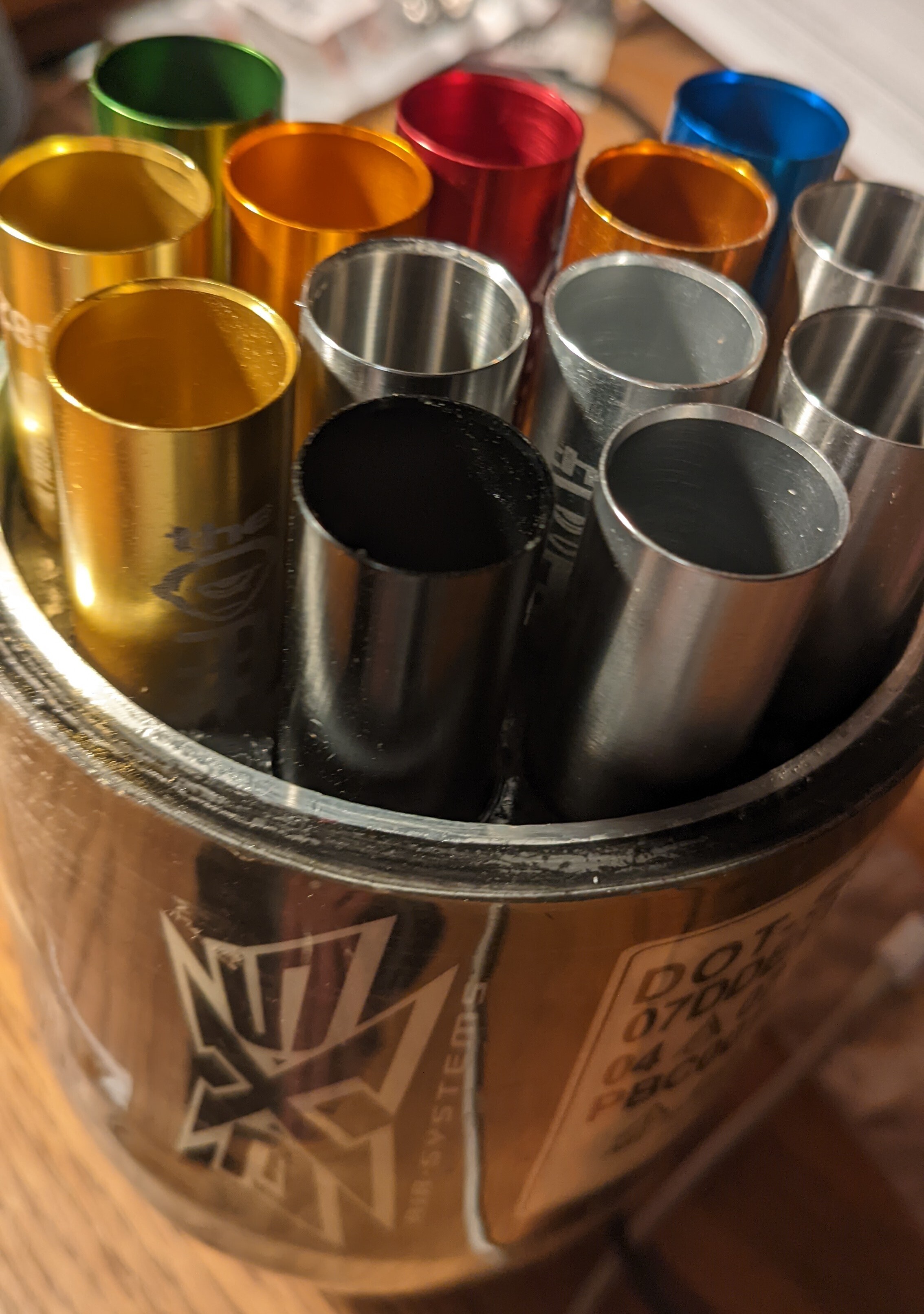

      Here is mine: https://www.mcarterbrown.com/forum/c...ose-freak-case
      I dont think the blade will hold for long ... I had to sharpen the cutoff blade 4 or 5 times for the 1 tank ...

        What type of cutoff blade did you use? Did you have to sand or cleanup the carbon at all?
        how did you end up securing the top back on? I’ve been thinking of adding a lip to the print I can make a friction fit with. Would love to find a way to figure a latch and hinge though.
        also best way to remove a reg without buying a removal tool?
          • 3414
          IIRC, X used a parting tool on his lathe.
          I literally take a vice and leave it open enough to slip the reg into from a side. I then rotate slowly til the gage jams on one jaw, and the fill nipple on the other. Then load it up and turn. most break loose pretty easy. There's a frlew I have where the regs didn't budge. You can scratch them this way, but Idont care you much.
