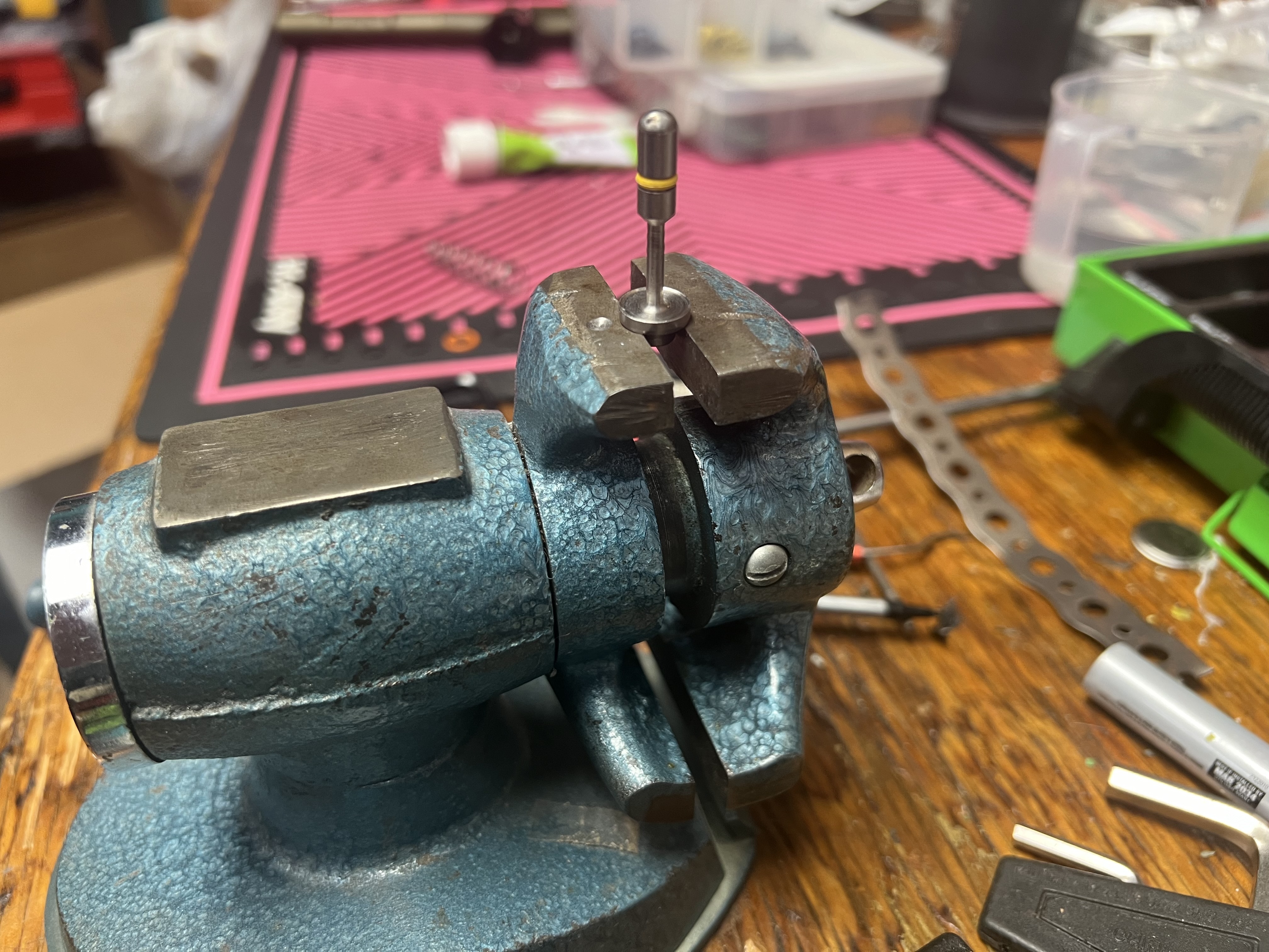

    Today I faced my nemesis and won!

    ... I'm sorry, what am I looking at? Cupseal removal?

      Timmy valve o-ring. Or in this case a System NME. Squeezing a 004 o-ring onto a giant shaft. Finally got a soft enough oring. The 90 dura ones I had just split.

    Next time, if you have fairly thin needle nose pliers, sometimes they can work
      Cdn_Cuda commented
      This is just done with lube and fingernails! And the little vice to hold the valve. Now maybe I can resurrect this old beast!

    Sometimes when i repack lift cylinders , i heat up water and drop in the seals to make rhem more pliable. Glad you conquered the problem,take a bow as the victor.
