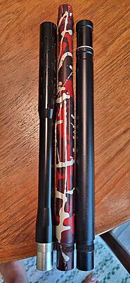

                        I wanted to chime in with my totally non scientific anecdotal testing from this weekend.
                        I wouldn't bother trying to freak a stock emek barrel, but if you have any OG barrels laying around they are worth freaking. Dig out that old pro series for sure.
                        Older larger bore barrels benefit greatly from freak boring. I was gifted the terminator barrel from Santa. I after had the Armson, and APP hitman barrels bored. All three of these are .690 or larger bore stock. The arnson is obviously rifled, and the app is straight rifled. I was hoping to have 3 sleeper barrels with different results in shot profile. I think these will foot the bill.
                        Last weekend. I let my buddy shooting a sniper with an OG freak test the APP. He claims it's way quieter than the freak, and very accurate. He credited many good shots where his victim didn't even know whom shot them. He essentially asked. " how much??" After the day of play. I'm still not sure I want to sell it yet.
                        The terminator barrel shot well on my laz valved trilogy. No breaks at 300 fps for the few rounds I used it.
                        The armson I ran on a ccm t2. It was deadly accurate. I got many one ball shots that even had me surprised. Not sure if I can credit the barrel, or the shooter here, but man I'll need to yest both next weekend further.
