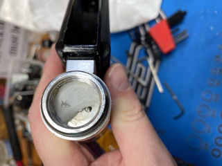

    Alexndl - Thanks for identifying the reg! Couldn’t get it apart as I missed the internal set screw. Being able to Google Ion reg saved me a lot of time and frustration.

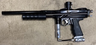

    Took the cocker apart. Valve o-ring was toast. Switched out to a different valve, made sure orings were okay and threw it back together. Threw on the Mavdev Gladiator I had laying around which matches the shocktech Asa, but the macdev barrel kit on and promptly ran out of air to test. Cleaned up nicely! There was actually a very old spider web/nest in the Asa......
    That pump is a steaming pile of poop though. Sloppy and twisty. Going to have to find a replacement.

      Thanks Again Alexndl! Put some Teflon tape
      On the cocking rob threads and made sure both ends were screwed in tight. Took a lot of slop out of the pump kit. It’s for a delron back block so it’s got some wiggle still, but massively better. Might see if can rig up a pump arm stabilizer like the low end pump kits run.

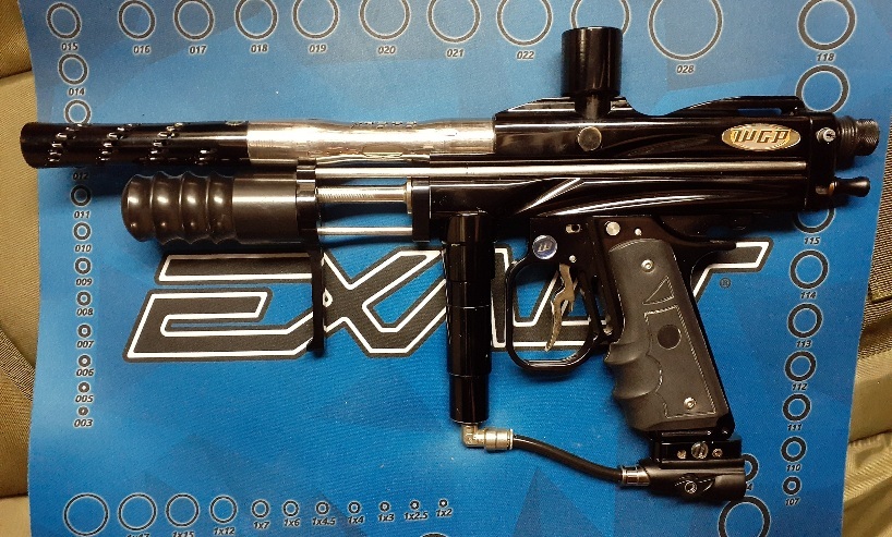

    #18
    If you put a CCM deluxe pump kit it will look a lot like my main pump 😁
      Cdn_Cuda commented
      Nice build! I just bought the same tech mat as well. Really like having the o-ring size chart.
