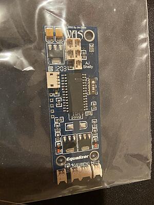

            Are you 100% sure your WAS board isn’t programmable? I have 2 and both have several firing modes, can set the rate of fire, and solenoid dwell. Once I turned off the tournament lock.
            I want to say even the early WAS software levels you could set rate of fire, but could be wrong.

              all WAS boards are programmable, but finding someone with a WAS programming software, a data-link, windows 98 and an rs232 port is probably the more difficult part
              however pandora boards were fully programmable and can be had for cheap.. as well as the morlock as previously mentioned (as long as you don't mind wiring it up)

                Ah, maybe we’re talking about different WAS boards. I have two of these WAS boards in my Vikings and changed them to PSP mode & 10 bps without a computer.
                I have wired Morlock boards in a few of my markers. They’re great.

                  #23
