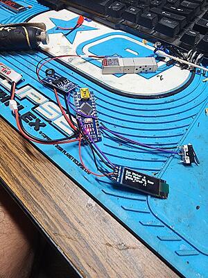

    Hey everyone, i just wanted to share a project i have been working on. After burning out a board i intended to use on a GZ timmy the other day, I set out to make my own solution. I repair a number of older guns that dont have 10.5 ramp stock, so I am always on the hunt for boards. I had dabbled into arduinos from other projects (nerf blasters ) and figured this could work here. So I came up with this (eyes not pictured here)thumb_85913.jpg​.

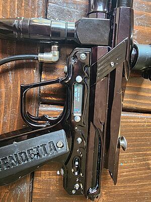

    its an arduino nano controller, a mosfet board to drive the solenoid, a small microswitch for the trigger, and an OLED screen for display. The system is powered by a 1s lipo that you can get in various shapes and sizes. Its coded (thanks chatgpt!) so that you can toggle settings when you hold the trigger down on powerup. I was able to design some grips that let me add the oled on the side of the GZ. Uses breakbeam eyes for paint detection.
    thumb_85915.jpg​

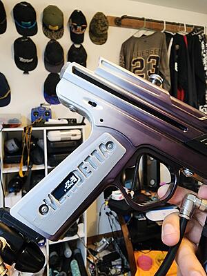

    I have since added one to my Lasoya as well.
    thumb_85917.jpg​
    Its a good solution for your own markers imo. Saves a few bucks to get stuff running on ramp. Here is the video of the gz using it:

              The minimum to get by is a loose mosfet, digispark attiny85 and 3s lipo.

                So what $80ish for the first 3 and then coat goes down from there since you will have some of the supplies already?
                Damn good price right there. Nice work
                • Pballwiz24
                  • Sep 2024
                  • 13
                  yep thats the basic math. i have a solution using cheaper eyes and/or stock timmy eyes, but i am working on them having enough "range"
