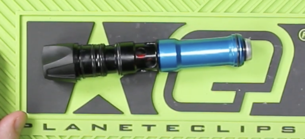

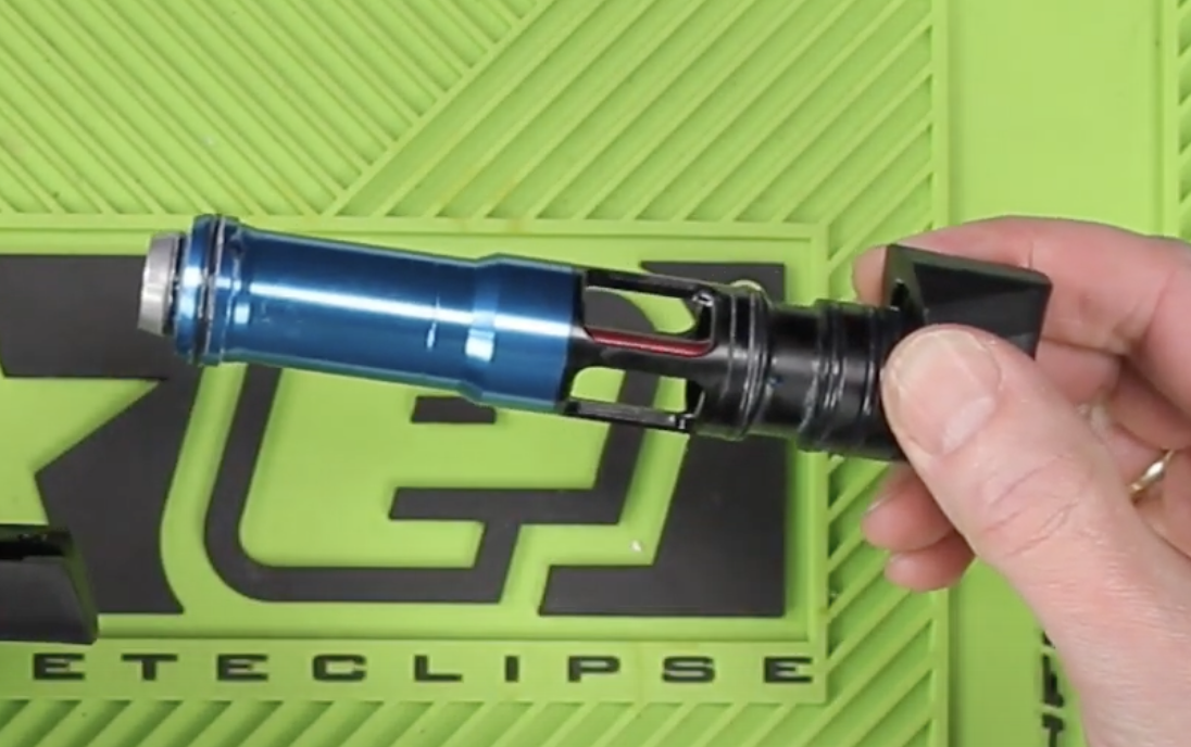

                The emek and 3m have different valve bodies. The 3m is the same design as the 160/170R, and the emek has the Swiss cheese valve body. In my head the 3m shoots better, but I doubt there is a difference.
                Click image for larger version  Name:	Screenshot 2024-09-18 at 11.24.37 PM.png Views:	0 Size:	459.5 KB ID:	593646
                Click image for larger version  Name:	Screenshot 2024-09-18 at 11.25.36 PM.png Views:	0 Size:	731.4 KB ID:	593647
