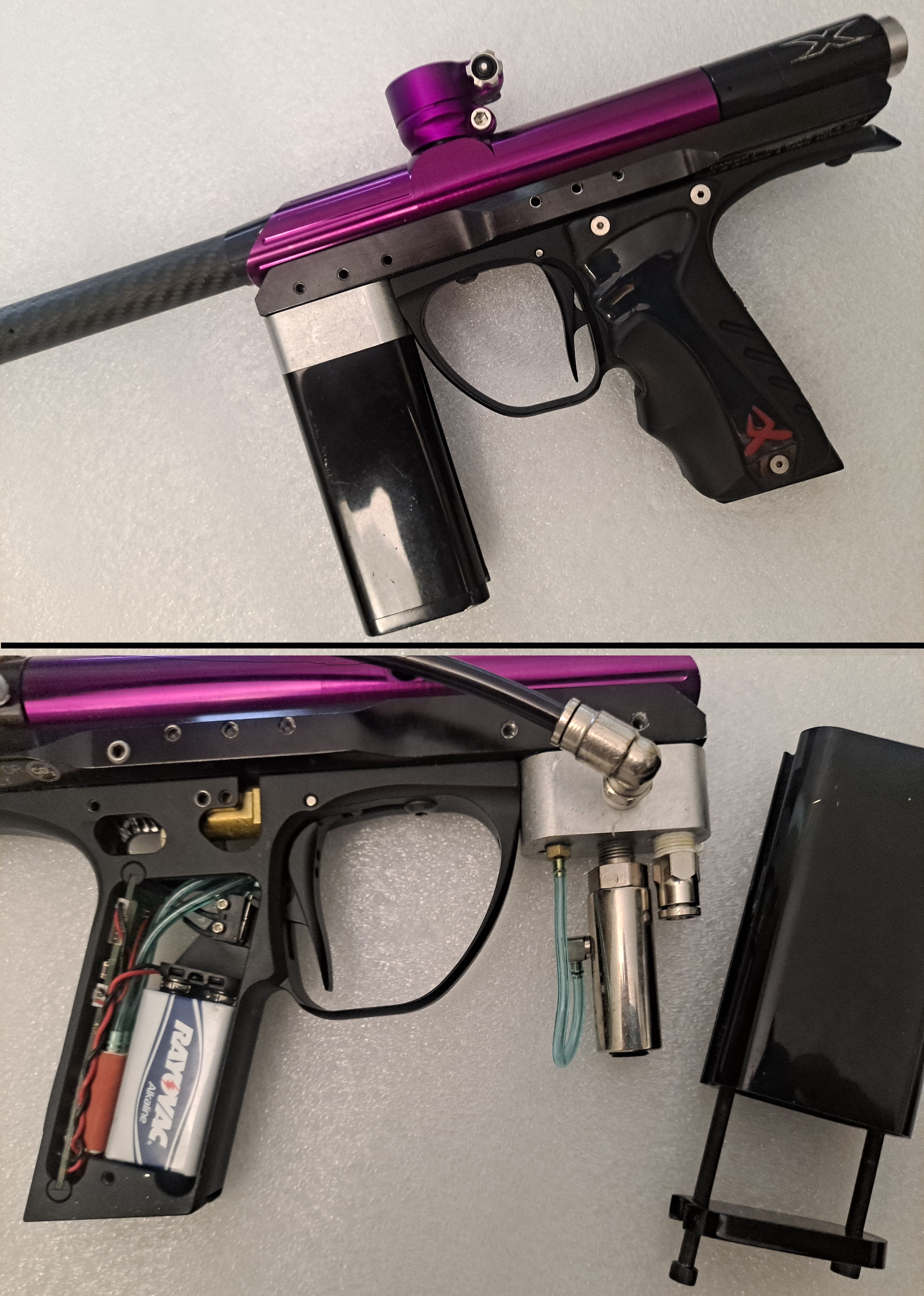

      I've never had or built a egomag. But my understanding is you used the ego frame and board to run a pneumatic soliniod that runs a ram.that pushes on the sear. Very much like a pnuemag setup.

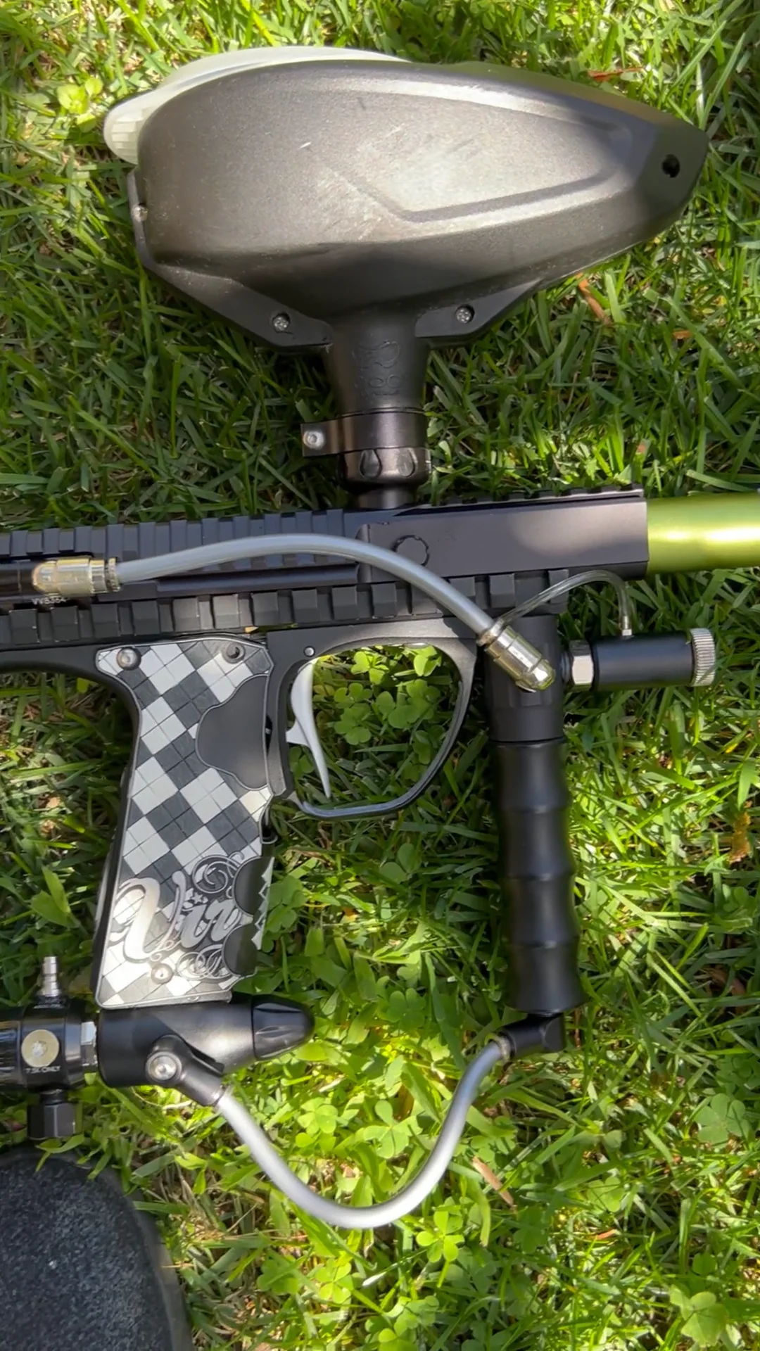

          I fixed that one. It was a little rough, but got the ram smoothed out and the frame straight as could be. Shot well.
          https://vimeo.com/817079145/40813f53d2

        Like others have posted, it's an electro-pneumag. The Ego frame and board are used to control a small solenoid that fires the usual Clippard actuator everyone uses in a pneumag.
        They can get pretty elaborate - Hill over on AO built one with eyes - and they shoot pretty nice, but considering what's on the market these days for electros, building and using one is mostly for bragging rights at this point.
        Olsson has one I built (not an Egomag but still an e-pneumag that uses a BKO frame, a Trilogy SF board, and a one-off aluminum Classic valve that Kit made me. It's pretty awesome. 🙂)

            I've made a few pneumags out of Ego frames, but I never kept the electronics inside. It's embarrassing to admit, but electronics have always intimidated me for some reason. I could never get them to work right. So please don't ask me for help. 😅
            Besides, Jordan is right. There's not really a good reason to make an Egomag anymore, not when you can get something like an Axe or Etha 2 for much less than it would cost you to build a mag alternative. Not unless you like to tinker and want to build it yourself.

              Here as example ---
              • ETEK board in a STAR frame or similar
              • SMC solenoid S070C-SDG-32
              • LPR of your choice
              • Pneumag ram to trigger sear, nested in frame - MPA3 or similar
              Air to LPR, to solenoid, to ram, ram actuates sear. Hoses can hide in frame and/or in some rails

                I have built a few egomags in the past. The difficult part is getting the noid to fit. The smaller noid has a lower pressure threshold and can leak if it is not paired with a good regulator. The other solenoid is pretty solid, but big.

                  My old thread on it, most of those pictures are long gone. https://www.automags.org/forums/show...ghlight=emaggo
                  used a small Fetco linear actuator as the ram. I’m building one right now for fun because I found a one of the rams in an old tool box.
