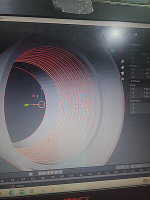

        Each ring from 675 to 685, very effective
        • sonixr7
          sonixr7 commented
          Not sure of the display diagram. I can imagine a 10 inch barrel starting from .675 that increased .001 every inch which would end at .685 at the exit. My guess would lead to paintballs traveling inconsistently due to the points of contact changing at each step.
        • Snowpuff
          Snowpuff commented
          @sonix7 it's made out of extremely soft tpu or a type of super soft rubber , it's only 3/4 inch long . But you're idea with longer sizers might not work... perhaps it will get breaks, but you should small to big maybe it won't??? You Gotta test it man lol

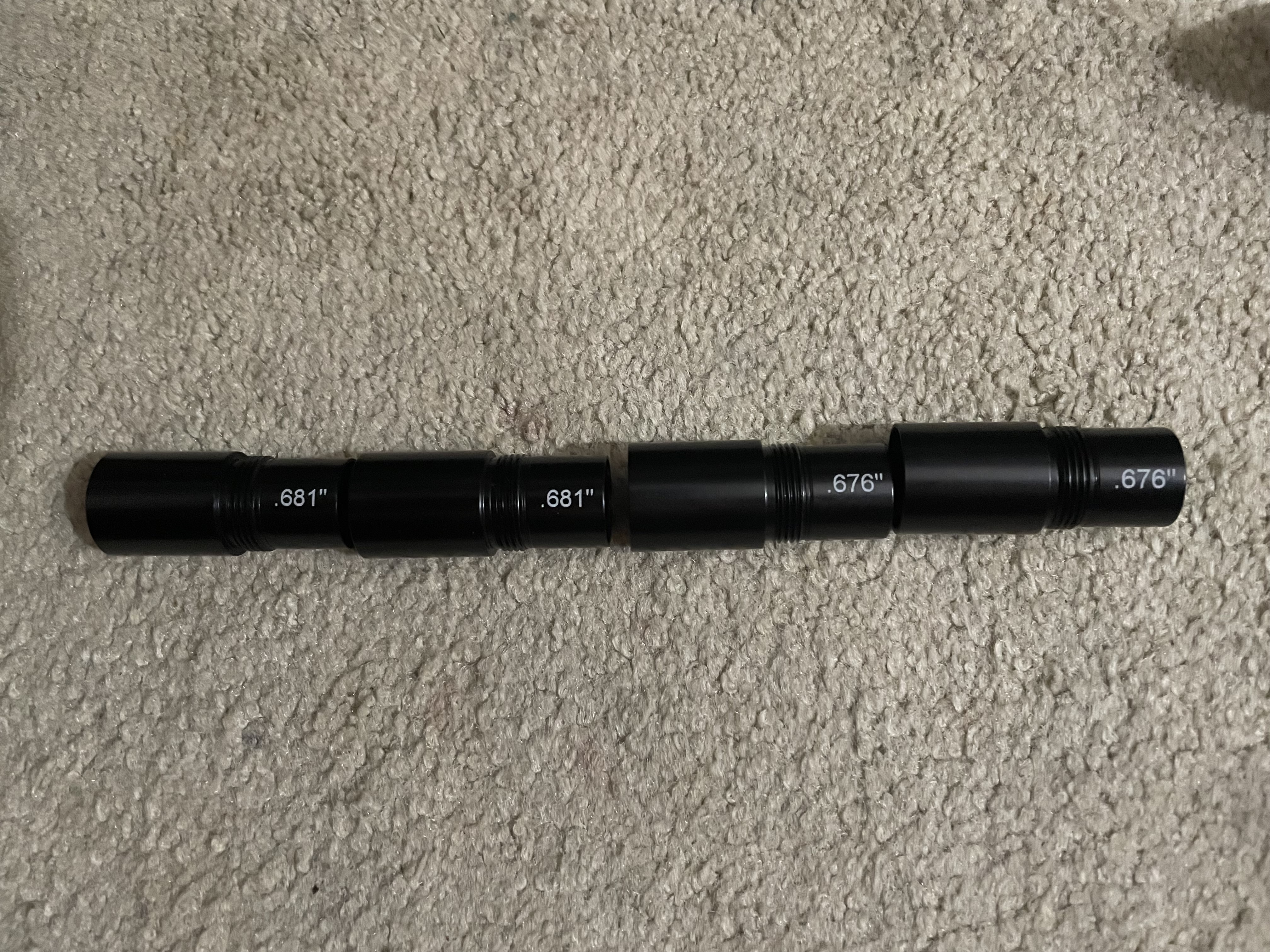

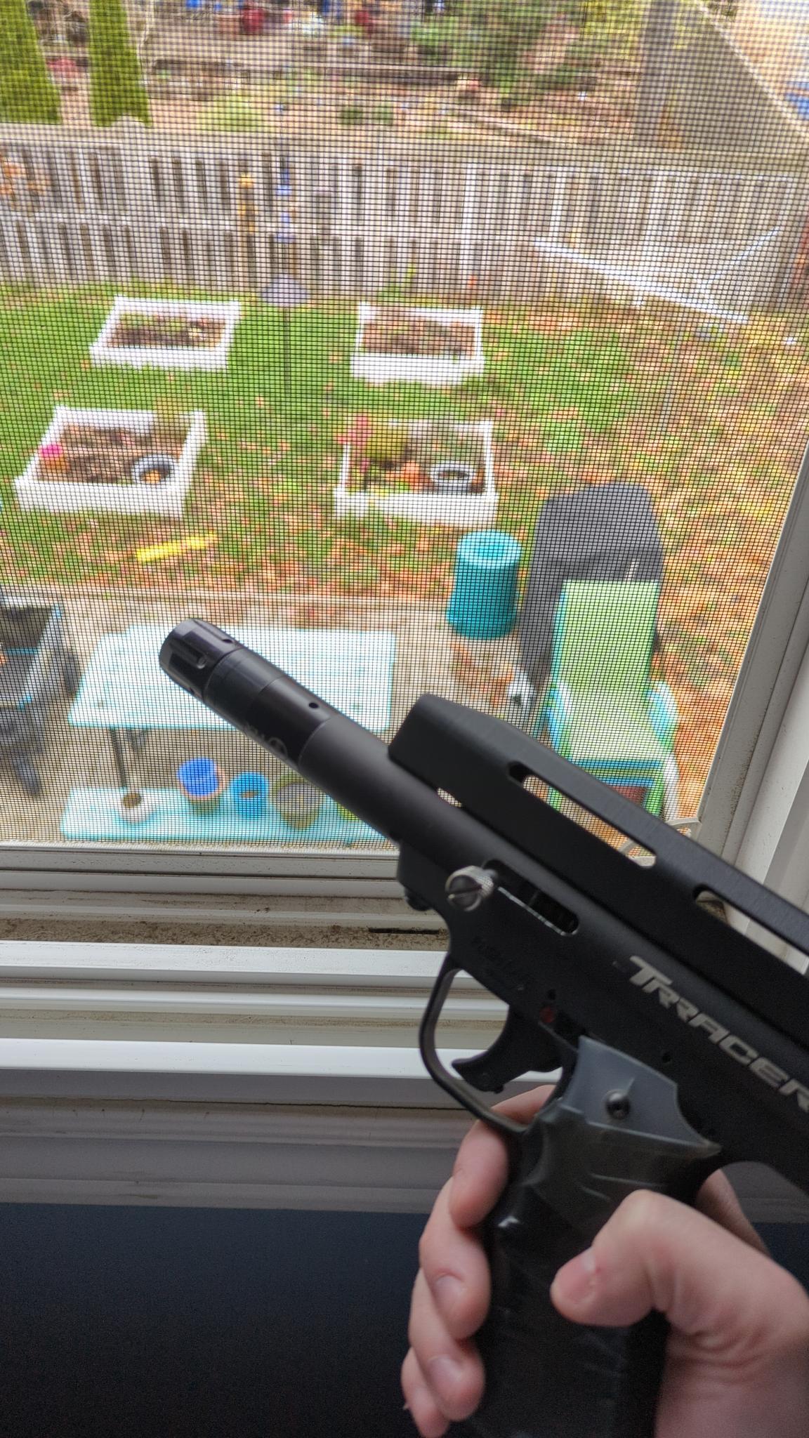

        I use a TechT iFit with a Doc Tanto barrel on one setup. Gets a bit more length out of the Tanto barrel. I use a small sizer in the iFit for ball-retention, and then adjust the freak insert as a stepped bore. Kinda like the old Eigenbarrel.
        I find it can relieve barrel breaks when using shitty paint. Results may vary.
        I've also run the iFit with a Stiffi back to create a very short barrel.
        • RAZRBAKK
          RAZRBAKK commented
          Wow those are some awful photos.

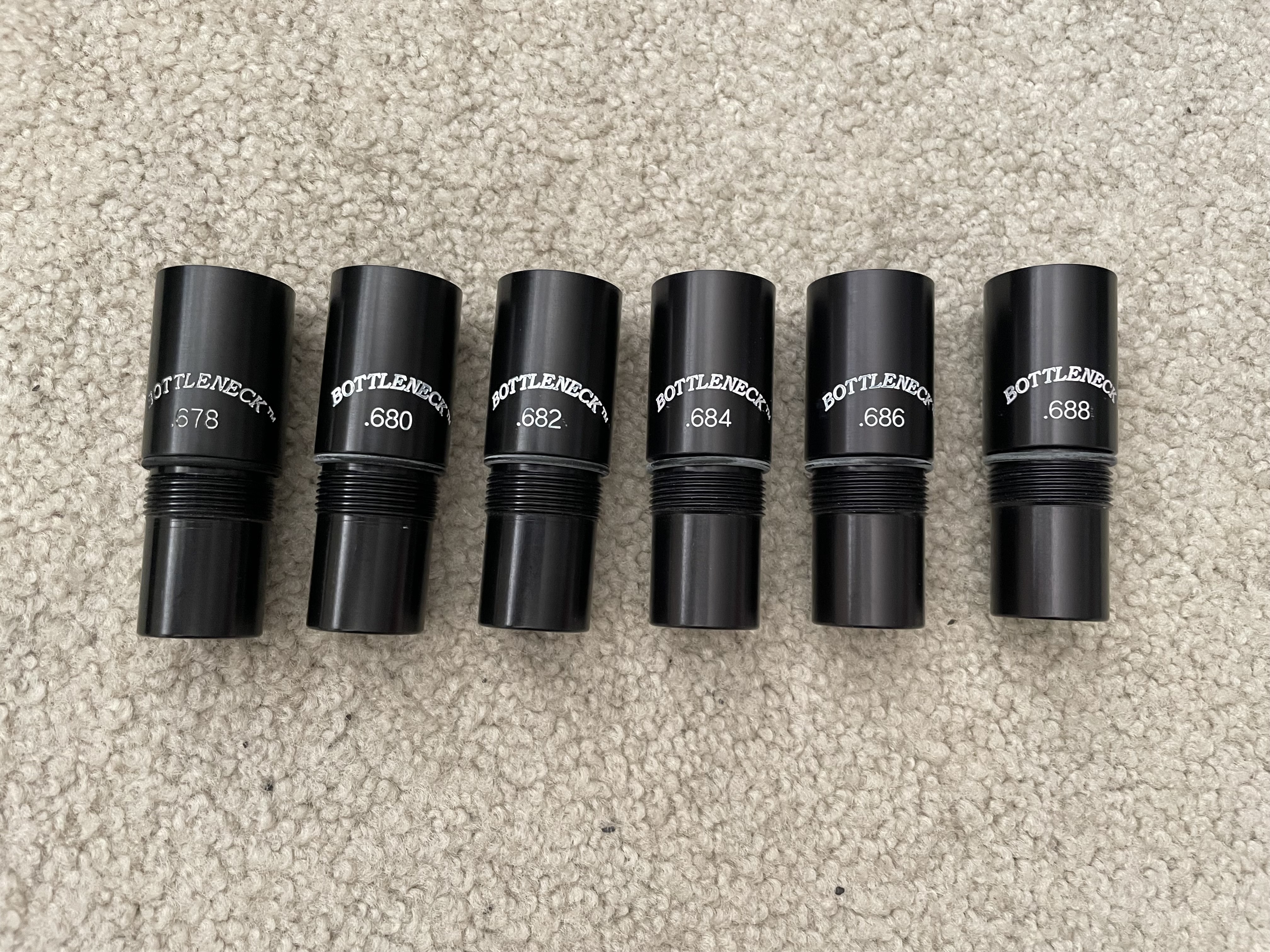

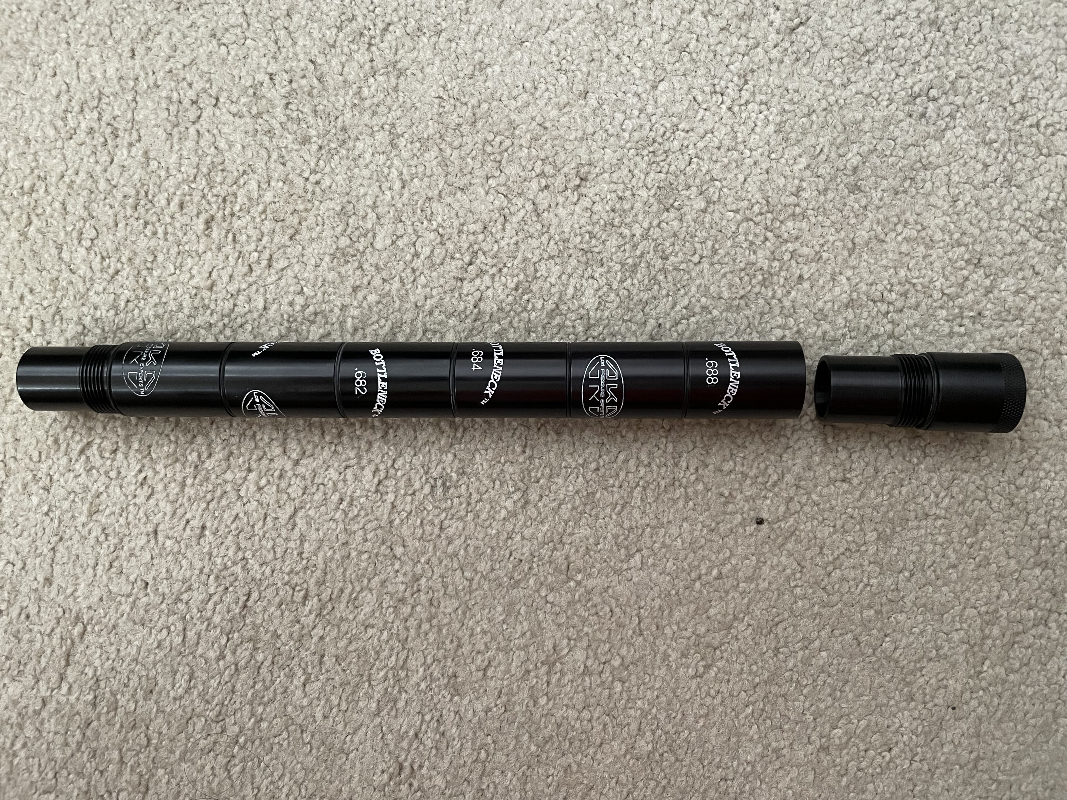

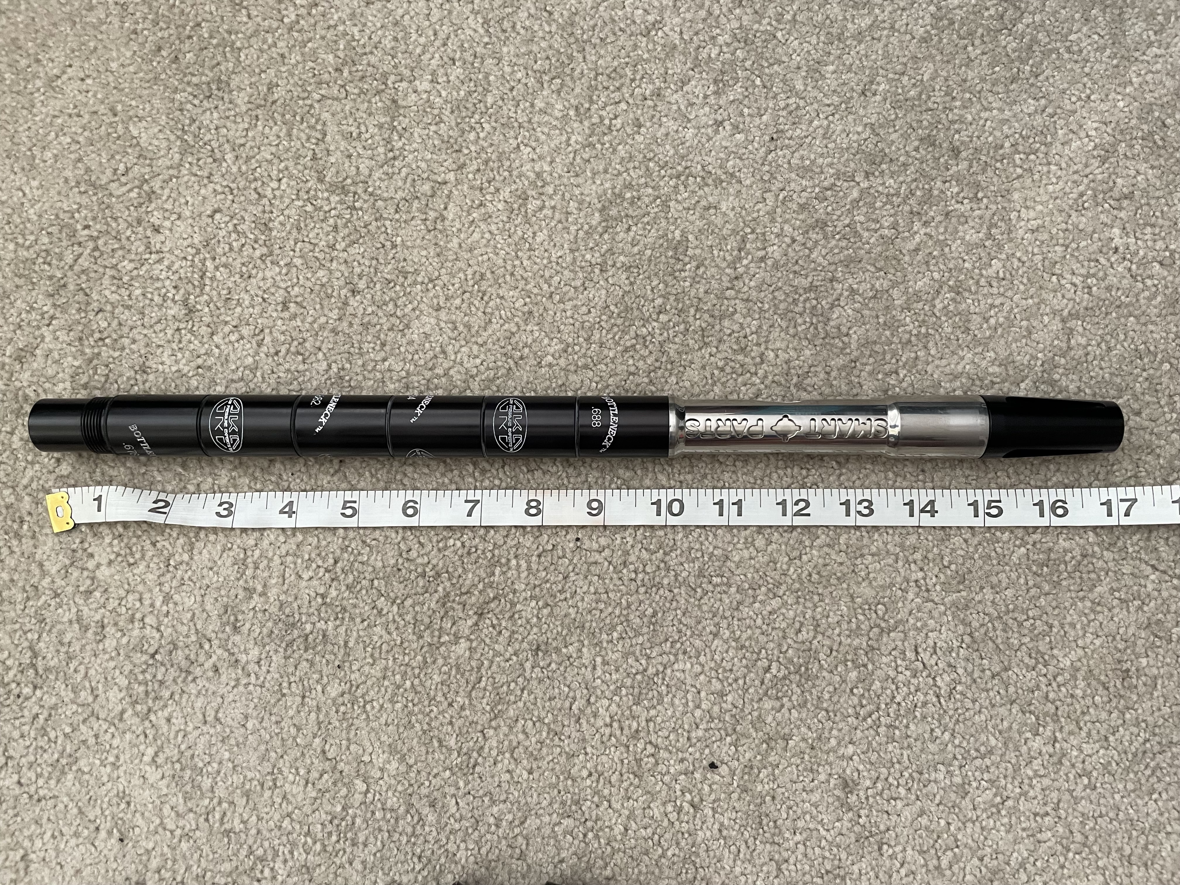

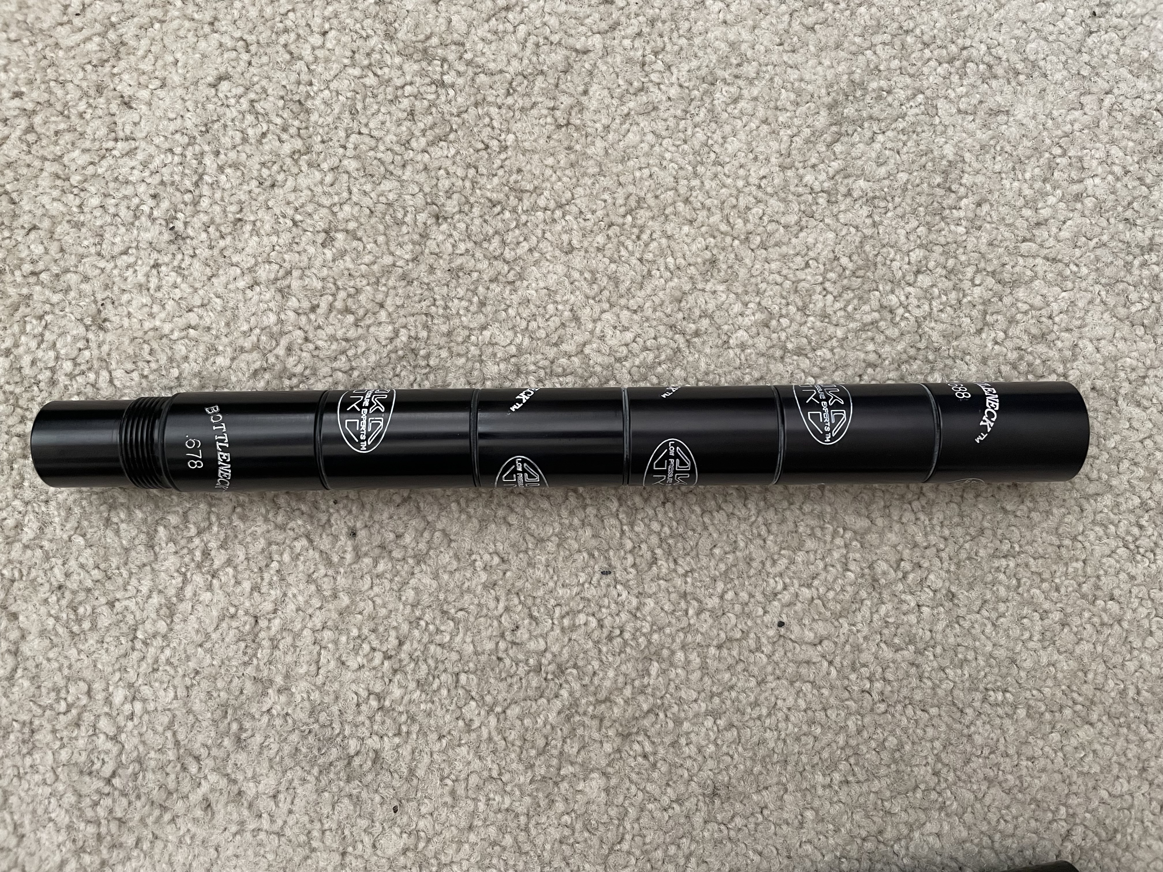

        AKA Bottlenecks .678-.688 makes a 10in barrel.
        With a .691 Freak insert and White Wolf 2in front makes a 17in barrel.

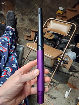

          I have a neat barrel that I could use 2 different 5" inserts with. Its a freak back with cocker threads instead of freak tips.

            Did you make that yourself? If so, I would be interested in commissioning a few.
          • JeeperCreeper
            JeeperCreeper commented
            No, sadly I still dont have a lathe. But its actually an Avratech R7 barrel

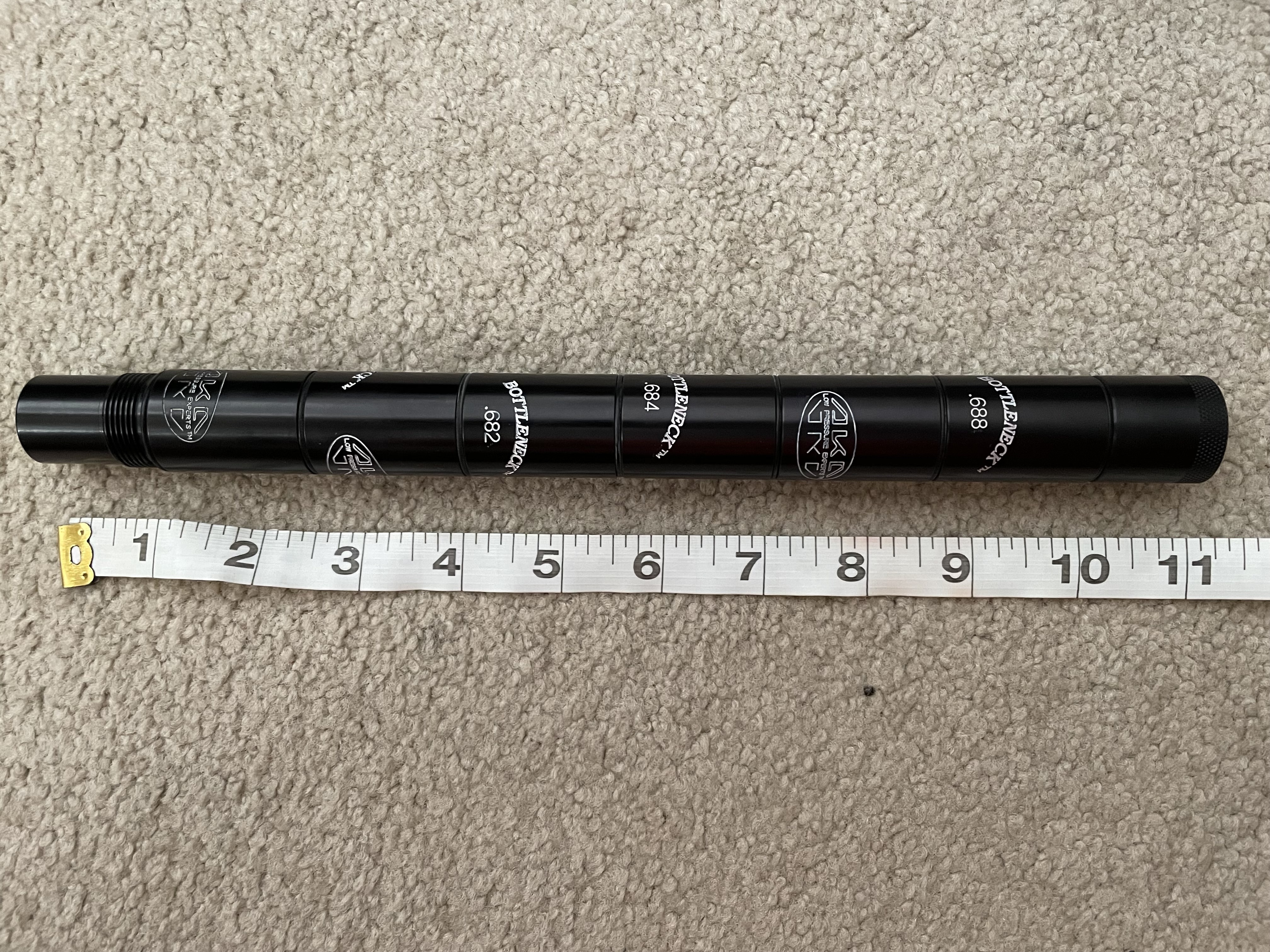

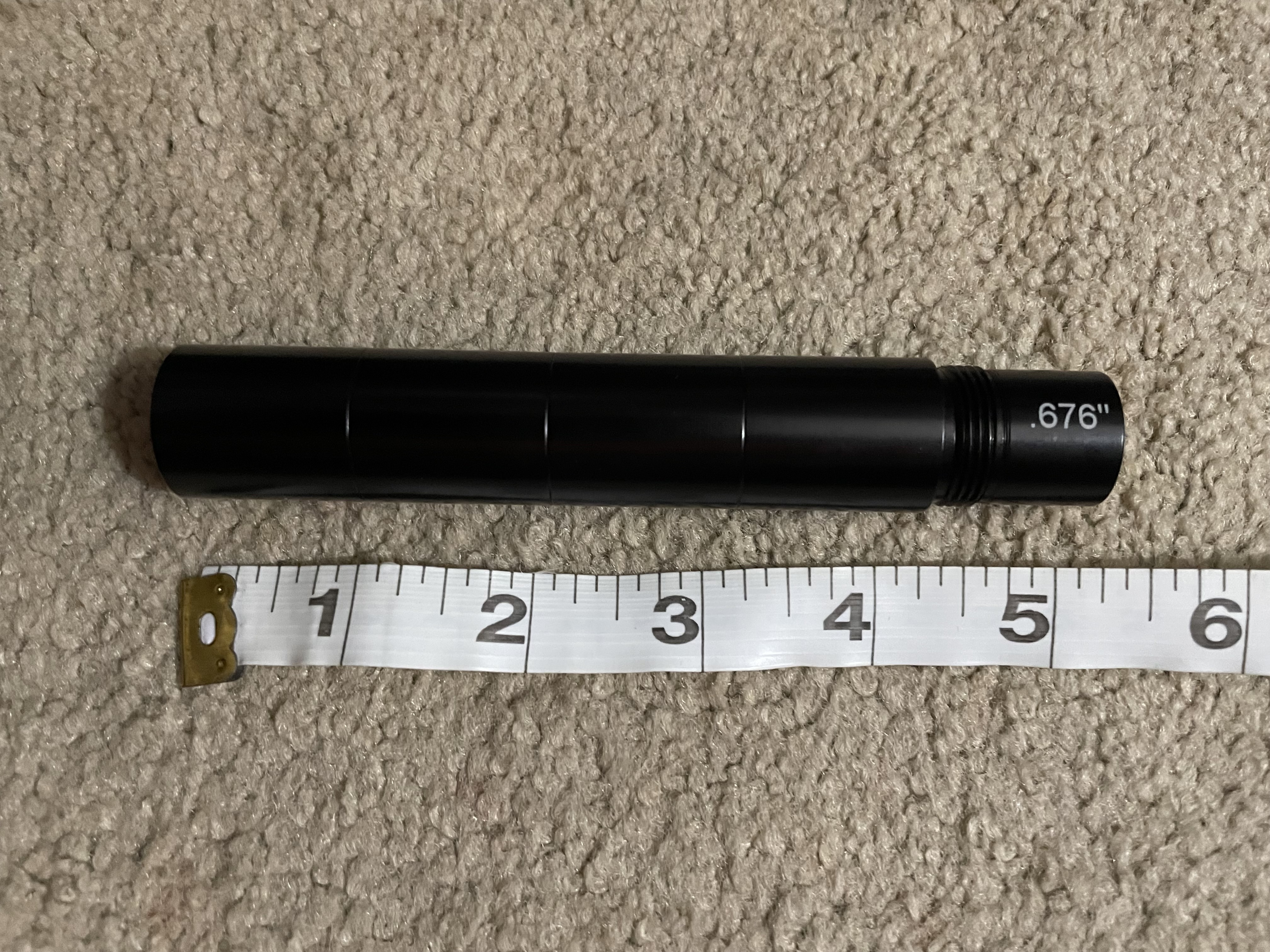

          Found a 2in barrel from Python Paintball. 11 inches total.

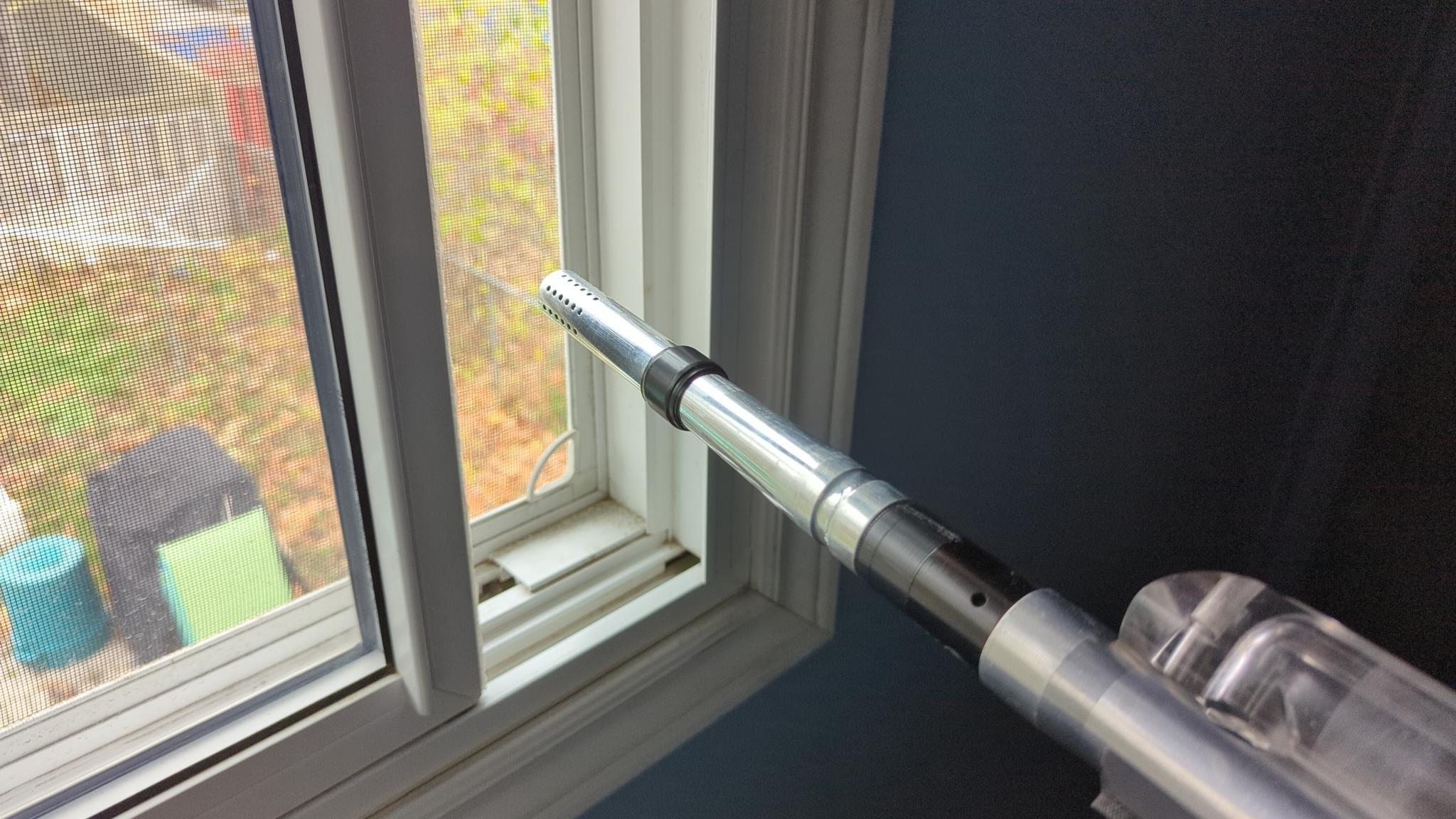

            So heres the 4 piece version, an R7 barrel with a Tanto barrel for a tip. If I get an XL adapter, I'll have the ultimate 5 piece barrel that would make Price wet his pants, an XL in the back, and a 5" in the front.
            Cue punch lines:
