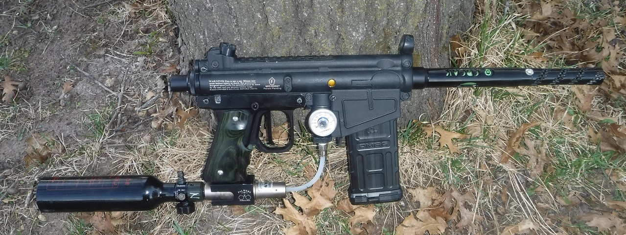

    The Stormer is kind of like my main magfed setup, though it's nice these days you don't have to literally build it.

    Mine is based on an older A5, but overall function is basically the same, though mine has a big pile of rare aftermarket goodies. Sometimes that's half the fun.
    So a light, quick setup, with nothing on top so you can come out of cover in all kinds of weird directions without presenting a big hopper as a target.
    Mine was quite a hit at my Nephew's bachelor party, a very newb and renter heavy environment. Plus after playing most of a day with just 14 rounds in a mag (two stacks of 7, you have to flip them half way through, so basically stock class without the tubes), when I switched to my hopper fed autococker near the end of the day a 200 round hopper felt like it would last forever.

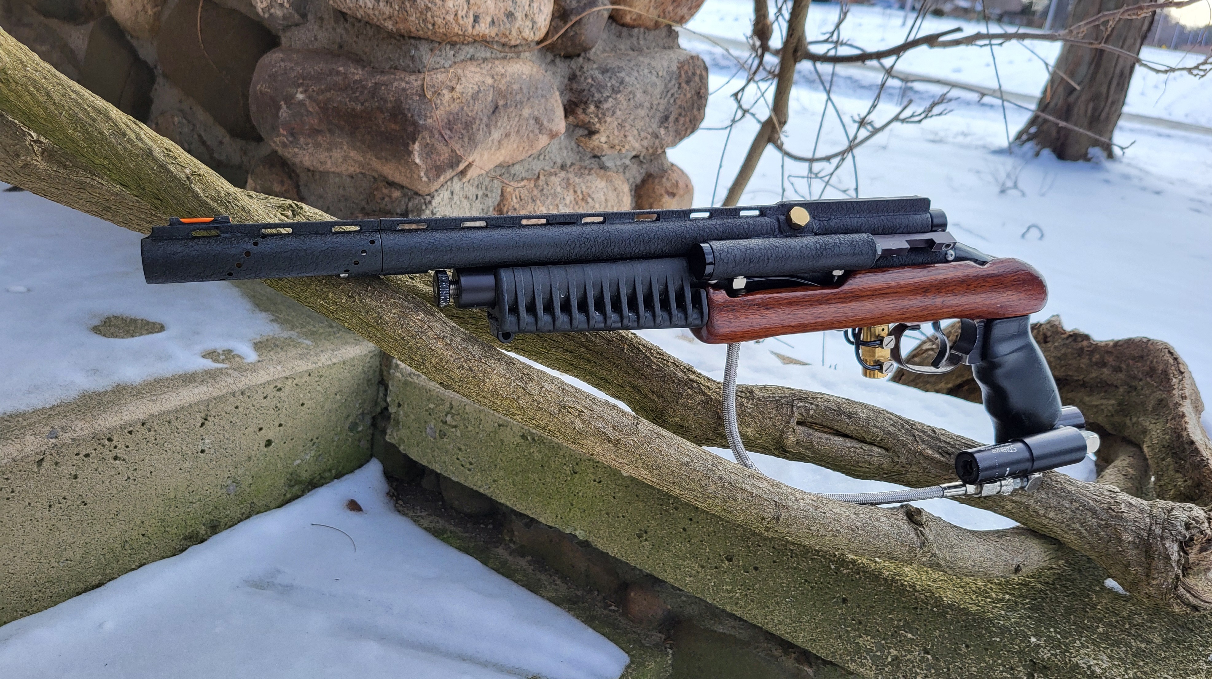

          I built this thing for my limited paint setup... I'm really not a fan of hoppers anymore and reloads under fire make things exciting. 🙂
