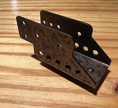

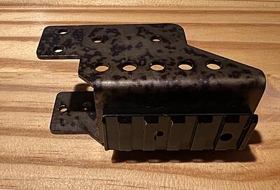

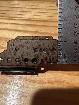

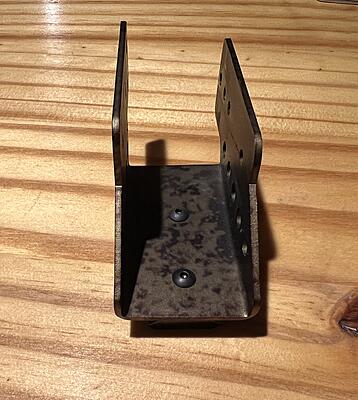

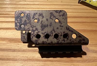

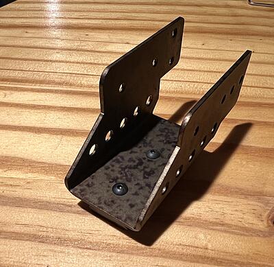

    It’s a more complex asymmetrical piece than I recall, mine also had a matching anodized spacer on the left side. Here are some general pics to start:
    This gallery has 7 photos.
    • Blackmagic71
      • 896

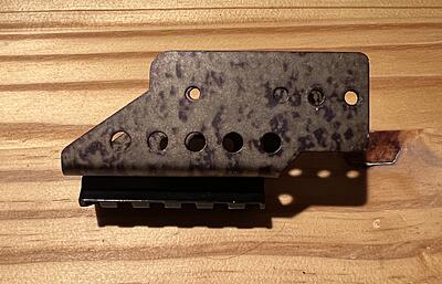

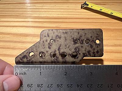

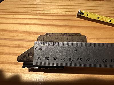

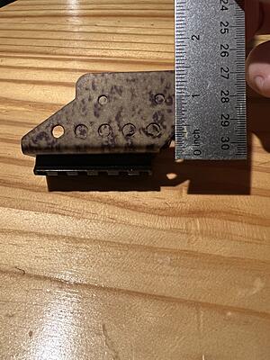

      Drivers side measurements
      This gallery has 5 photos.

        Thank you so much!!! I did not know about the spacer. Seriously, thank you for taking the time to do this. What gauge aluminum would you guess?

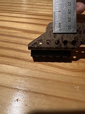

          Passenger side
          This gallery has 4 photos.

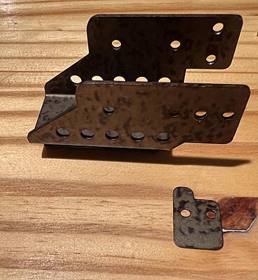

          • Blackmagic71
            • 896

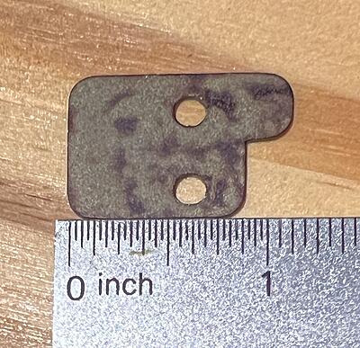

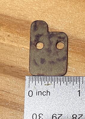

            Spacer
            • Blackmagic71
              • 896
              The shroud appears to be 1/16” thick, the spacer is slightly less.
              the shroud appears to be cut from one solid piece and then each side was bent up at 90 degrees.
              I’ll be honest my ruler is pretty inadequate for getting good measurements, I’d probably need some kind of digital gauge to get good ones.
              The more I look at this the tougher I think it would be to replicate without just sending it directly in to a machinist.
              Your best bet might be to PM one of the handier/skilled guys on the forum like Doc.

                lazer/plasma cut and bent. pretty easy to replicate for the average garage monkey with a drill and angle grinder too

                  So I think I may create a template off of the measurements that were so generously provided and try to bend it to shape. I am not sure if I will be able to drill those holes in a perfect straight line. not sure how to get those just right.
