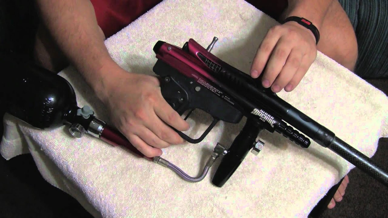

    A post on Reddit drew my attention to this thing.
    I knew about the old WGP Worr Machine blowbacks and never thought much of them, but this thing seems VERY different.
    The manual has a schematic but there's not a good indication of how the 3-way valve that appears to be behind the trigger works or what it does. There's an input regulator but the trigger valve taps off gas UPSTREAM of the reg?! More confusingly, the one Youtube video I was ale to find of one working shows it having a FASOR-like return spring in front of the bolt which isn't depicted in the manual, AND the bolt appears to be biased forward when degassed, which would be the opposite of how I know FASOR guns to behave. On top of that, it appears you can short-stroke the trigger, and all the dwell is mechanically set?
    I'm totally baffled here.
    According to the comments in the video the gun IS electric, contrary to the manual and diagram, and he says he's seen multiple variations of "solenoids" in the guns, so perhaps these are prototypes where they were going in a different direction than at first thought?

        The spring on the bolt is for the "Anti-Chop" bolt. The VL (Danger! Danger!) High Voltage used the same bolt.

                      So watching the video again, I can't help but wonder if the owner/narrator is giving out incorrect information a lot of the time. He says that "you don't have to cock it, once you put air to it it's cocked..." implying that the resting position of the bolt/ram is forward until given air, but you can't see the bolt move to a rearward position when the gas source is engaged. If William the Third is correct and that's just an anti-jam bolt and the spring in the upper tube has nothing to do with the operating mechanism of the gun, it could be that it really is just a traditional blowback from the grip frame up. I've never worked on one of the old Trilogy SF 'cockers, but my understanding of how they work is that the solenoid doesn't directly act on the sear or ram, but instead is basically a pilot valve for a secondary ram in the grip frame which "pulls the trigger" in place of the user as in a normal 'cocker. The AG might be doing something similar- the trigger is acting as a pilot valve for a small pneumatic system which trips the forward sear in the grip frame, not unlike an electronic blowback. Partially pulling the trigger might cause it to hiss, but unlike, say, an Emek there would be no way to short-stroke the gun because either the "slave" system lets go of the sear or it doesn't.
                      Also, I'm guessing that barrel-shaped component in bottom of the grip frame is the LPR.
                      The comments on the video are further confusing because of the idiomatic practice in paintball to refer to any small pneumatic control valve as a "solenoid" whether it's electronic or not.
