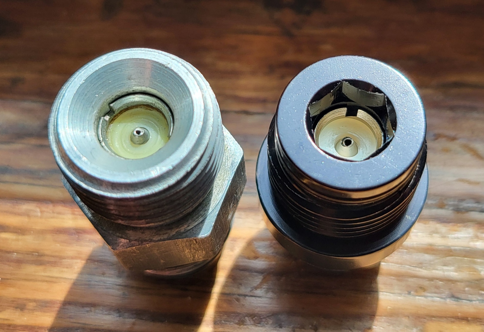

    I have a brand new bucket changer that won't seal.
    If I stack another gasket in there I can get it seal... comparing it to my twenty five year old BE bucket changer, the pierce pin is larger and sticks out past the seal further.
    I got it in the mail last night and blew through my last few Crosman 12ies trying it, so I bought a box of 12 grams from a different manufacturer hoping that might do the trick... no dice.
    I have no doubt I can get EV to take care of it, but the changer is supposed to go out in the mail tomorrow - along with the gun I bought it for - to a buyer... and I don't look forward to the invariable tariff and customs fee BS to be charged on replacement parts that I already paid on the friggin' changer.

            can you file down the tip of the piercer?

              It's the width of the piercer cone that's the problem, really... the 12ie can't push down far enough to seal. If I take a Dremel to it I'll likely damage the seal and then I've got two problems.

                Left - BE changer, right - EV changer

                  Somehow the EV pierce pin looks recessed quite a bit deeper.
                  Perhaps the shoulder of the 12g prevents it from getting in all the way.

                    EV switched to hard nylon face seals. PGPJunkies makes a urethane replacement that I prefer.

                      Thought I'd try something and swapped pierce in assemblies between the two changers, and I now have two functional changers.
                      I've already shipped out the marker this morning so I now have two bucket changers I have no use for instead of one, but at least they're both functional.
                        I thought so too, but no.
