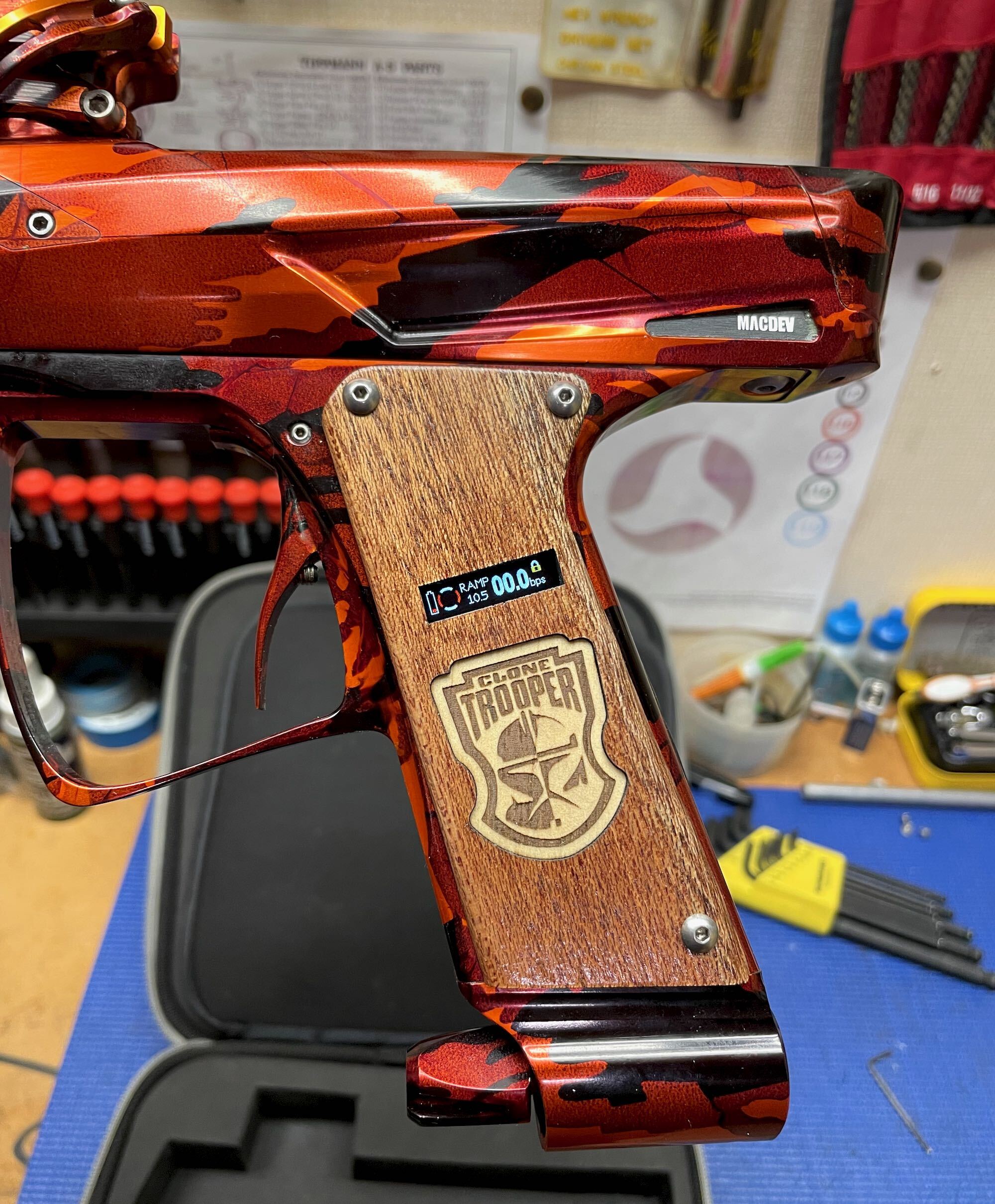

    Just finished making a pair of grips for a 2013 MacDev Clone GTi. The originals had become brittle and started crumbling so with no factory grips available I decided to make my own.
    I scanned in one of original grips and created a vector file to cut out a new pair from 4mm timber on a laser cutter. After a bit of hand finishing and a coat of lacquer I tried them out but they looked a little plain. So I grabbed a Star Wars “Clone Trooper” logo off the web, scaled it down and created a vector file to laser engrave onto some contrasting timber. I then cut out the logo and a corresponding hole in each grip using the laser before gluing them in. The final touch was cutting out a screen window in acrylic on the bandsaw and gluing it into the left hand grip.
    All in all I thought they came out way better than expected.​

    That’s cool man, love the in depth homebrew

      Solid work!

        That’s sick dude.

          Good work. I am going to try doing some wood grips too. Thinking I may try the colored wood stains they have now. Be cool to have some purple, green and blue ones.
