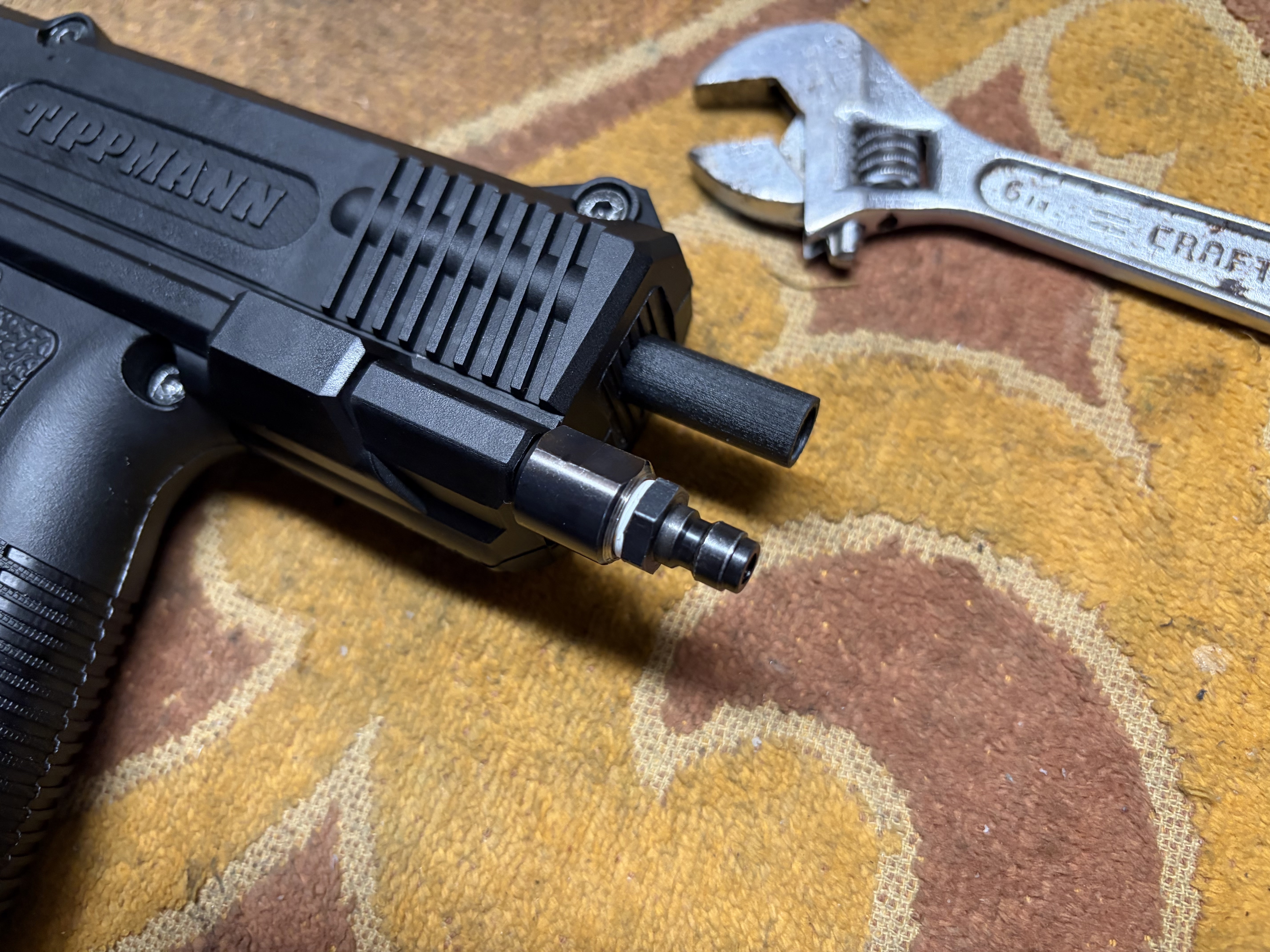

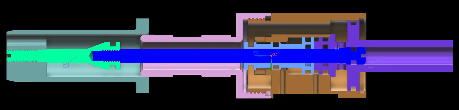

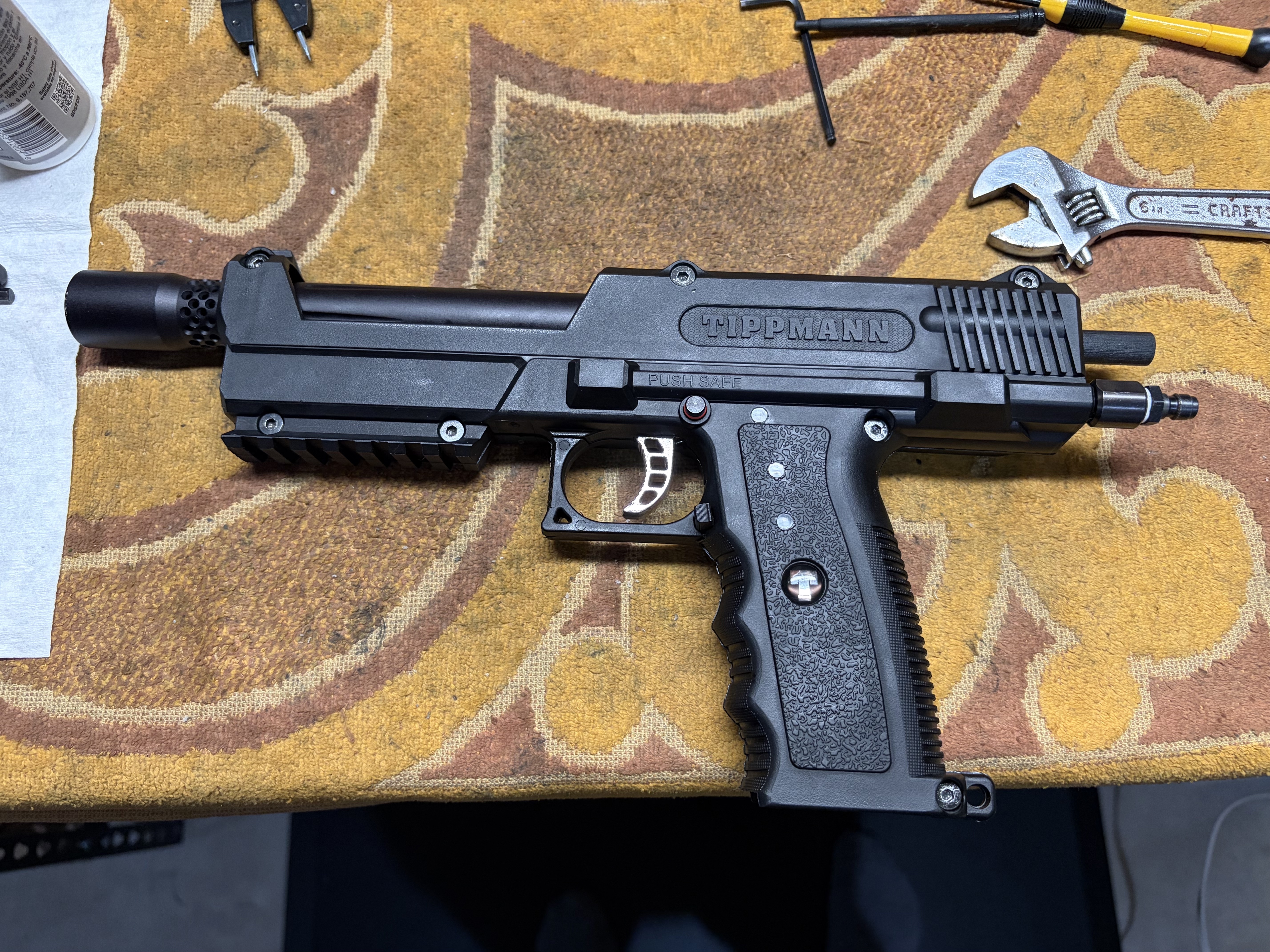

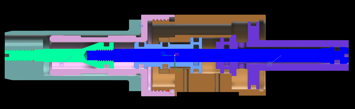

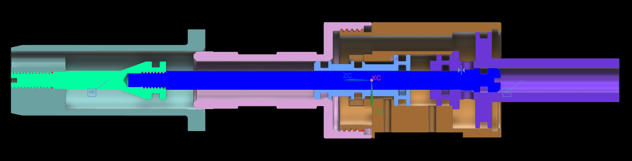

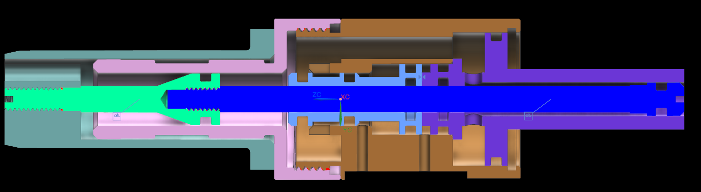

                    I think I'm on to something here - a springless TPX/TiPX that seems like it'll be a lot easier on paint. The con is the purple cylinder sticking out the back of the marker, about the same length as a remote line adapter.
                    3d printed parts provided about 3 dozen shots before failing. The bolt pinches about 1.5x as hard as an Emek, but I can probably make that lighter by changing the oring size on the back of the blue shaft. It was shooting a little bit faster than the same reg setting with the stock internals.
                    I'll post the pics for now and add comments when I have time later. I think it's time to get some parts machined.
                    Edit: Comments and pics of back of marker added.
                    Pic 1: Trigger forward. Air supplied to both channels. Spool pushed forward. Powertube sealed. Bolt back.
                    Pic 2: Trigger pulled. Air vented from rear channel. Spool moves backwards. Powertube opened. Bolt still back (momentarily, transitions forward between 2 and 3).
                    Pic 3. Trigger pulled. Air still vented from rear channel. Spool still back. Powertube still open. Dump chamber air pushes bolt forward with forward force partially cancelled out by oring on back of blue shaft. Marker fires when bolt powertube oring clears tip of powertube.
                    Pic 4. Trigger forward. Air supplied to both channels. Spool moves forward. Powertube sealed. Bolt still forward (momentarily, transitions backward between 4 and 1).
                    Go back to Pic 1 (bolt gets pushed back) and repeat.

                      Some teaser videos. Shaky camera and poor aim at my backstop as I'm trying to take the video myself with an iPhone. My typical camera boys were at cross country and tennis practice.
                      "Balance" (or force bias) is a 010 oring forward and a 008 oring backwards. Very gentle on the forward stroke, releases air near the end of the bolt stroke, and cycles fast enough for a pistol. I'm going to add a 1/64" diameter vent hole (smallest drill I have ready access to) to release trapped air in the powertube when it hits an obstruction. Again, this is similar to how an Automag Level 10 functions - force teeter-totter, vent hole, etc.
                      My previous post was using a 010 oring forward and a 006 backwards, so the bolt was moving forward harder, which is what made the first set of 3d printed parts fail earlier. I got a lot more shots out of this second set of parts before the bolt shoulder broke off from "slamming" into the breech.
                      A couple other minor things to figure out, but good progress.
