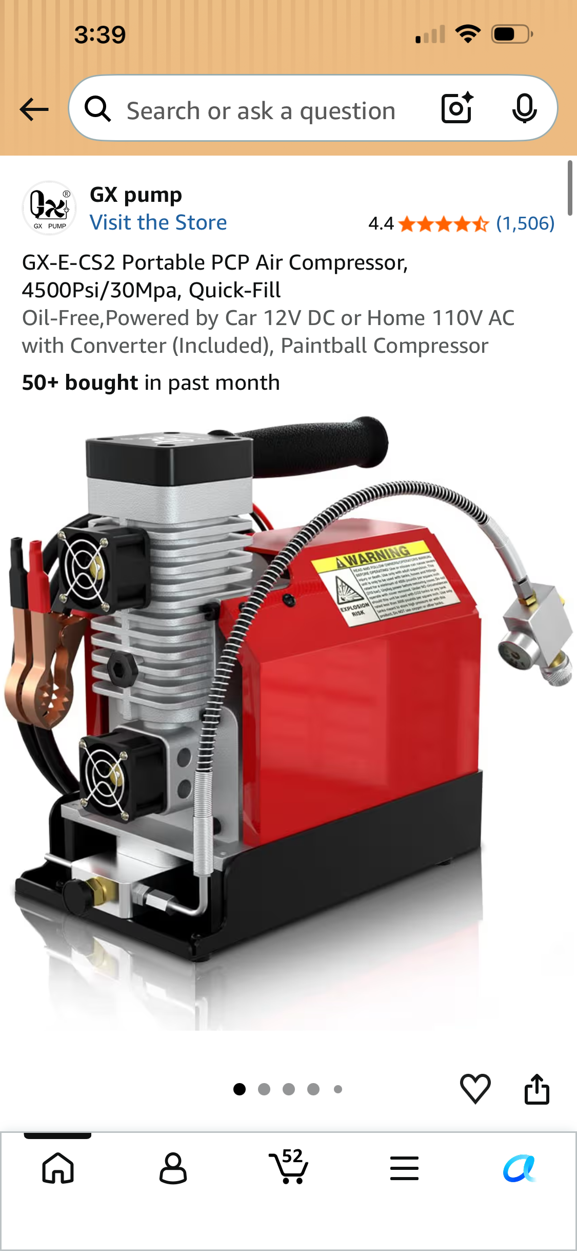

                I see the CS2 seems to be highly recommended among paintballers. Seems better than most. I would imagine with a good filter, you can get some decent results and longevity (granted you’re only filling once per day or less.) the CS2 has a premium all copper motor.
                on the Amazon reviews, there are people who’ve had it for 4+ years (supposedly).
