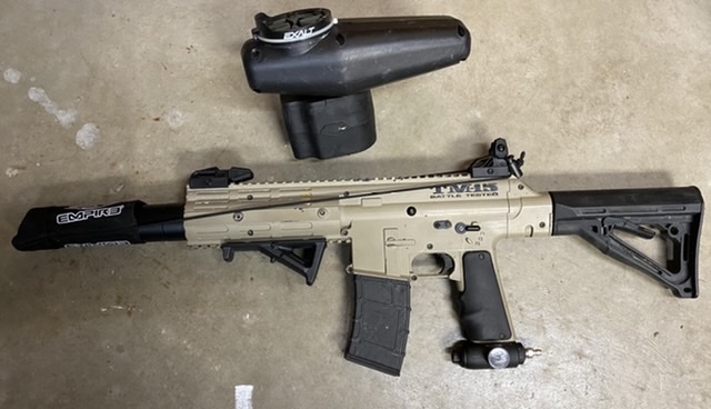

    Someone used to post a guess the price game and things he’d found. To slightly modify it here is: Guess the Issue!
    Today’s pickup is a BT TM-15 complete with Rip Drive. Purchased in non-working condition with was given no clues as to why is does not work. So, post a guess and once I bug and fix it I’ll post the problem. Also, feel free to guess as the price if you’d like.

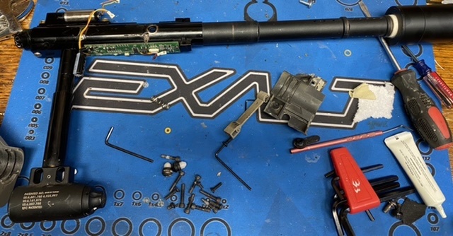

                    Embarrassed to say a I know a thing or two about these pieces of garbage:
                    TM guns need fresh, quality batteries.
                    Noid could be sticking... You’ll encounter this when gun has a ball in the chamber, light is green, pull the trigger and nothing. To get around this, move the select fire to full automatic, ramp the trigger and hold for a few seconds, maybe 5-10 seconds, and the noid will break free and your TM is now shooting. To fix this from never happening take apart the noid clean it thoroughly with something like nail polish remover. Never ever lube the noid, put it back together dry and you should be home free.
                      • 4560
                      Taken apart it really doesn’t look like much. Kind of like a sheep when it’s been shaved. But this looks like a nice platform to drop into something more interesting. I eventually got the barrel off as well.
