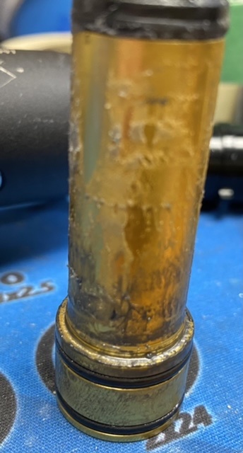

      After my rebuild, the most notable issue was the bolt and how disgusting it was. Thinking all the sludge on it would definitely hamper proper functioning.

        Probably needs greasing... I'm guessing low velocity from a sticky poppet.
        If that is all the problem was, I'd say Jordan was the closest

        Threw in a new battery, after a little fiddling it turned on so I popped on the Rip Clip and used what little air ai had left to shoot about 10 rounds in the dark. So it’s now in full working condition.
        Win is a tie between Jordan and Fubarius. Too much grease on the bolt or some strange mix of oil and grease and battery was funky when I first tried it but after a few tried it turned on just fine.

          Just to be different. . Im willing to bet the bolt spring was in backwards.
          Cuda, if you know anything about axes, minis, or tms, the bolt return spring 8s slightly tapered. The narrow end goes on the bolt and " clicks" onto the bolt.
          If you put it on backwards it binds when you fire.
          Ive gotten a few non working cheap axes or tms that way.
            Cdn_Cuda commented
            I did notice that when I put it back together. One way the spring wouldn’t fit over the bolt, the other way it would.
            I don’t think this guy was the type to take anything apart, so it was likely never cleaned properly. I know the outside has some old paint that was never cleaned off.
