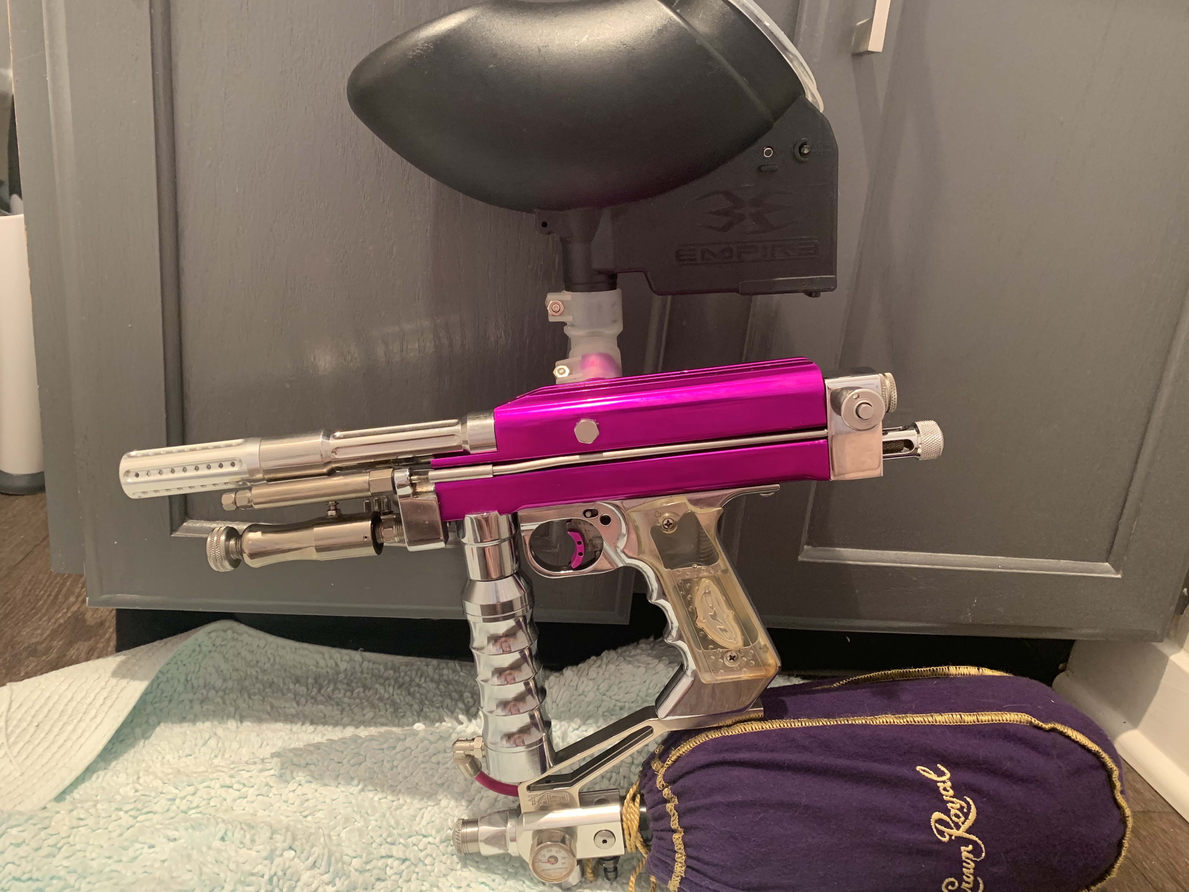

    Yeah. Why didn't centerflag dynaflows take off as the new standard? Mine even as a push button on/off (really a pin but still)! Adjustable output between 200-1000psi who doesn't like a all in one product. :

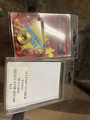

                  I’ll start…..as long as I’m reading that as a bulldog reg
