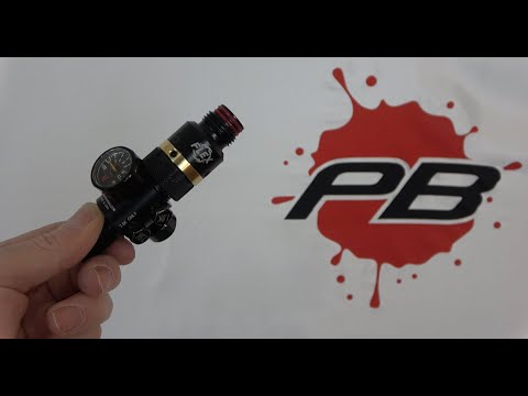

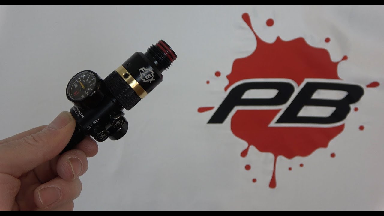

    I have a buddy who always cares about pbx, and is usually on top of the next new thing. He sent me this screen cap from an apparent pbx video hes watching.
    So ninja finally has a fully adjustable tank reg coming out and its the first thing Ive seen worth being excited about in a few years. No more 5 tanks with different reg settings for all your shooters. Simply dial the output pressure up or down depending on the shooter you are using.
    Thoughts?

          I'm definitely getting one so I can use it on my backup tank. This way I can turn it up for an RT, or turn it down for pretty much everything else. I've wanted to do this for a while, but all of the old adjustable bottle regs are just so bulky. This looks to be just an inch or so longer than a typical Ninja reg.

              So... If you were to turn it down, is there any air (at the former, higher pressure) that needs to be purged from the reg? If so, how would you purge/fully knock down that pressure without having to screw it into a marker? That would be an extra step I wouldn't want to deal with. Is there a bleed on it? If you have a LP marker, you bump the tank pressure down and screw it in only to find there's an initial burst of 850psi going to the marker... That wouldn't be good.
              Interesting product, though. We'll see how they sell with that price point.
              New Feedback
                BrickHaus commented
                From what I can tell they just threaded the outside of the reg body and have you a collar that puts more or less pressure on the washer stack. So id guess they dont bleed off unless you shoot em off like you are thinking.

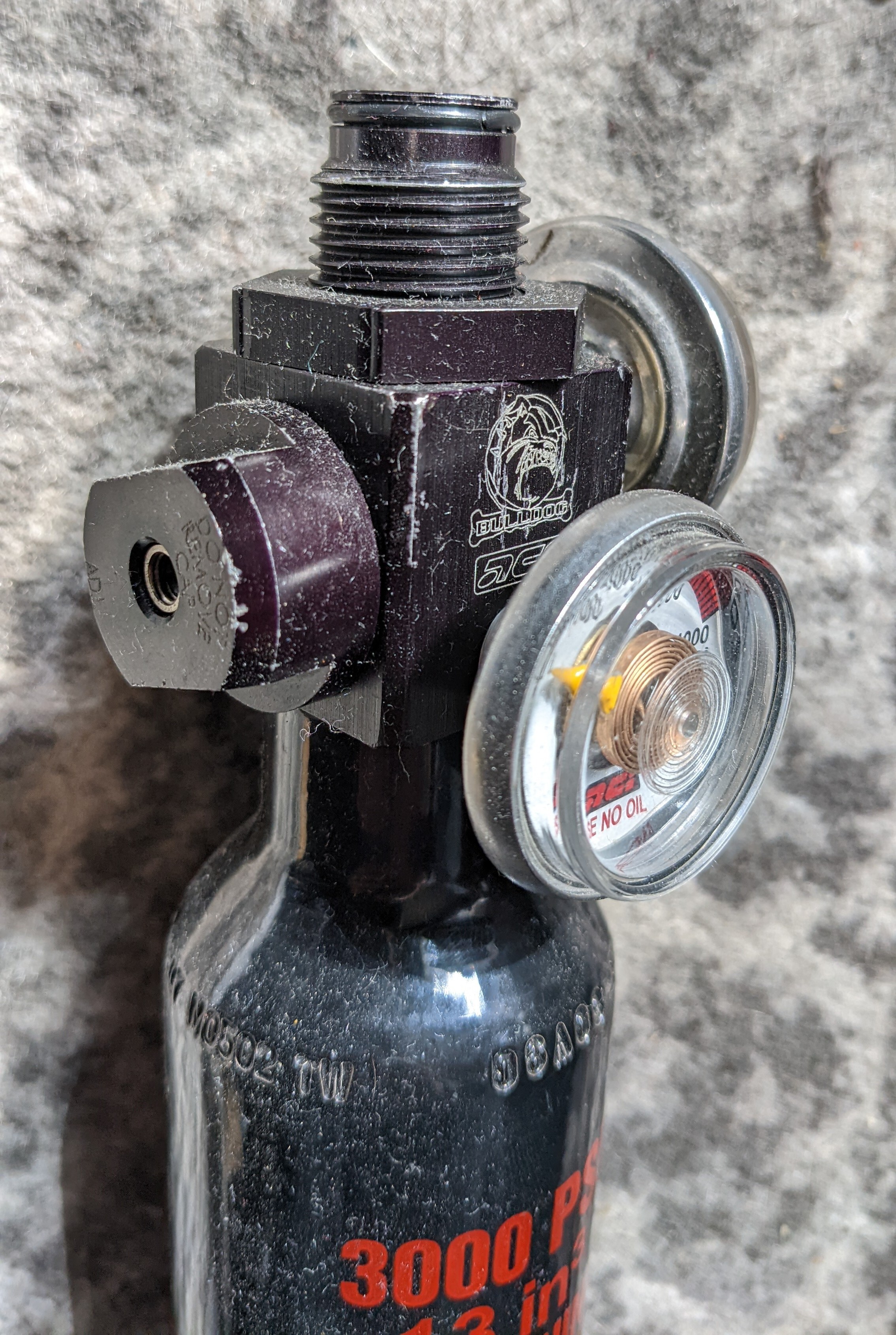

                Nothing new ... It's been done before:
                  BrickHaus commented
                  Well yeah, but how old is that reg?
                  XEMON commented
                  Old enough that it took me 15 years to track one down and I'm having issue making the valve seal 😅
                  Might have to make custom gasket ...

                Now that I look at it again. Man they really added length to the reg to add the adjustability didn't they?
                  BrickHaus commented
                  An inch willl throw some tanks off though. My 77 sl may be too long with an inch added honestly... okay well it probably wouldn't matter, but it just looks gangly when you look at length to width proportions.
                I was gonna say... who's gonna tell em? 😅
