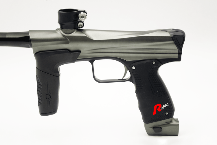

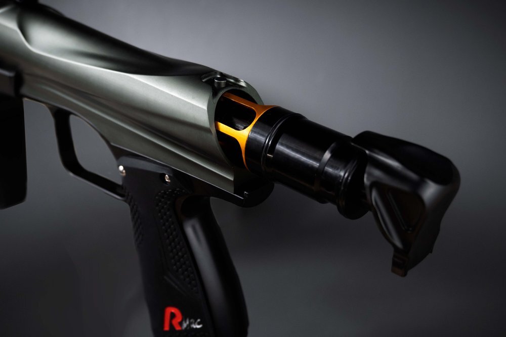

            Orders are open it seems. https://www.flowtechdesigns.com/ I've seen a few be delivered on Facebook.
            TBH, I put an order in today and will post pictures/video when it arrives. It may be a "buy and flip" kind of thing, but I'm curious and willing to support smaller companies. Saw at least one comment on Facebook that it's the same guys who originally worked on the Halo. Texas based.

            Dye's not going to be very happy about that eye pipe...
            • imped4now
              imped4now commented
              Nothing new....
              That's a Machine Vapor pipe, as seen in the 2014/2019 models.

            Ahh yes, eye pipes. The best idea on paper that should have never made it to production. I always loved having to deal with them cracking or leaking paint behind them totally nullifying the point of them. Not being able to dry fire without a barrel in place was also a treat for teching. Not sure why you would possibly add that to a mech gun in place of a more durable material if you wanted to eliminate detent covers.....
            • zinger565
              zinger565 commented
              I believe these are attached to the bolt, so rear inserted and shouldn't shoot out like the Dye.
            • gabe
              gabe commented
              Still just an awful idea. Way over-complicating what is a very simple engineering issue of installing detents in the body.

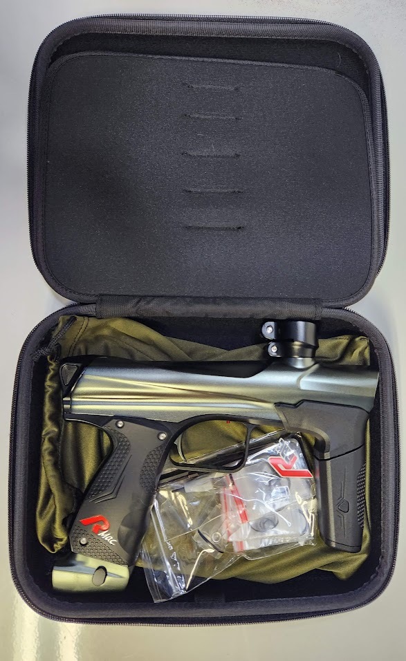

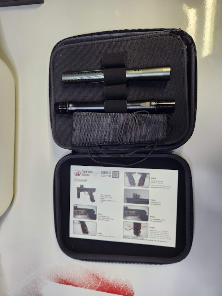

            My RMac came in the mail yesterday. Couple of first impressions just handling it and dry-firing in the basement:
            • Holy crap is this thing light!
            • Nice case, holds the 2 piece barrel, full spares kit (including tools and an extra detent pipe), and marker
            • Very little in the way of a manual, more of a "quick start" guide than anything
            • I hate the on/off. It's extremely hard to push on with a tank installed, and it's really easy to accidentally push it off
            • Bolt train/engine/whatever we're calling it was nicely lubed. It also comes out easily
            • Feedneck is meh. No lever, just a big thumbscrew. Appears to be empire spec, and if that's the case I'll be replacing it.
            • Trigger is extremely light. If it was any bigger I could walk it like an electro
            • Safety is interesting, it doesn't block the trigger but instead appears to hold the spool valve back

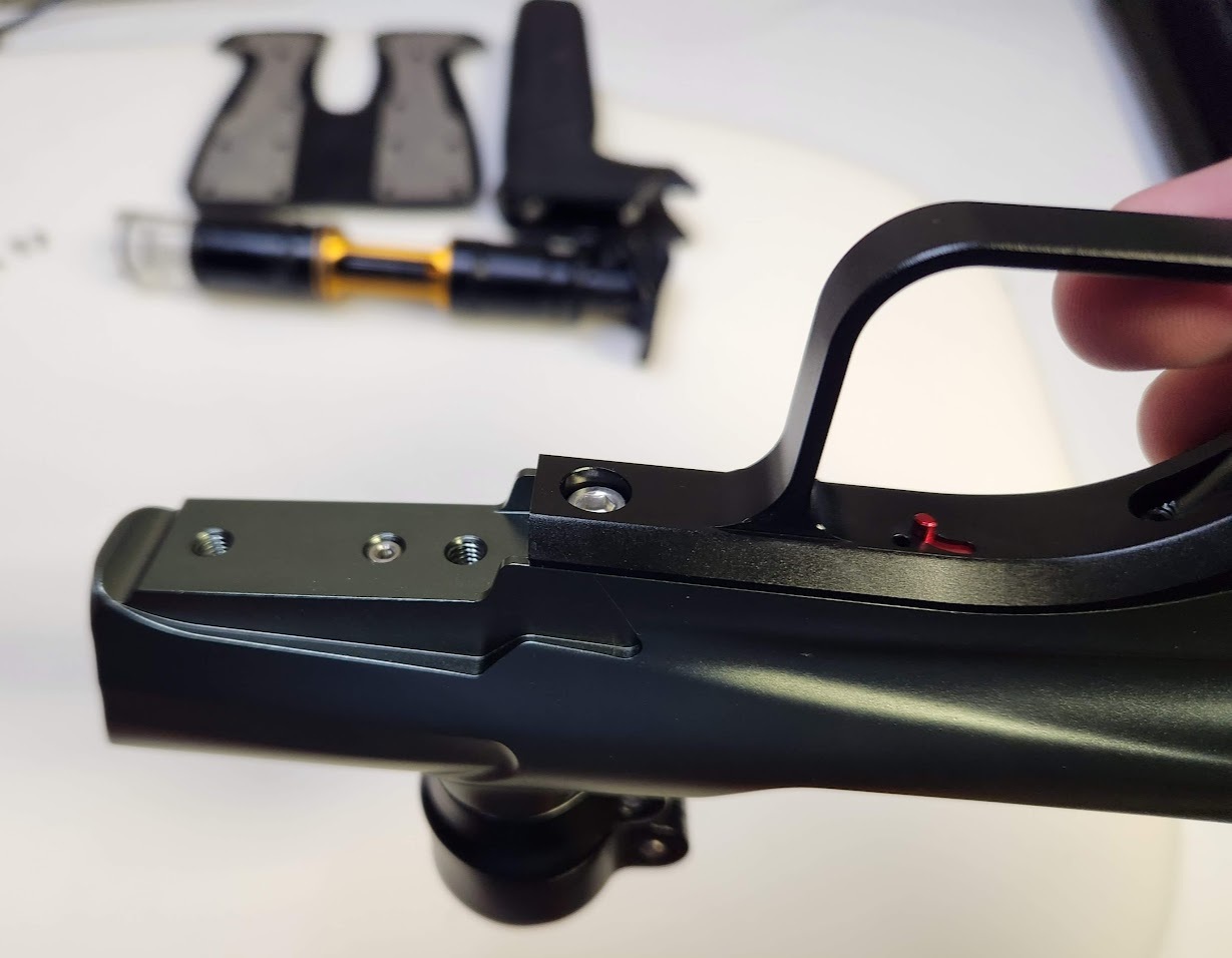

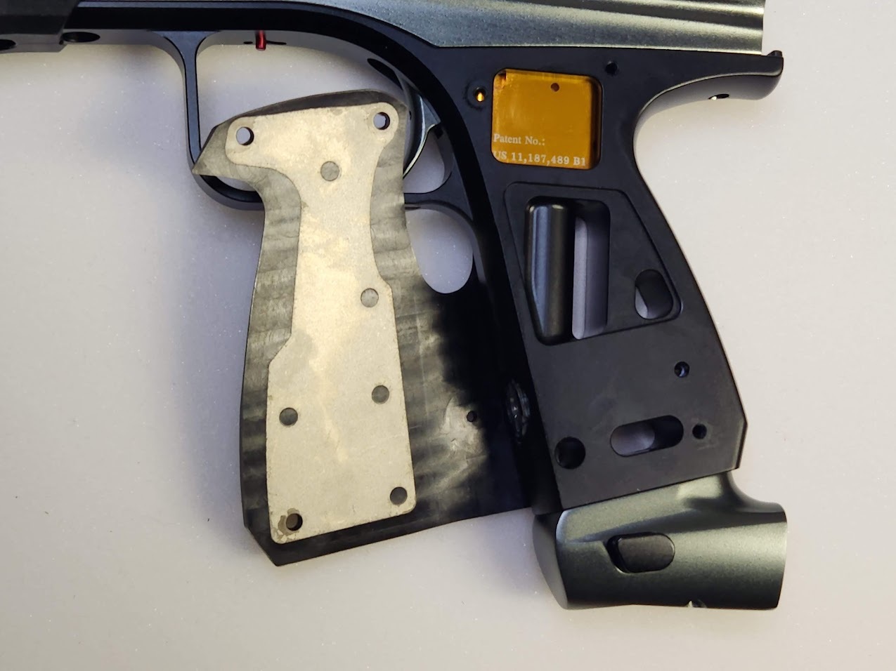

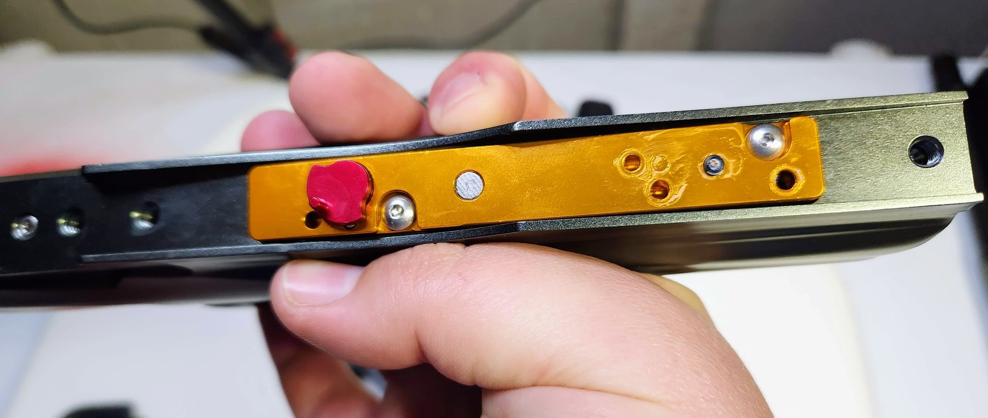

              More photos:
              Click image for larger version  Name:	eiUYTqlPdyZRCXEvDS2PnxGP-glCVkLdJh3rDLMnWJ22YfbwfQ_WONOe-hLWulcrKO8uF8_ytr19IVYaIkkCK-oIMDCtTbJVQPRUMogYUwJIUoxTFZOdbRrFa47k8RD_mP5S2ekGB5-CNlvQ8QZrJAroHjGZjxh-Dxpq9OGYXrTq3Chq4u7xdXV9rySonIp4O8mMV-QBr62QDfEi2PuNouPt6kCWInx1zd2AQC2XmBKOZirCKKwpfEAUmGl8b6x Views:	0 Size:	137.6 KB ID:	329953 Click image for larger version  Name:	GwcRk1hvkSsST-JCW9ql0TzS3Ki6BjtEb9NozGKbQyfQ4_BB7r65bnyUP9cDcn1t_h6bHGo8uMYMVesOwp-ZoMV0-TI7qqc5CM91_EdTNGAyhzCUXyGBEGLSoqJyll46hlKnLX9oB49uSnr4AISCqCZVuxPSAGLN6Qh74Dpx7sq9v5IwFgbloFdhS1n5hj0dp_oLCexAcEddQKnCoKL70EsmU6HYsoMebGc_4r9h9xjnIj4ppLJjUOsezSKf7AJ Views:	0 Size:	183.3 KB ID:	329954
              Click image for larger version  Name:	a2iarjBWUJfRQ_TQWxLnhSUbZ1uE0Wwu3VO_uYZhgtQN-0VUjRu9AGm7G7XPppd1Ixta2gS-EjN_UgEMzioOUmPh5_9eq_02GMx87-_0SFhgVQ6UBzpZLrH4MpDuzAiPaDdm9-YZPC2Z8eYjD2P2P8AHCFqTN4dsbH3OnCNpGFZ8yb4wVgH03hRzBtsZgzmyyZrF1WUaTMIdrdX38dBLDN3klq4l_rWLXRGRrL3qDLSB0u23g6bWTrr9uL-9XIV Views:	0 Size:	150.9 KB ID:	329955Click image for larger version  Name:	vjVo-ioXlhApzrHyTG6W_dyMdKwAqKul5yHSKp2w7WqOGYLU_K_Cm7hwxbXsfWUI3ed1NV30--xQkhofNUQ-xmKi8D2jKONuu7X5T8NJLRkqxQRhVQKP5SfHSpNx-N9v2fhM9Twadsr_bIgwE4J2wVaTVa7rnSZPVHXjGjvRi38lxyT-XIIJCG4eH8isopfB9pD7vpNIgq1ZdE8fSkLCNw4UqvTJp-rFdhJx90VfyEYOnrlc84NGS15MyYB-I7H Views:	0 Size:	131.8 KB ID:	329956Click image for larger version  Name:	Jsa5Fumj6tHgtG1bUZ54NyZUHZ4zYBwjhxeYqVPzwe-e1SxSUGZqpY1nxfjowNhfhEsjdkM8lBwVOKZLePke3ed4h7dbakAASWmfe5Qq4oCAJKLIAA4-lFknyq9sTImELtLJMzJj71lxp5R-MruiGYDZOdt-Kc53SHBrzTfzyPt43tBkuaLuB3PFcNq3bF2k0NOgwvaQHEi-S3aGP_j19uKaO9O02CPxDWjFTOqHLNCl7HsoK3zh2JEG6MzwD63 Views:	0 Size:	269.7 KB ID:	329957
              Link to patent on the trigger valve: https://patents.google.com/patent/US...2c187%2c489+B1
              Looks like Mr Spurlock is involved.
