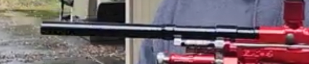

    MasterSconi Freak Insert Ready "Epsilon" Barrel
    teased in new DocFire video
    The old DAC/Bob Long Longshot/Delta barrels are my absolute favorite. Cool to see this.
    Basically a copy of the styling/porting.
    Hopefully will be available in 12,14, and 16"

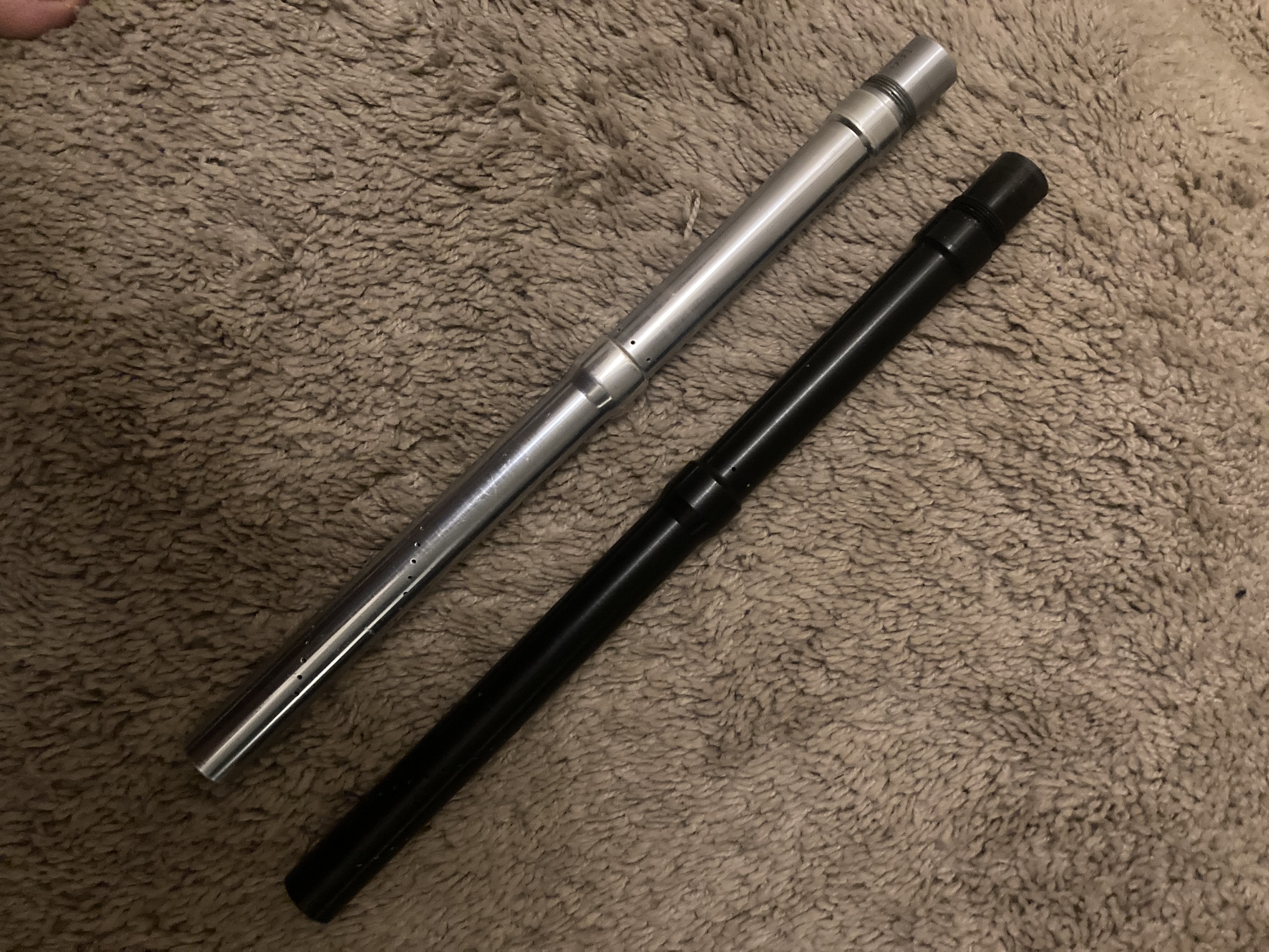

    Heres a another screengrab w comparison to two of my 14" Longshots.
    Looks like the Sconi has the middle step/ring? with the same taper towards the barrel tip but the rear one is longer and not all the way touching the body. The original barrels used these for mounting the pnuematics shroud so i guess these are just for looks. Also, cant quite make out the porting, it looks like it might be straight rows? The Longshots have spiral porting at the ends and a few holes past the middle ring.

      ok, so it looks like the Sconi barrels have the spiral porting

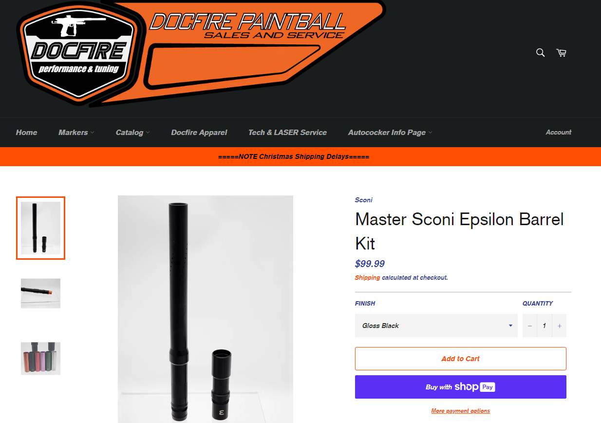

              ​Barrel Back Freak XL Ready cocker threaded – Docfire Paintball​
