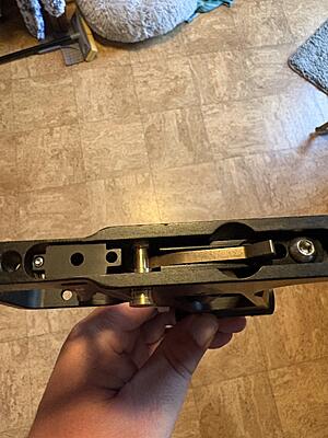

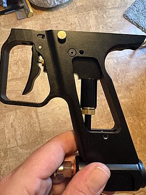

                Ripped her dress off so you could see the goods
                It should be noted that the trigger doesn’t seem to physically actuate the sear, it’s all pneumatic
                Also looking at this… I’m eventually expecting a Nova cocker with a macroless frame. The bones are there and there is a ton of extra space leftover.
                • timetopat
                  timetopat commented
                  Ooh thanks for the pictures! When i tried it at ION it did feel completely pneumatic but its good to know how it actually works. Id love for them to bring back those macroless frames.
                https://youtube.com/shorts/e680WmUra...f_GvDvc2Fgn-_e
                • StaticShocked
                  StaticShocked commented
                  Thanks for posting the video and pictures with the grips off. That explains so much about it's function. Seems really neat and has a lot of promise!
                  Is the timing rod activated by the trigger, or pneumatically activated via a connection to the sear (like on Trilogy SF frames)?
                  I can haz feedback?
                  • MullerTime
                    MullerTime commented
                    The timing rod is actuated by the trigger like usual. The sear and trigger return are pneumatically actuated.
