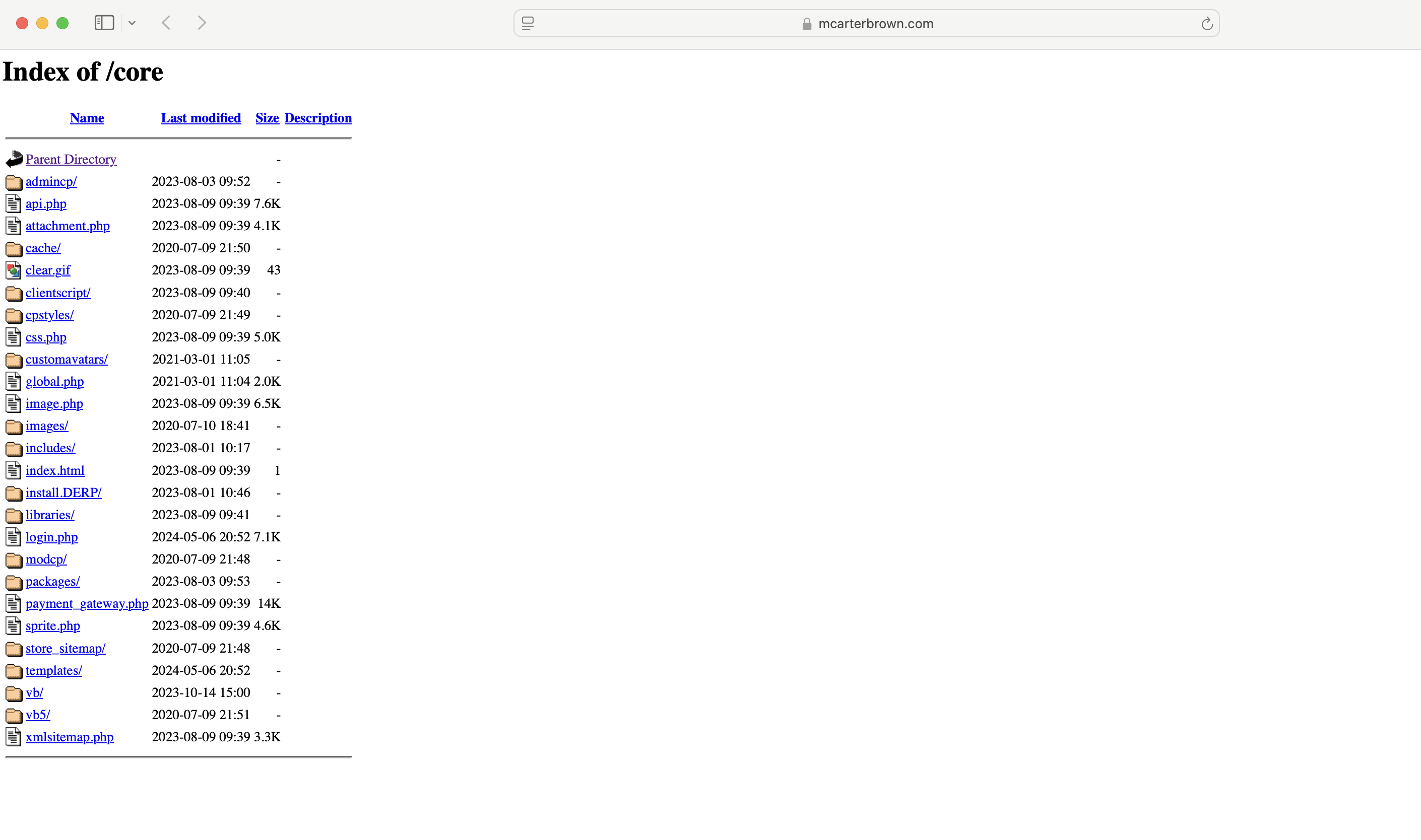

    Painthappy can you help me get back into the notifications, PM area?​
    when I click on your name it brings me to the core files.
