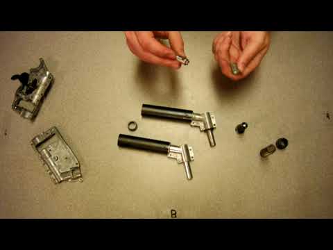

            Can confirm that these do fit the 11 Joule HDR50/TR50, as initially expected. I purchased an 11J valve assembly from MCS just to confirm. The following is what the 11J valve looks like. It has a "C" shaped devolumizer, that must be removed to install the velocity adjuster. There is also a threaded in flat disk with a tiny hole that acts as the dump chamber fill restriction. This should probably also be removed.

                  Crappy installation video acquired!
                  First, I'd like to apologize. The potato I used to shoot this video got so hot that it baked itself, and started losing focus near the end of the video. This video is a cure for insomnia, disguised as a video for installing a velocity adjuster into a Umarex HDR50/TR50.

                    Installed 1 of 2 kits this weekend.
                    First off, thank you for the photos and video, it made figuring out where all the springs go a lot less frustrating.
                    everything went well, and though I have not adjusted it with a chrono, so far it is leak free and cycles normal. All parts are quality, maybe too quality for this pot metal pistol.
                    Lessons I learned:
                    -Use a nice pin spanner to remove the soft brass rear valve cap.
                    -Use tape or zip ties to keep the trigger/sear/linkage secured while you dick with the valve to avoid having to look up the photo of the springs…
                    - Test fire prior to complete reassembly (noted in video) to avoid frustration.
                    - Map out all the screws (3 sizes and 2 threads)
                    - Be sure to thank those who do the leg work so we can all have cool shit.
                    THANK YOU!
