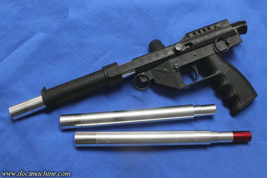

    Thanks to the unusual request of a clearly badly deranged MCB'er who so foolishly loaned me a rare and valuable Tigershark, I can now offer to the community at large a limited number of barrels that take Freak XL inserts!
    They're left plain to match the original barrel, and take any 8" Freak insert. I only have five on hand, though I could make more if I've underestimated the local nutball contingent.
    Asking $70, shipped (US only)

    Yes, the plain bare aluminum is the correct color for these.

      I could have made a 5" back, but then I'd have needed to make a 6" tip- and if you went to remove the barrel, chances are the tip would unscrew, and you'd have to pull the pump off to remove the rest.

              Hey Doc could these be anodized without affecting the bore? Raw alumininininium makes me itchy
              • DocsMachine
                DocsMachine commented
                Yessir! These are the same "Bull" backs I make for 'Cockers and Bushmasters. Anodize away!

                If memory serves... these are very similar to classic Sterling?

                  -I sold the last two on eBay, and surprisingly quickly. I'm in the middle of running an F-bomb-ton of fresh Freak backs, and plan to do another half dozen or so.
                  -Dunno. I don't have a Sterling to measure, nor the specs to compare. Sterling barrels are generally 7/8", though, and the 'Shark barrels are 1".
                  We need to compile a thread of threads, with drawings of barrels.​
                  -I still have my now-wildly-out-of-date Barrel Thread ID Guide that I keep meaning to update, and add basic specs to. I have a lot of those drawn up as dimensioned prints, although my numbers are reverse-engineered, rather than 'from the factory'.

                    If you wanna make any Sterling barrels, just email me for thread specs. My next one, I'm gonna measure over wires at MMC against the one body I currently have. 7/8-14 with a 2.125" overall insertion length but I think the threads need to be 1A.
