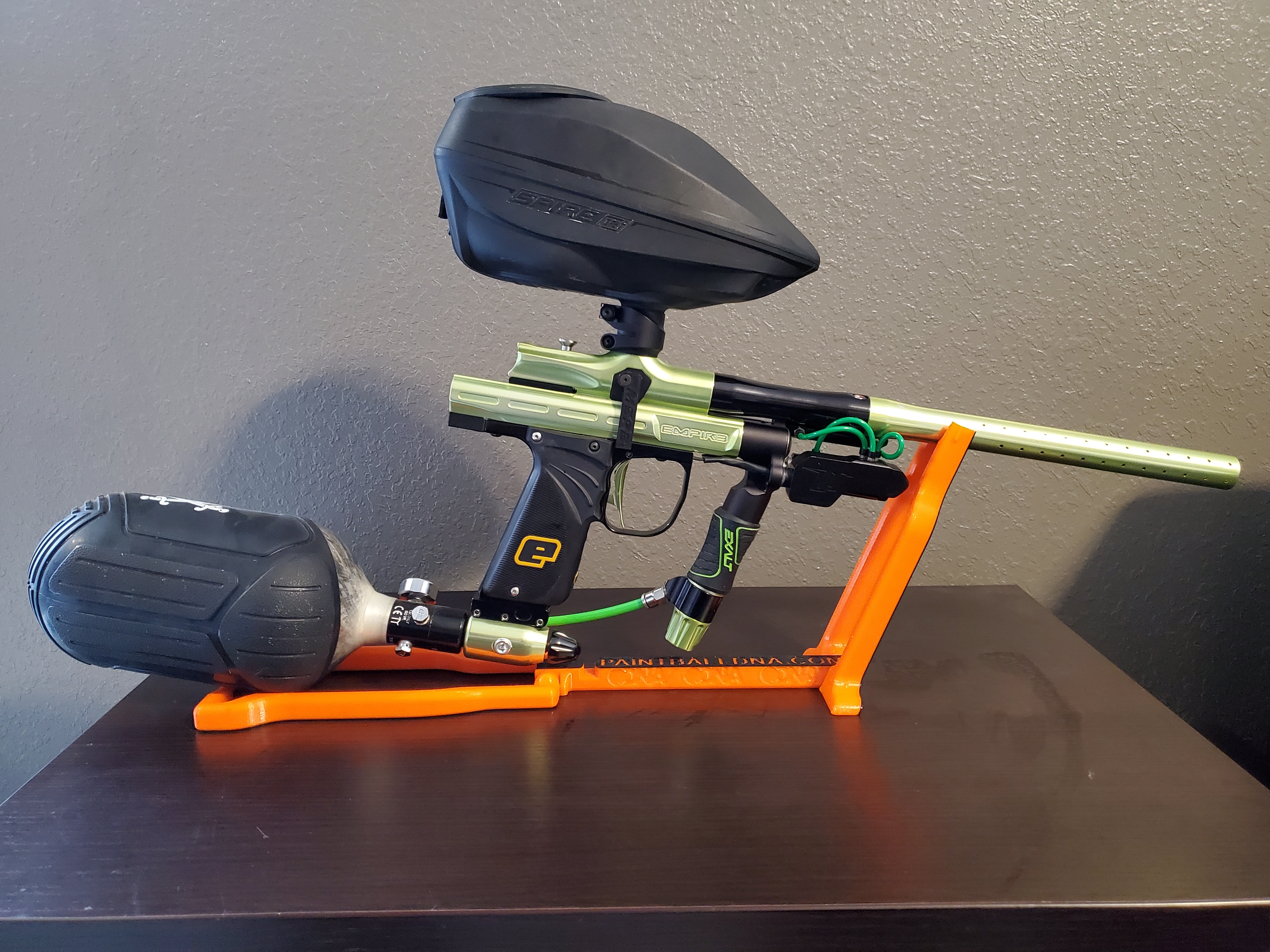

            Originally posted by Ghille-Man
            id be happy to help! let me know if you have any questions.
            We need pictures of this "e-rection" cocker
            • Ghille-Man
              • May 2021
              • 88
              Here she is 😎
