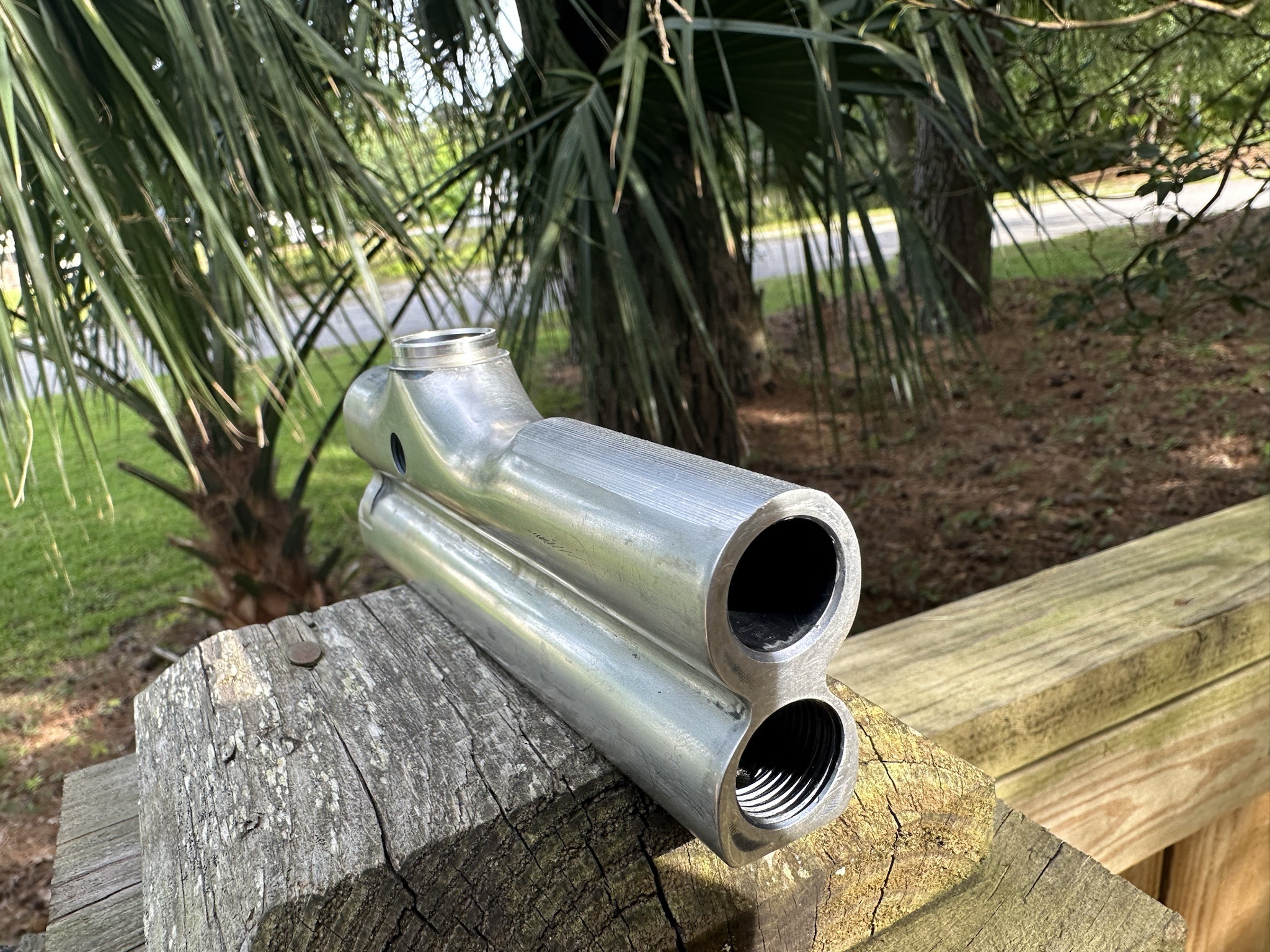

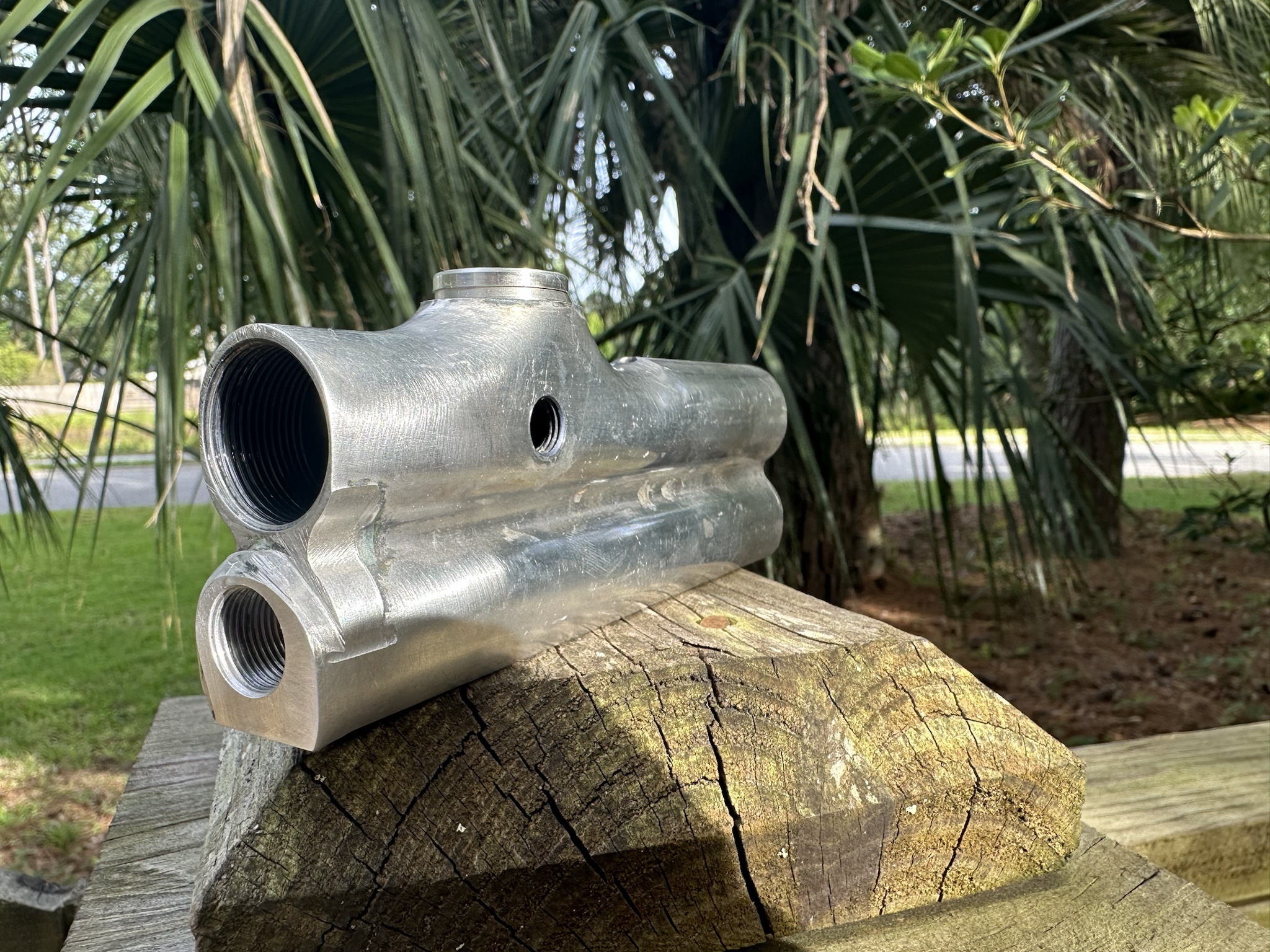

          Finally got some more time on the mill.
          Feedneck modded
          minied
          banjo bored, thread milled, chamfered
          bottom cut flush with the body
          site rail removed and rounded
          ram mount removed.
          Still trying to dial in the profile for the ram mount but this came out pretty solid for the small amount of machine work I have actually done from scratch.

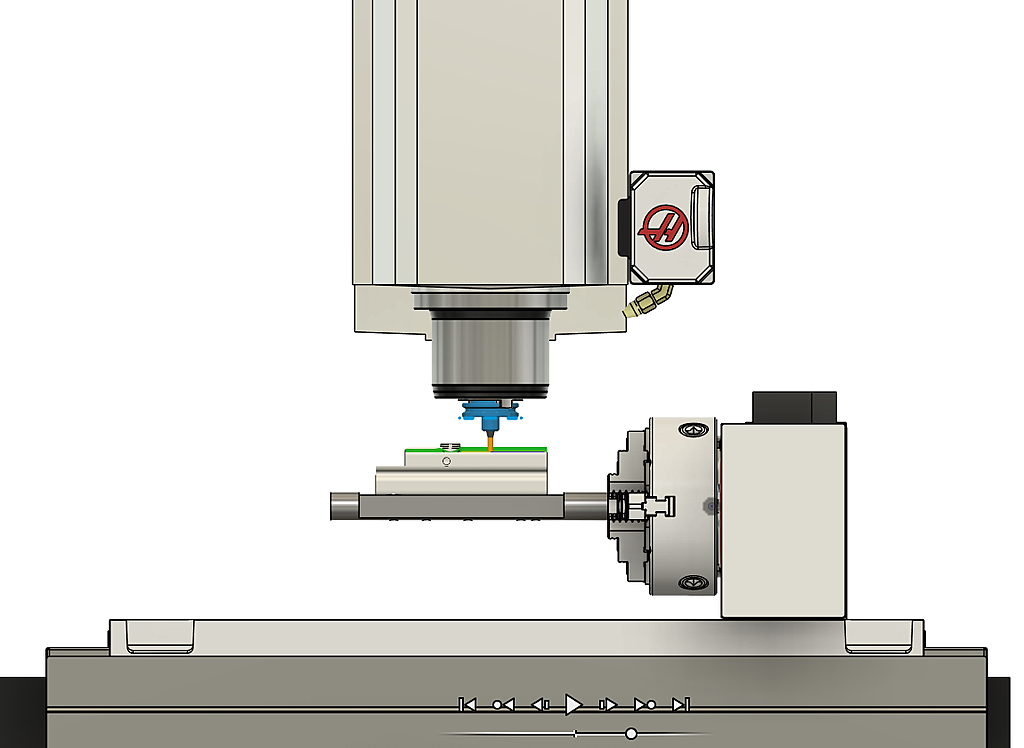

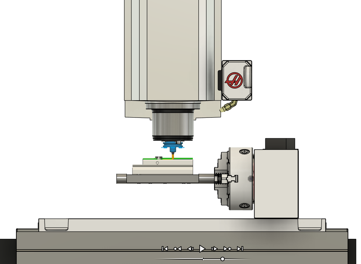

          Well boys minor update. I was finally able to figure out my issues with the machine simulation. This should help protect some from user error.
          Now to figure out if the stock i have in the garage is big enough to make this fixture and to dial in the tool lengths to avoid crashing.
          While i know this seems minor, it has taken me at least a month of fiddling with. Click image for larger version  Name:	image.png Views:	0 Size:	91.2 KB ID:	555154
          BW Youtube
          BW Ebay
          BW Email
          • FredMnkyDad10
            FredMnkyDad10 commented
            Best of luck. Doing some cool milling work.
          • DocsMachine
            DocsMachine commented
            Be sure to use the tailstock on the outer end of that fixture bar. You'll of course have to center-drill it, but it'll had a good deal of rigidity to the setup, and significantly reduce the chance of chatter.
            Doc.
          • superman
            superman commented
            Yep I have one and plan too. Need to figure out how to get that in and working with the 4th too.

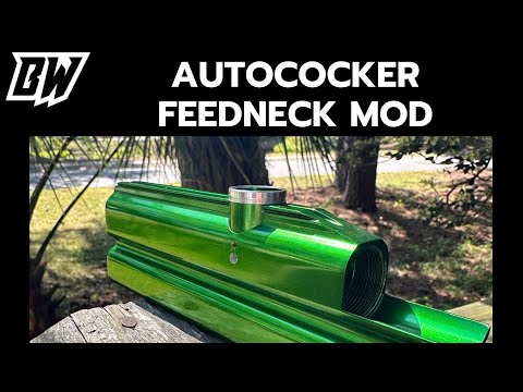

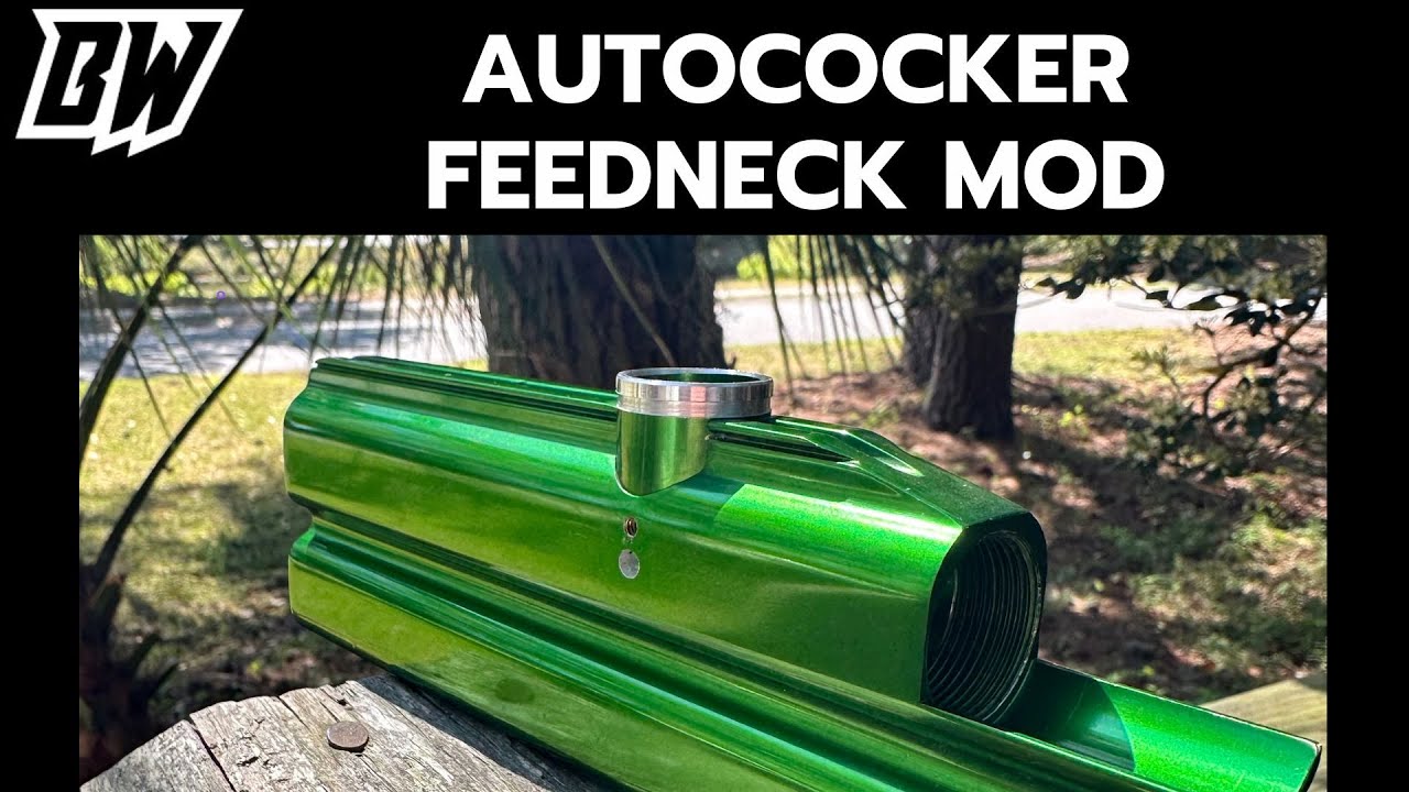

            Another feedneck mod.
