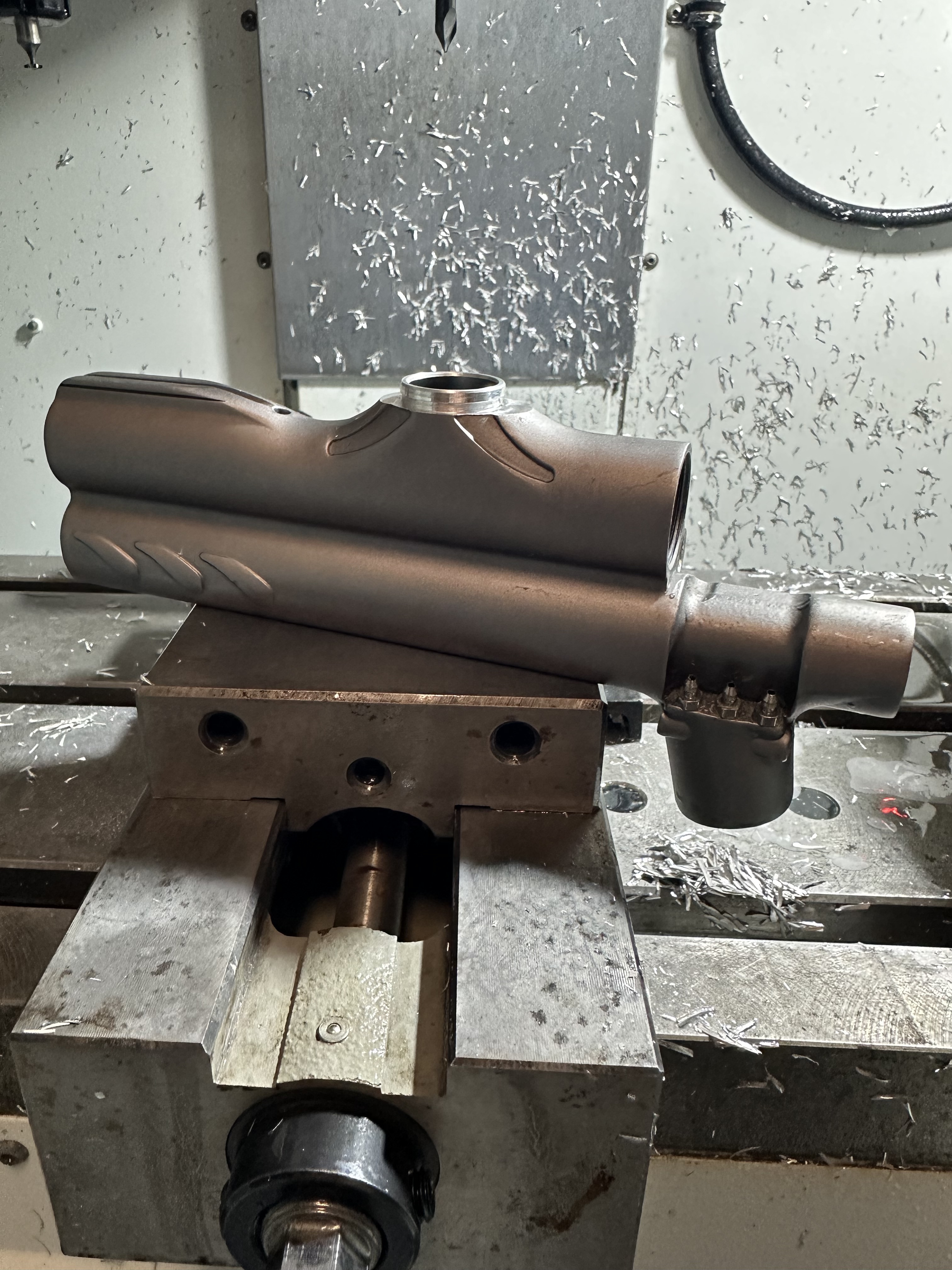

      I spent some time this weekend dialing in a few things on a trilogy body for a customer. Feedneck mod, Minied, Ram mount removed, bottom cut to match the Inception mini front block.
      I will bring the feedneck cut a little lower on the next one to get rid of that lip, but other than that this one turned out pretty solid.

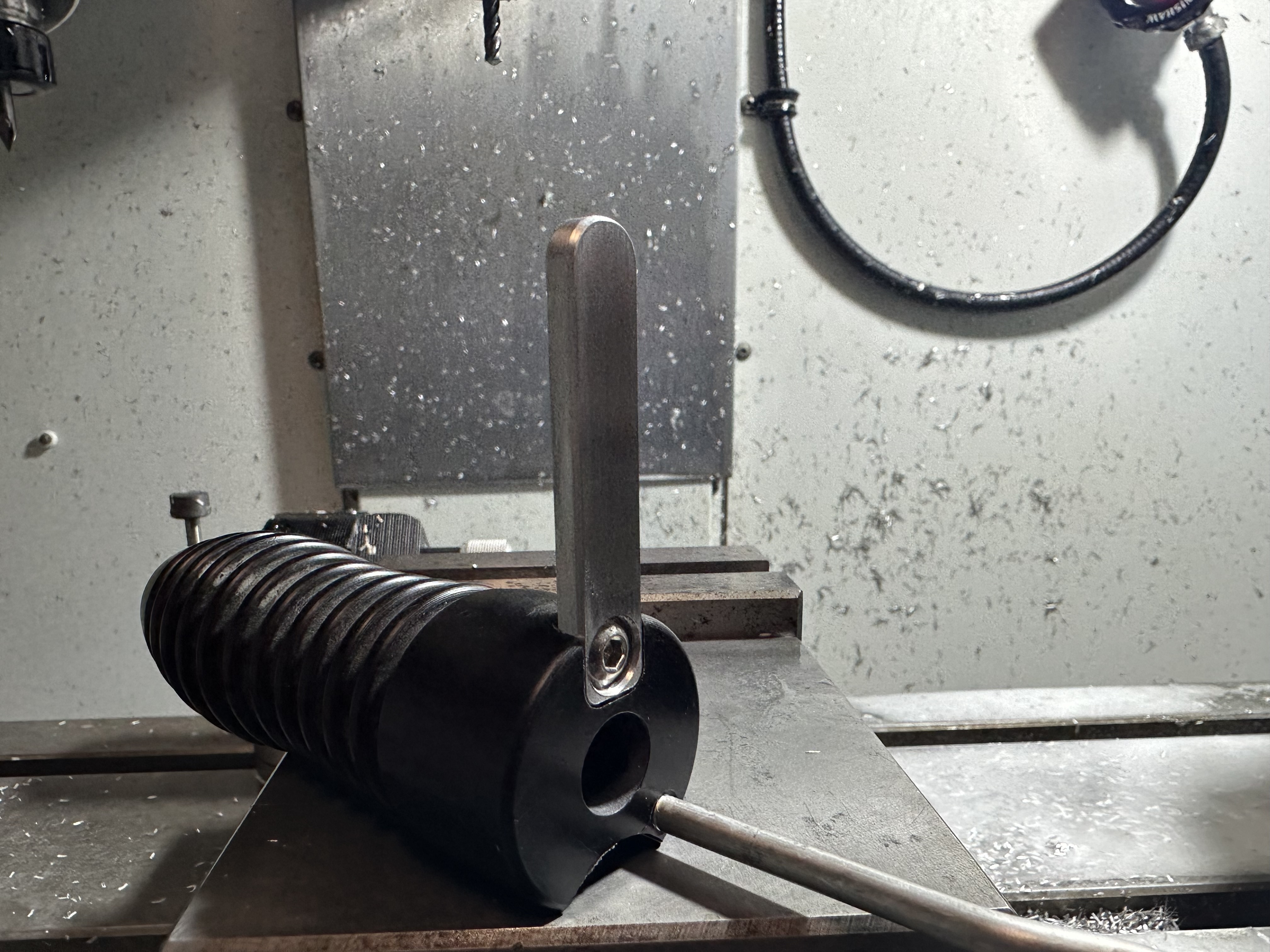

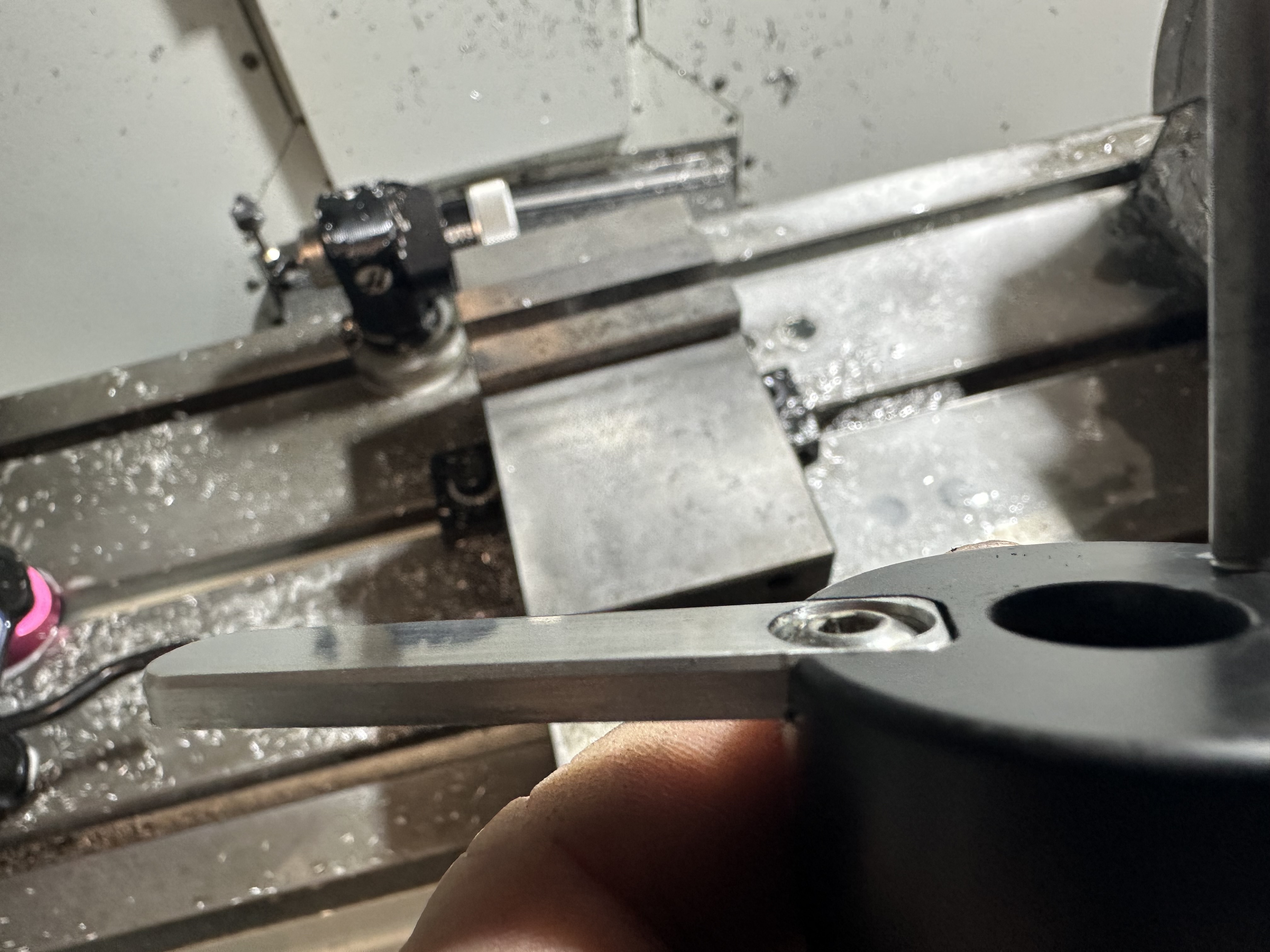

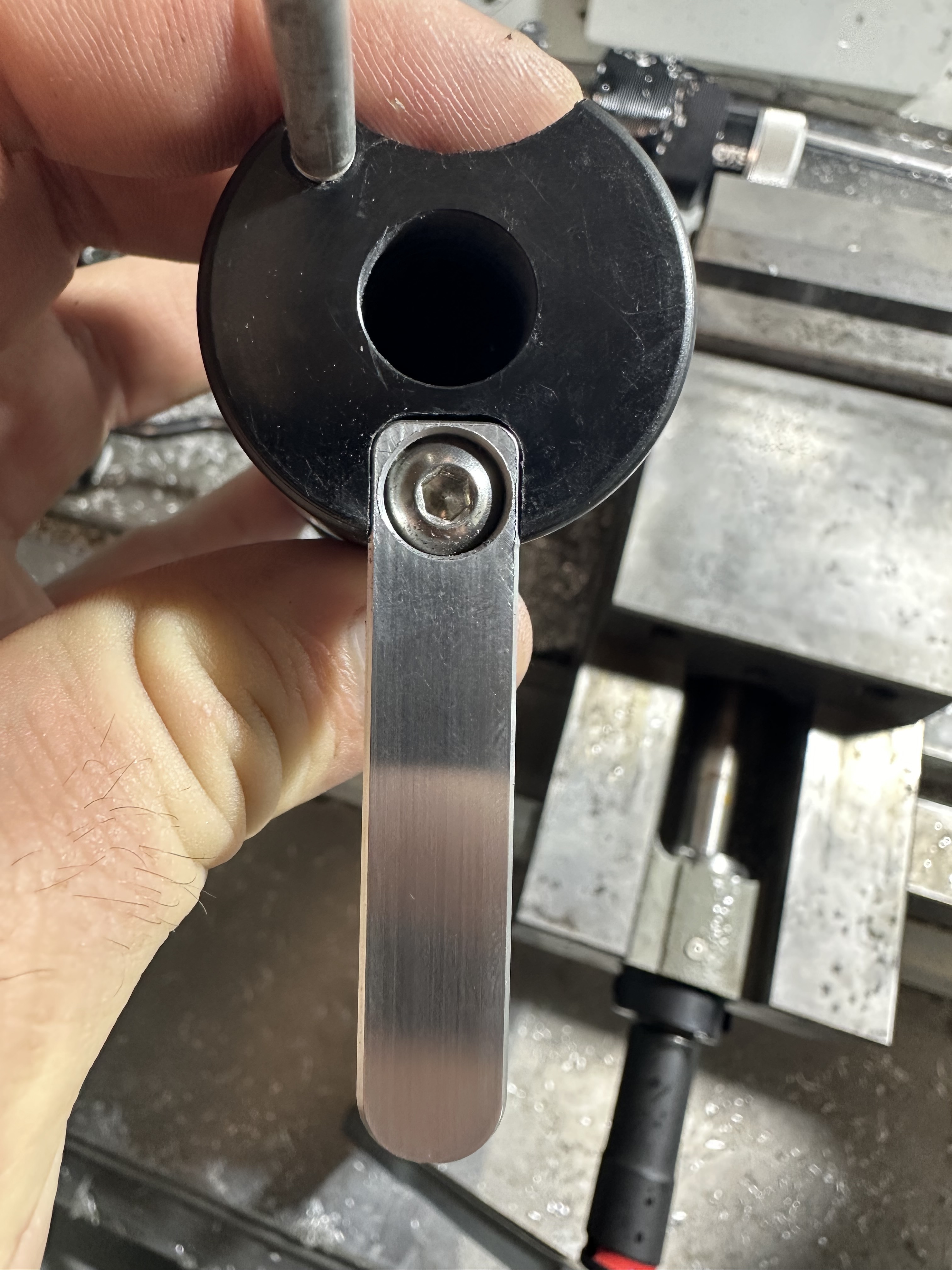

                Dad's birthday today. Spent a little time working on his project last night. Here are all the pieces machined for one of assemblies. Will post a final pic once it gets welded and put together.
                BW Youtube
                BW Ebay

                • Grendel
                  Grendel commented
                  That looks pretty heavy duty
                • DocsMachine
                  DocsMachine commented
                  Fanciest paper towel holder I ever saw!

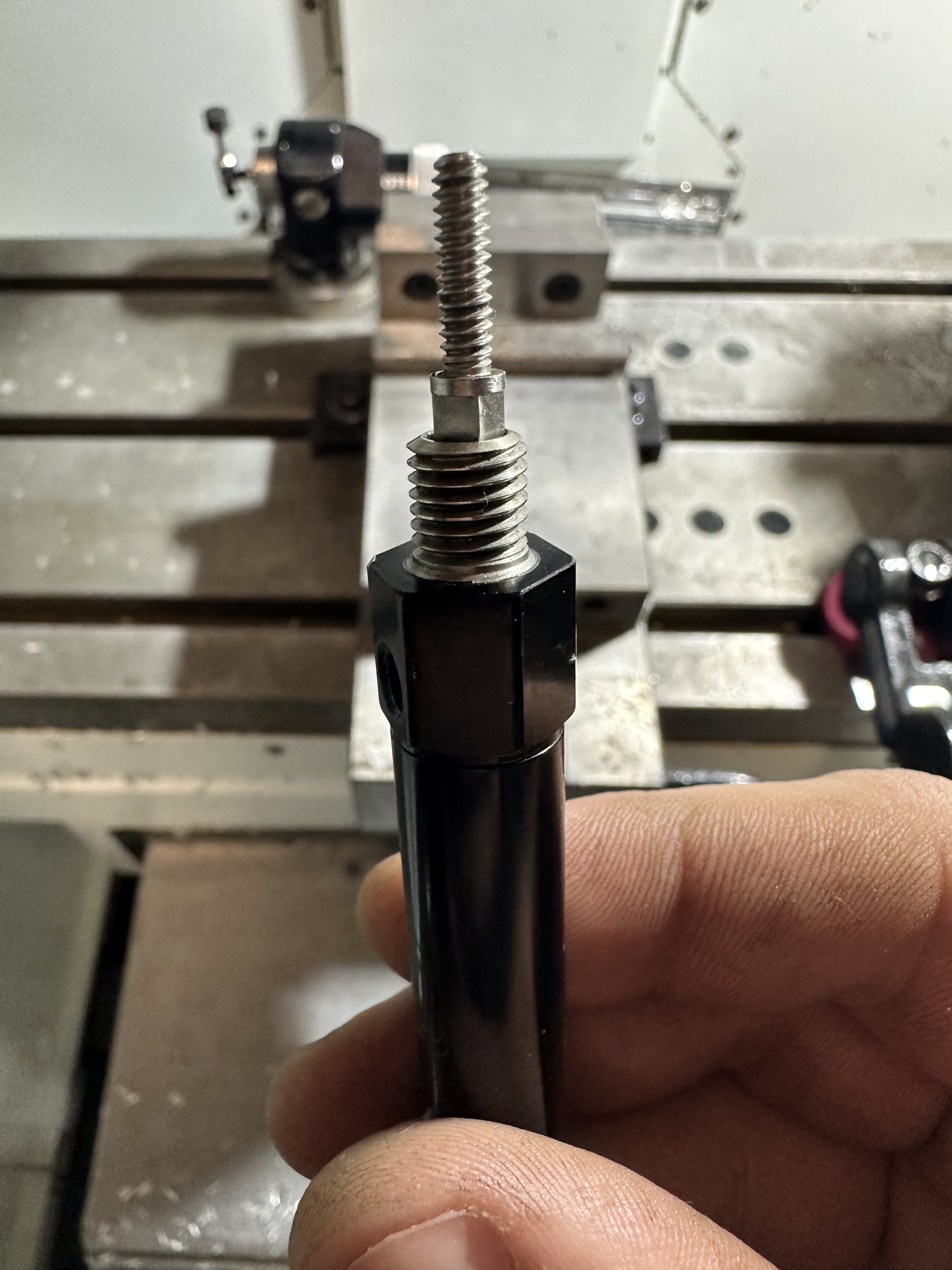

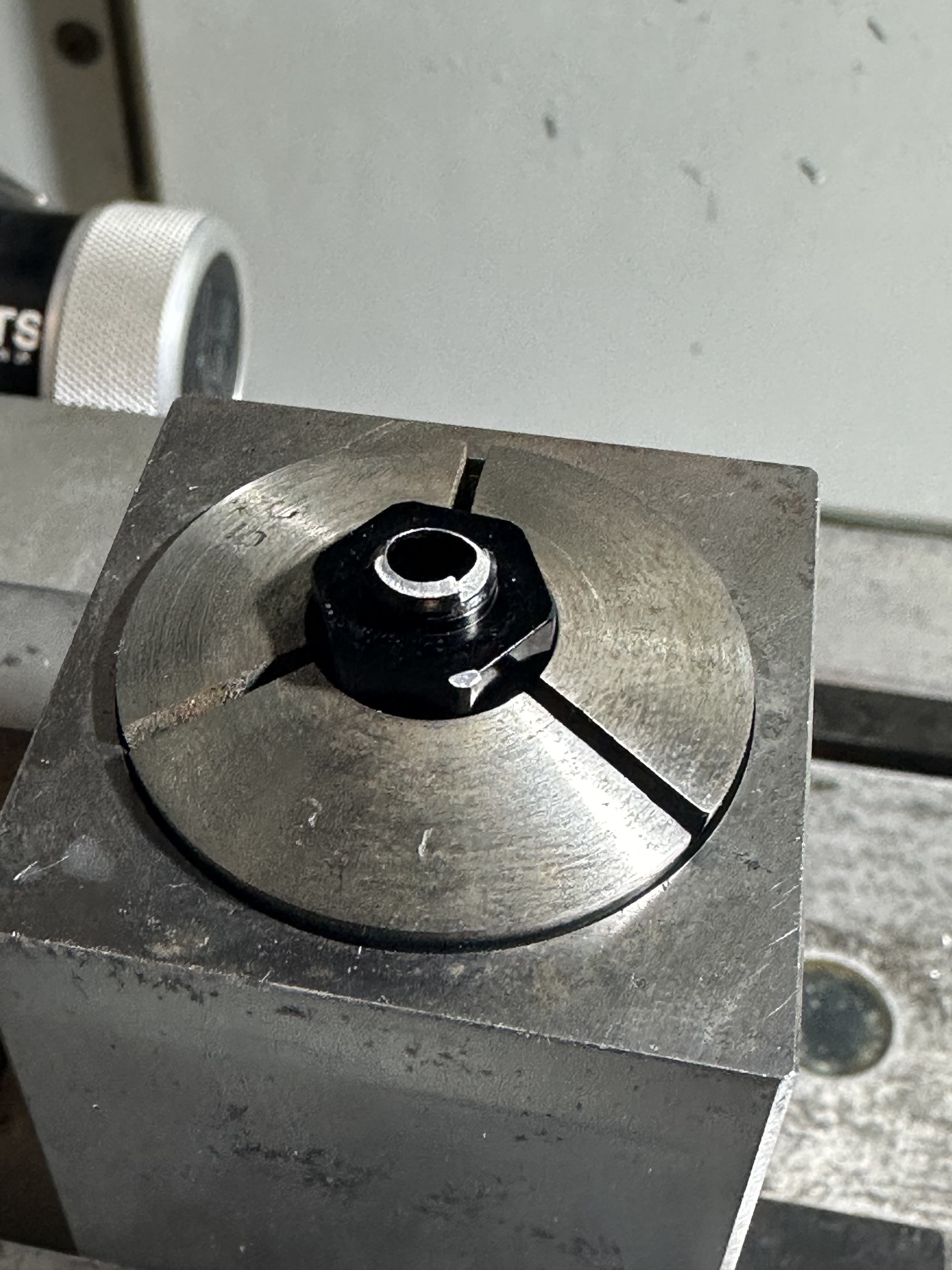

                Not that long ago Angry Antle did a thread repair modification to a belsales evo ram that had damaged threads. I decided to do my own spin on that.
                I had a broken inception ram I was waiting to get to with all of my other projects…. Anyway.
                I bored the back of the inception ram to until it just broke through the oring groove. Then thread milled it for 3/8 - 36 ( I think that was the right size). Checked to make sure it threaded in like it should and then modified the shocktech threaded portion.
                The shocktech part needed to be drilled through to match the larger inception shaft. Front needed to be cut back to match the depth from the back of the ram to the oring groove. Threads chamfered to allow it to sit flush against the oring wall. Lastly chamfer front and back of the bored hole to remove the sharp edges.
                pretty happy with how this one turned out

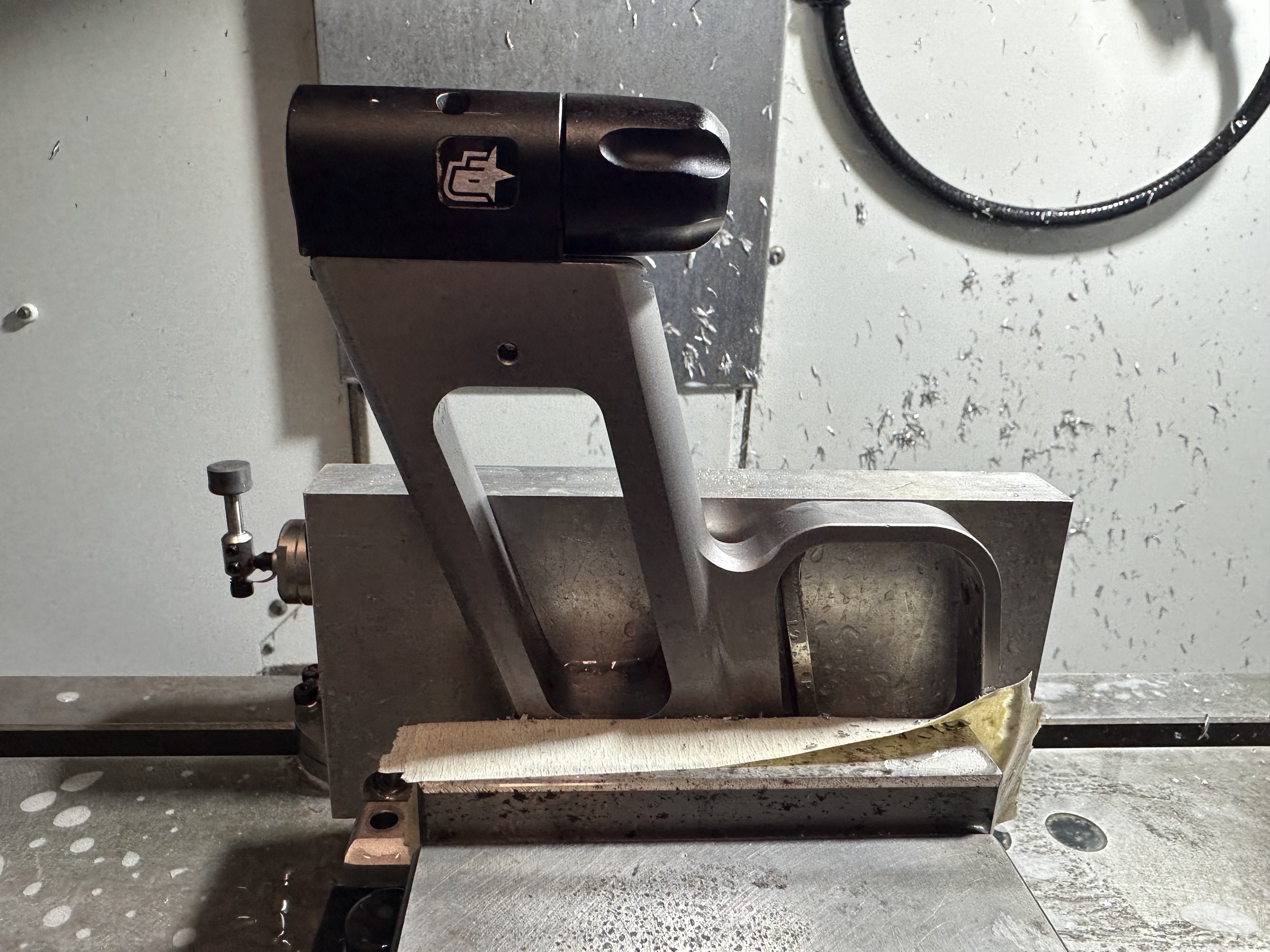

                        #133
                        Ended up spending too much time on this, but it turned out nice overall. SM1 hitman plate

                          Had to be for a customer since I know you are not a "Hitman Mod" player
                        • superman
                          superman commented
                          That’s the truth. Haha but at least I know I can get it done if needed. I would probably change some things if I did it again.
