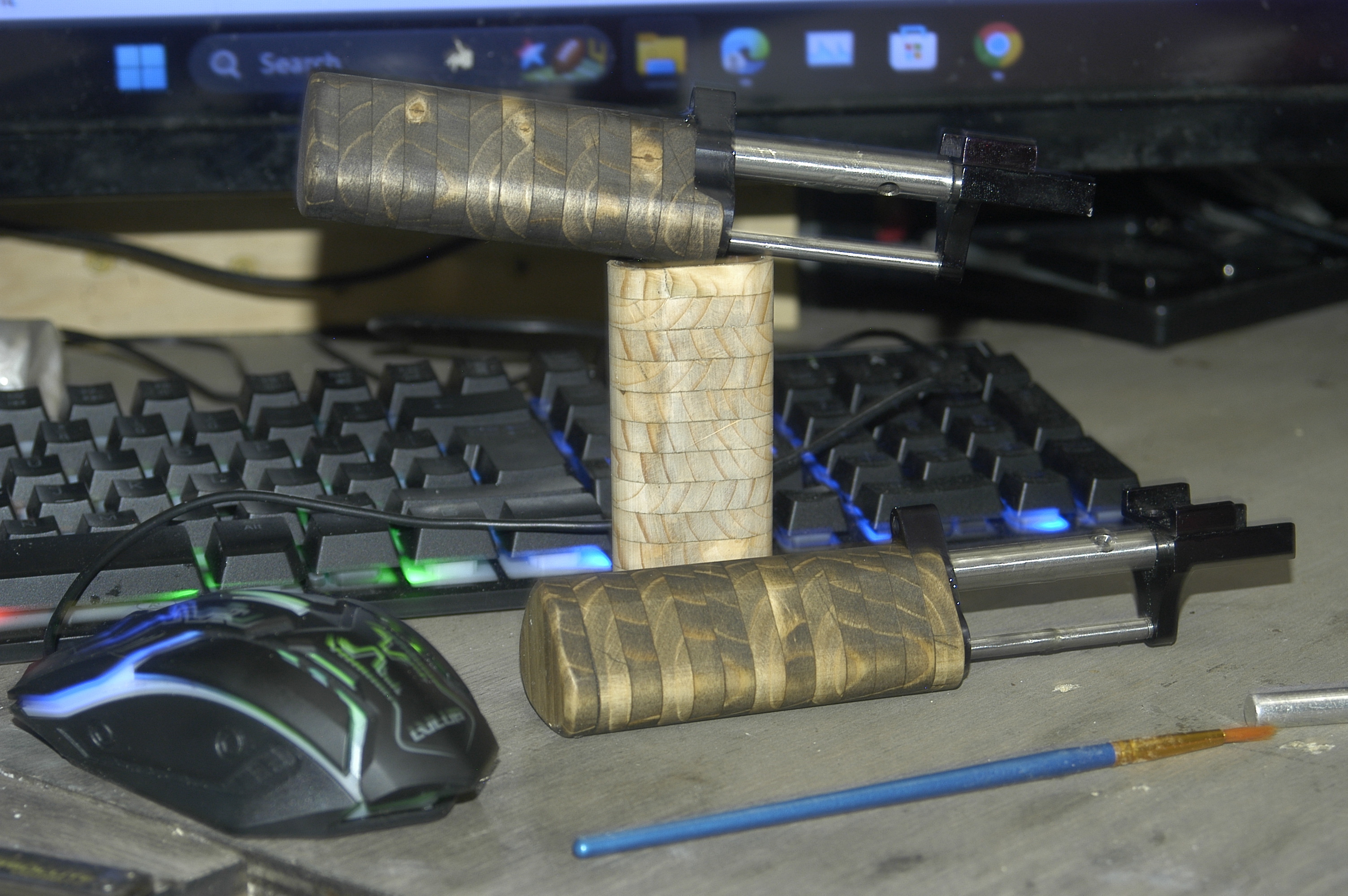

    I did find a fix to wood. Just need to refine the assembly of them, but they do look awesome. Pictures up soon.

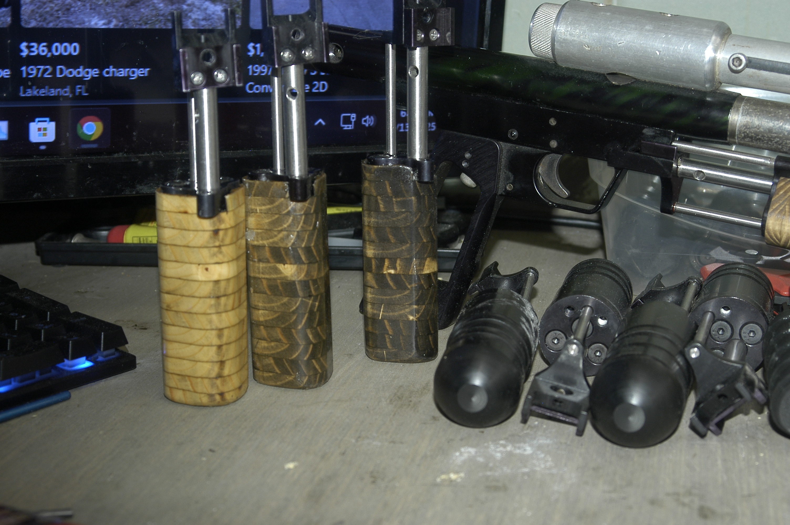

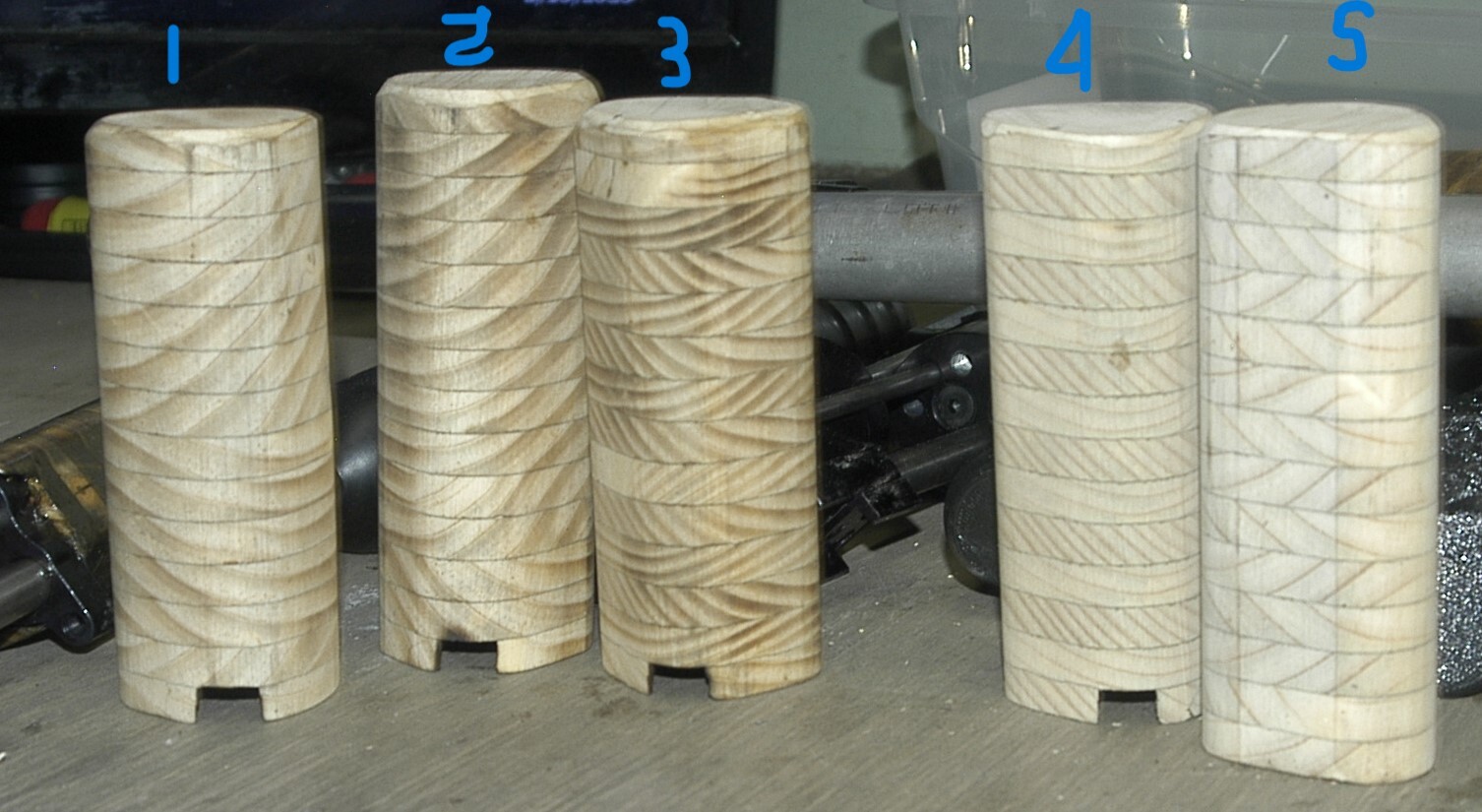

      new setup. 8mm wood sections glued together 11 stacks glued together. S DSC_3572.jpg tronger and allows more finish options.

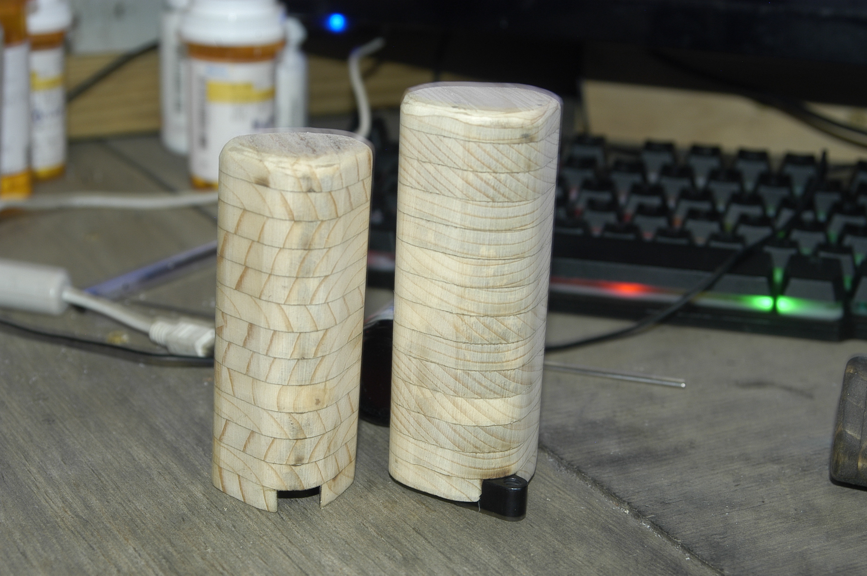

        Left the prototype. Right, what I end with. Theirs 2 .05 stainless rods that run clean thru near the edge used to a line the pieces and add support to plate cover edge.

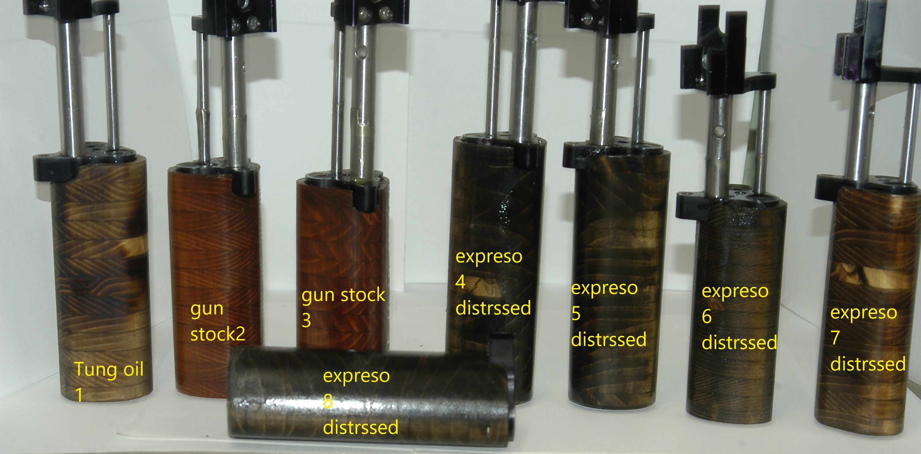

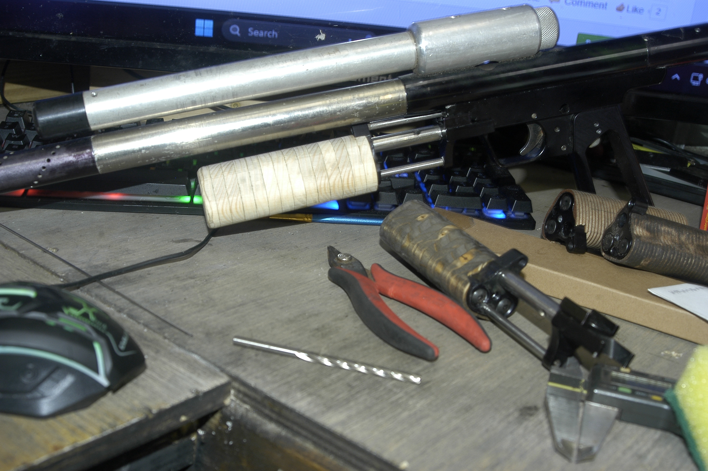

              Final pictures. These will be up for sale DSC_3577.jpg DSC_3579.jpg DSC_3581.jpg shortly

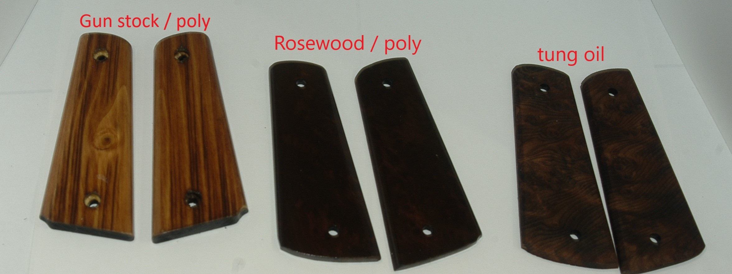

                Someone say wood grips

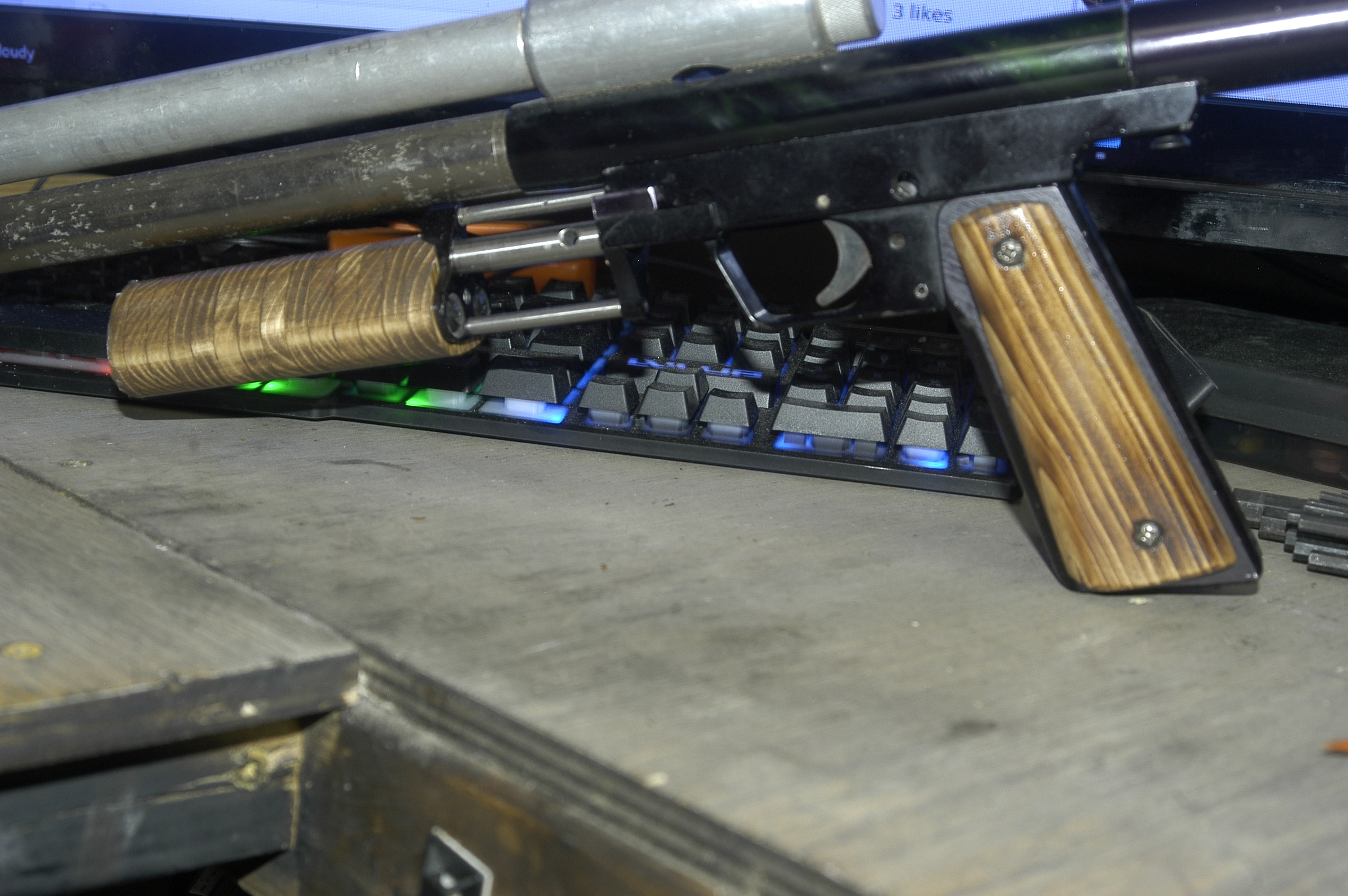

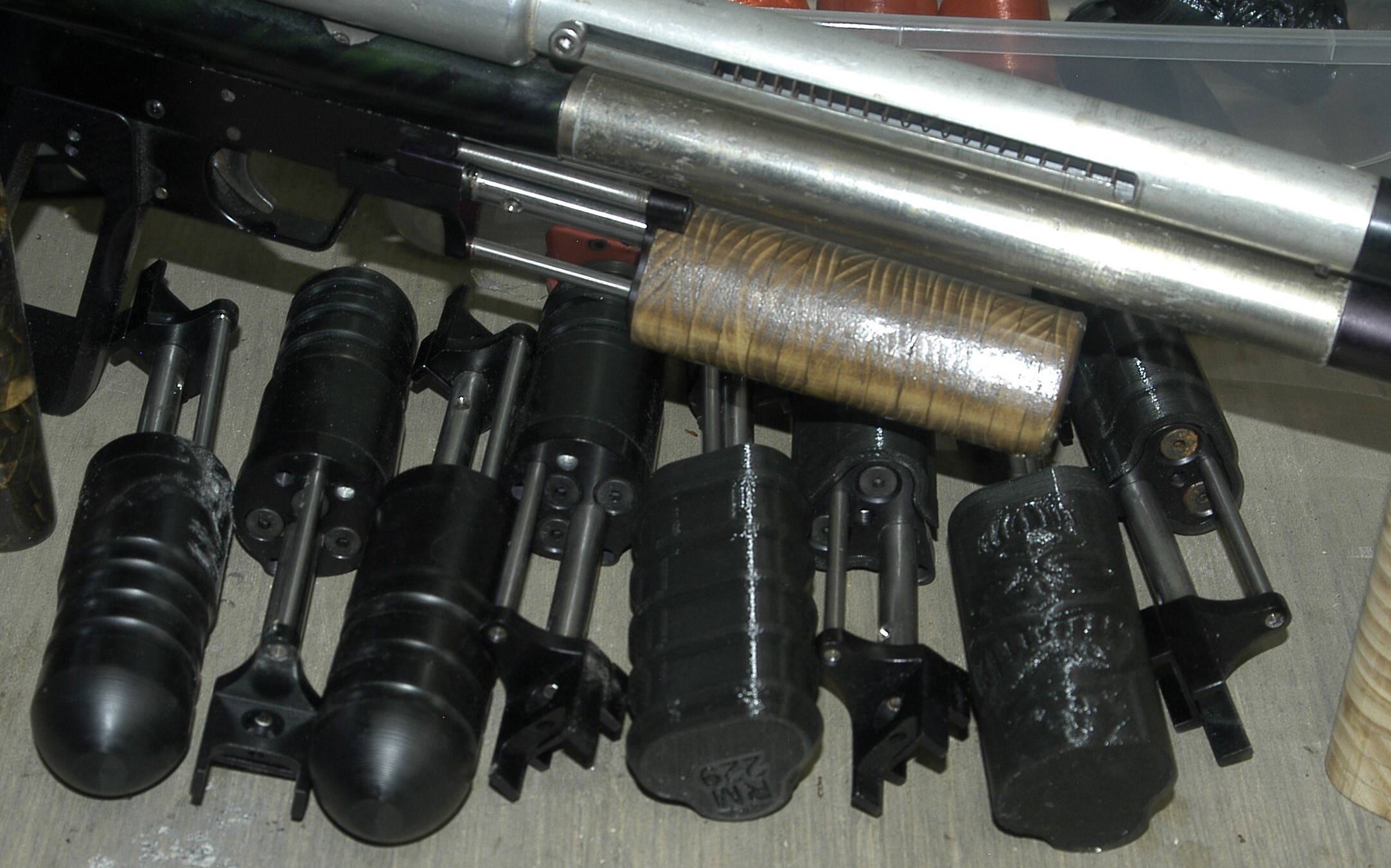

                    Man…this is all nice stuff.
                    Are you familiar with the way skateboard decks are dyed in layers before lamination thus creating interesting patterns when machined? It’s an extremely cool trick. Perhaps some version of it could be applied here.

                      Yes, I have.
                      Just don't think it would be worth the cost. But would defiantly be worth the cool factor
