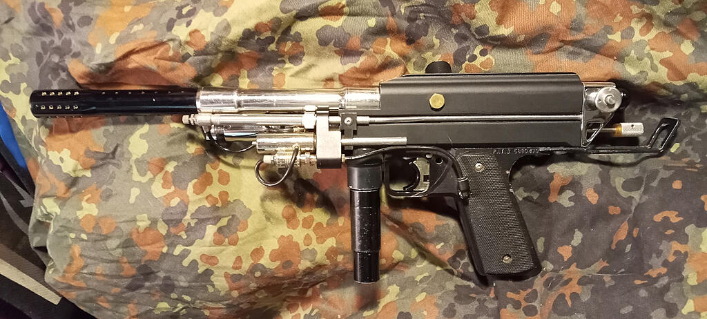

        That's the business side of a BPS reflex. You can see the longer ram, this turns on/off the valve just below it. When the back block moves back during a shot, the milled piece bolted to the cocking rod slides in a milled slot in the valve arm below. Once fully extended, the on/off valve turns ON. This pushes air into the slide check below it. The slide check is there only to turn the reflex system off and use as normal semi. Air goes from slide check via air line to mini ram installed in grip.
        So long story short. Fires a shot like normal cocker. But you can't hold the trigger IN and keep the back block fully extended manually. Ram in grip is too strong. As long as you keep pressure on the trigger, it keeps shooting.
