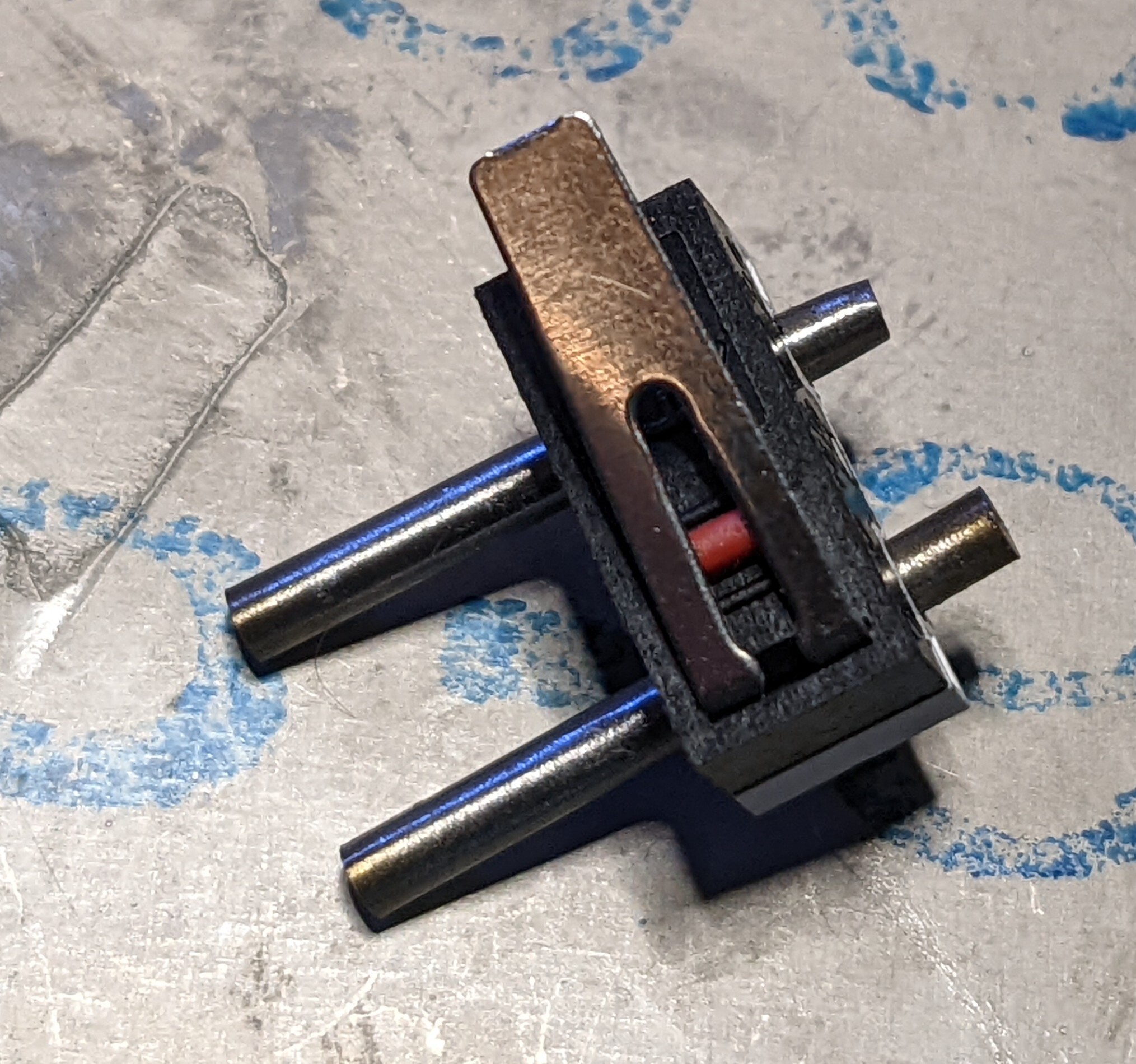

    To do:
    - find a way to attach trigger microswitch
    made some pins, now need a few spacers to keep the switch centered in the frame ...

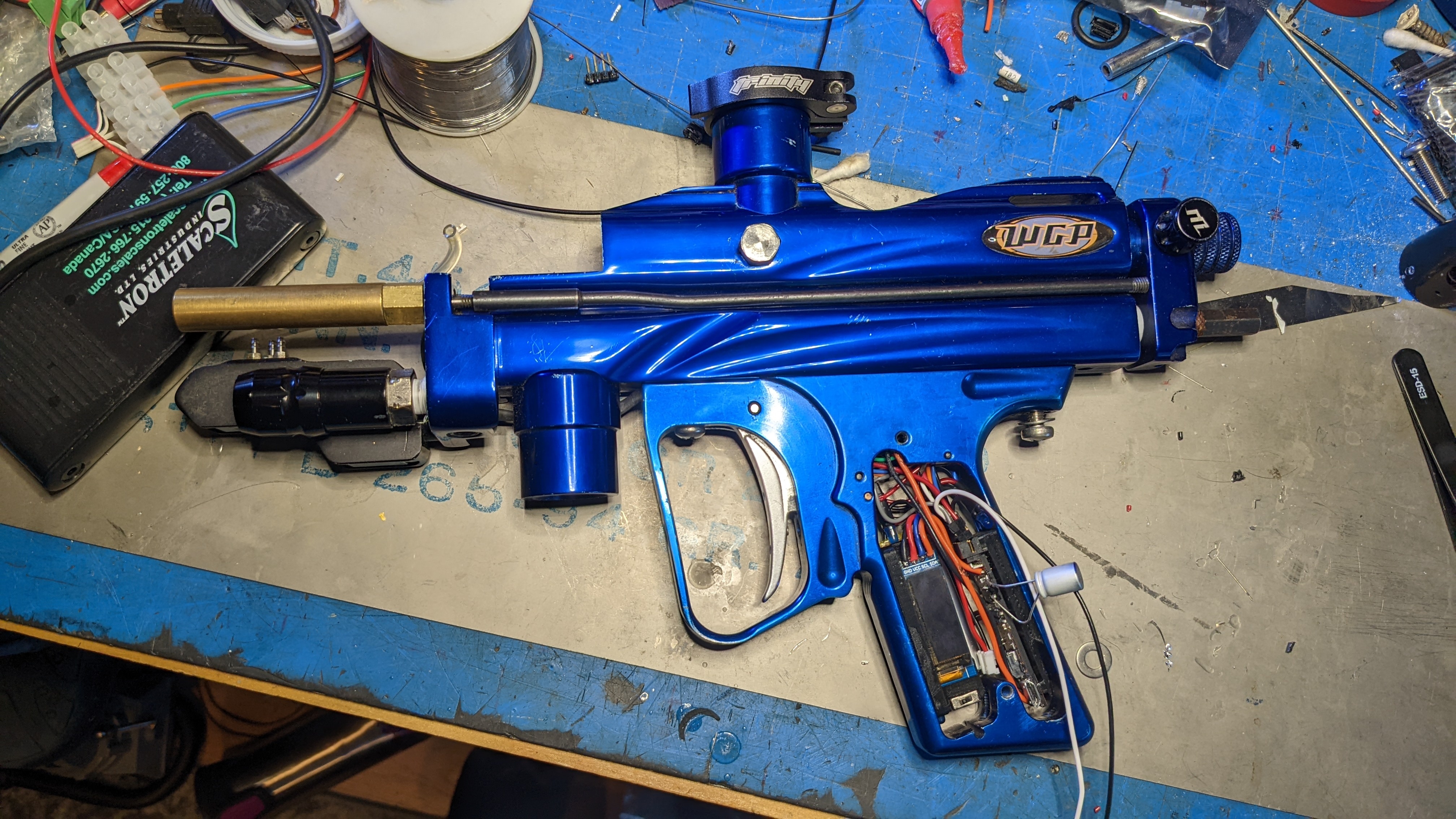

      No pic update ... I'm not able to drive a single solenoid from the lipo ... Trying to figure out where the power is going/dissipated on the Morlok ...
      I'm at the point where I may have to gut everything and start from scratch if I can't find a solution to this ...
      • devilzcall
        devilzcall commented
        Just a capacitor in parallel to the battery should do it
        XEMON commented
        Unfortunately it doesn't have enough power to properly open the solenoid ...
        Looks like the Morlok is just not able to drive the solenoid from the lipo ... So I may have to start over the project with a traditional 9v battery 😞

      #19
      This is the last good by for Der Cockermaker V2 ...
      this version will never see the field as it cannot work ... Time to start over with a 9v battery ...

        XEMON commented
        It suck ... I was looking forward to getting pretty electronics on display ...
        going back to this layout:

      • devilzcall
        How about a tiny 2s lipo instead of just a single cell? Those run between 7.6 and 8.4V but have a lot more output than you 9v and won't take up more space
        XEMON commented
        I thought of that, but the board has a lipo single cell controller, so i don't need a charging system for it ... which was the main appeal of the lipo in this install ... if i need to remove it to charge it, it defeat the purpose ...
        Also thought of putting a separate charge controller, but couldn't find anything small enough to fit in there ...
        so, all in all, return to the 9v battery is the best/only way to make everything fit in there ...

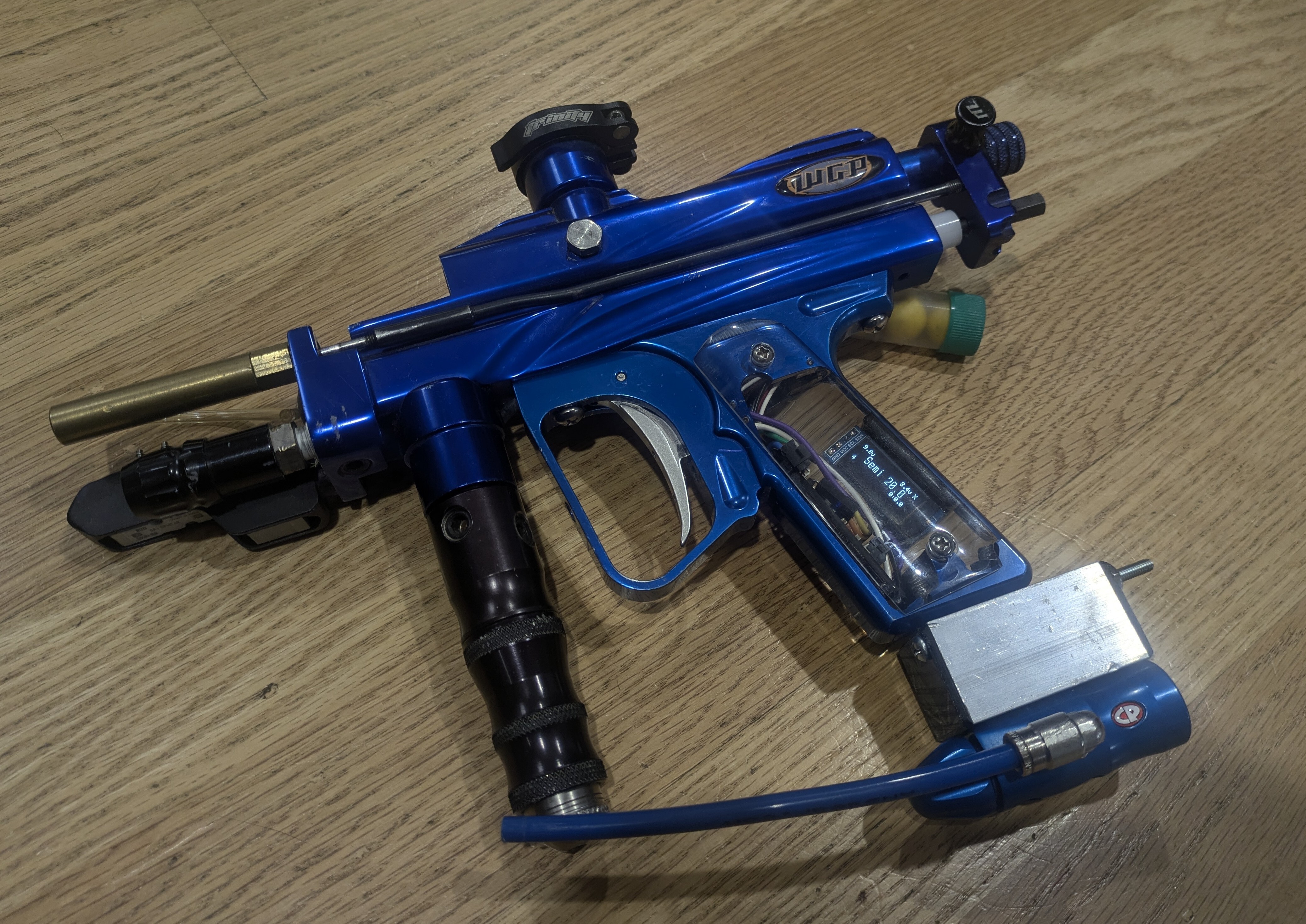

      After 2 years, and a few failed frame layout ... Which lead to scraping a frame ... Which lead to getting a new frame ...
      I have the final layout for the DerCockermaker V3 πŸ₯³
      After the failure of the Morlok to manage the lipo power output to the solenoid, I caved in and returned to a 9v battery.
      The shocker frame do not have room for the battery, screen and board, so I relocated the battery in a custom "drop"/battery compartment.
      Not sure about the reg, and need to tune it , probably need a lpr rebuilt, and hopefully the ram works πŸ˜…
      ​​​​​​​Here is how it sites right now:

      • Blackmagic71
        Blackmagic71 commented
        Good work! Looks like it’s coming along nicely.
