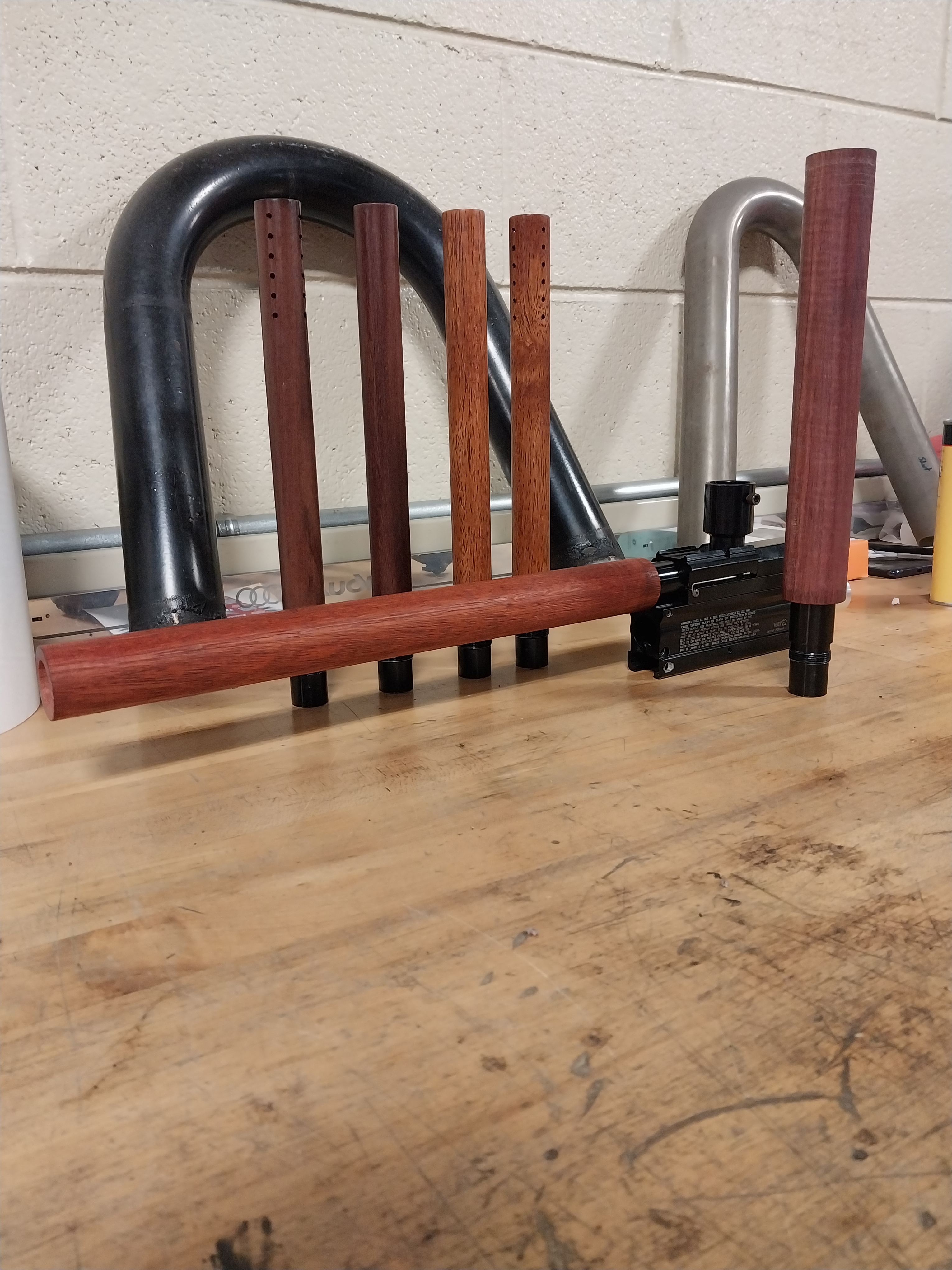

    Ok. Wood barrel, pump handle, grips and back block. Stained and polished to match each other.
    Brass pump arm, feedneck, trigger shoe and macro fittings

    I knew this question would come up eventually. Might not be the answer some people want to hear, but I'm the honest type. In my quest to make this concept a reality, I really wanted to make them as functional as possible. With that being said, they are most certainly SLEEVED. I used unported donor barrels as a base platform. The aluminum base barrel goes all the way to the tip on all but the purple heart. That one has an inch overlap. I tried to go longer with horrible results๐Ÿ˜….

        Sorry to disappoint... I would like to in the not too distant future. One of the most difficult parts of the process, at least for me, was reaming the wood. It seems to be quite annoyed when precision tools are introduced. When I figure that out, game on.

      What's price gonna look like on these, and I bet that purple heart was a bitch, was gonna build a bass guitar out of it till I heard that it's hard as a rock and will chew your tools up and it can be messed up if you don't follow the grain pattern
      • Sheepdog
        Sheepdog commented
        Still working on a price. There is a lot of labor involved. About 4 hours a piece total.

            Gorgeous work. Purpleheart is a wicked one to work with, but it turns out gorgeous, especially after you hit it with heat.
              #40
              Thank you sir! Was my favorite to build. Only trick was acetone and sunshine!
