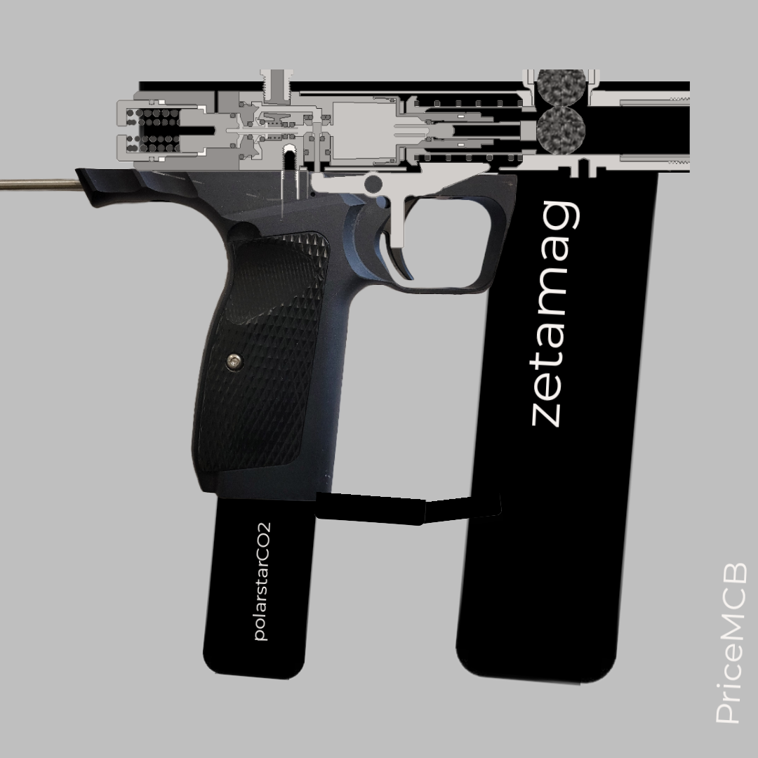

    Still hunted by a magfed Xvalve type of thing with co2. The sear is the trigger will this work?

      • 6182
      I see two problems here first is that you want to move trigger frame even more forward above so I don't know where you expect your finger to end up
      Second is that those Sears are hardened steel so if you want to go cut your own out you either have to cut it out of hardened deal without using heat so it will retain The temper or cut it out and then temper it yourself

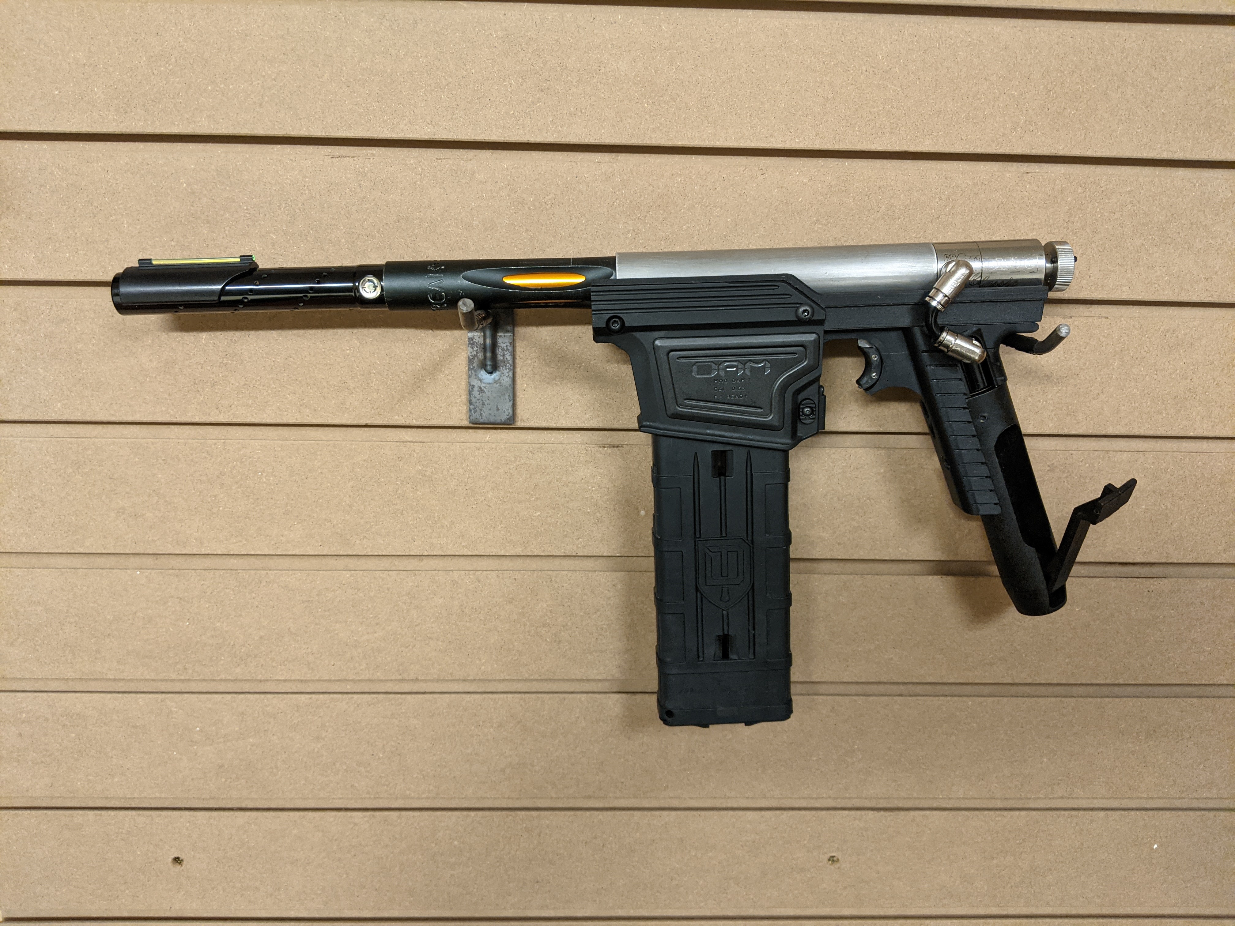

        PXL_20221001_190635040.jpg ​​​​​I've posted this up before
        Before? My dude, before is so long ago ain't nobody going to remember that shit. Like, was anybody even alive back then?

        • anson
          anson commented
          I put this together for a 12 gram only game here in Canada. The weather was almost freezing when we were playing so it only got maybe 15 shots per co2 cartridge.
