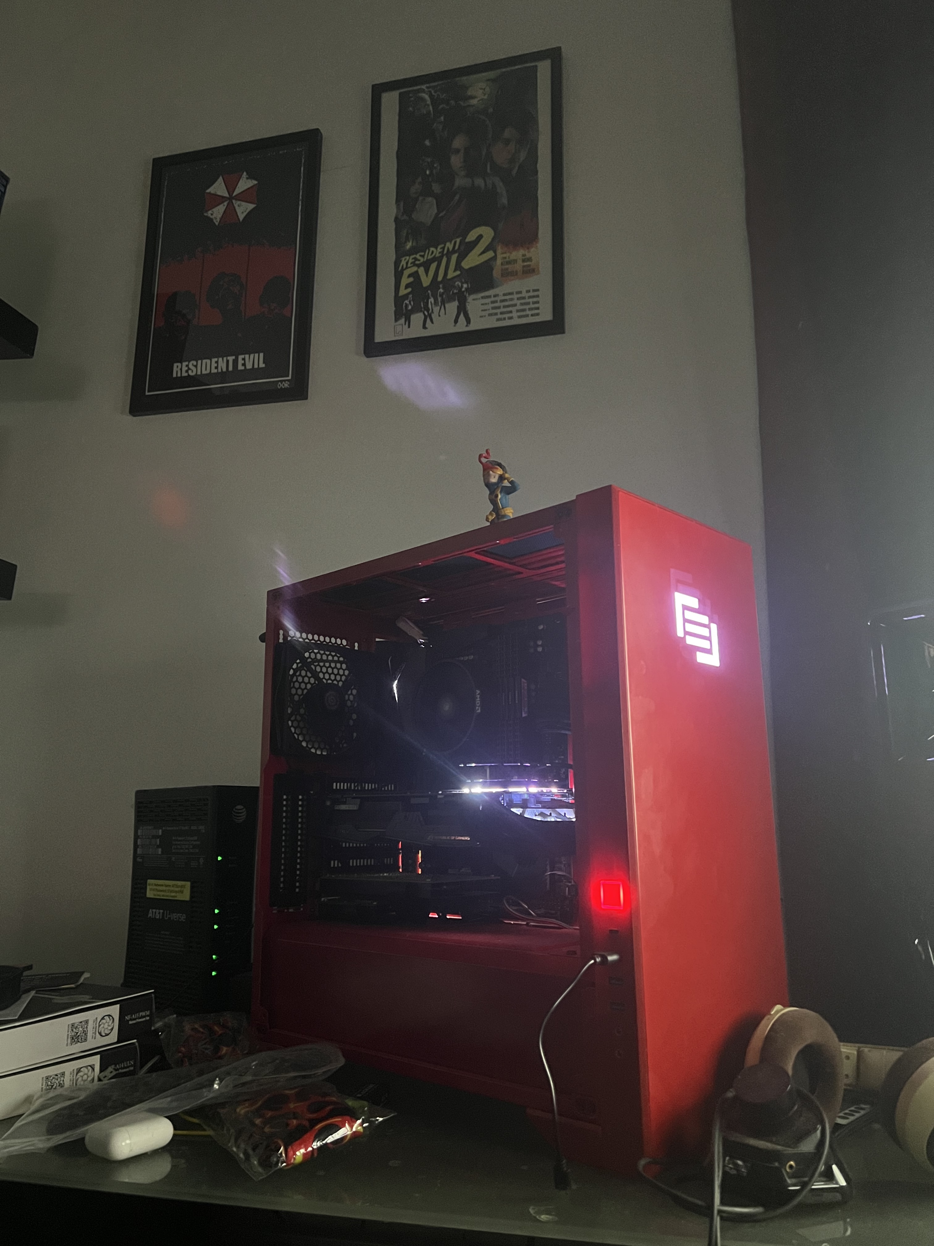

                        so, without further ado.. the almost (i have custom PSU cables coming) completion of months of planning, and a lot of luck
                        layer 1
                        layer 2
                        layer 3
                        and then some proof of life
                        and one from this AM, not that ive figured out how to sync the ram with the fans
                        the video card will always be off doing its own thing until EVGA wants to play nice with razer and the rest of the industry.. so ill just have to be satisfied with 90% of my lights synced
