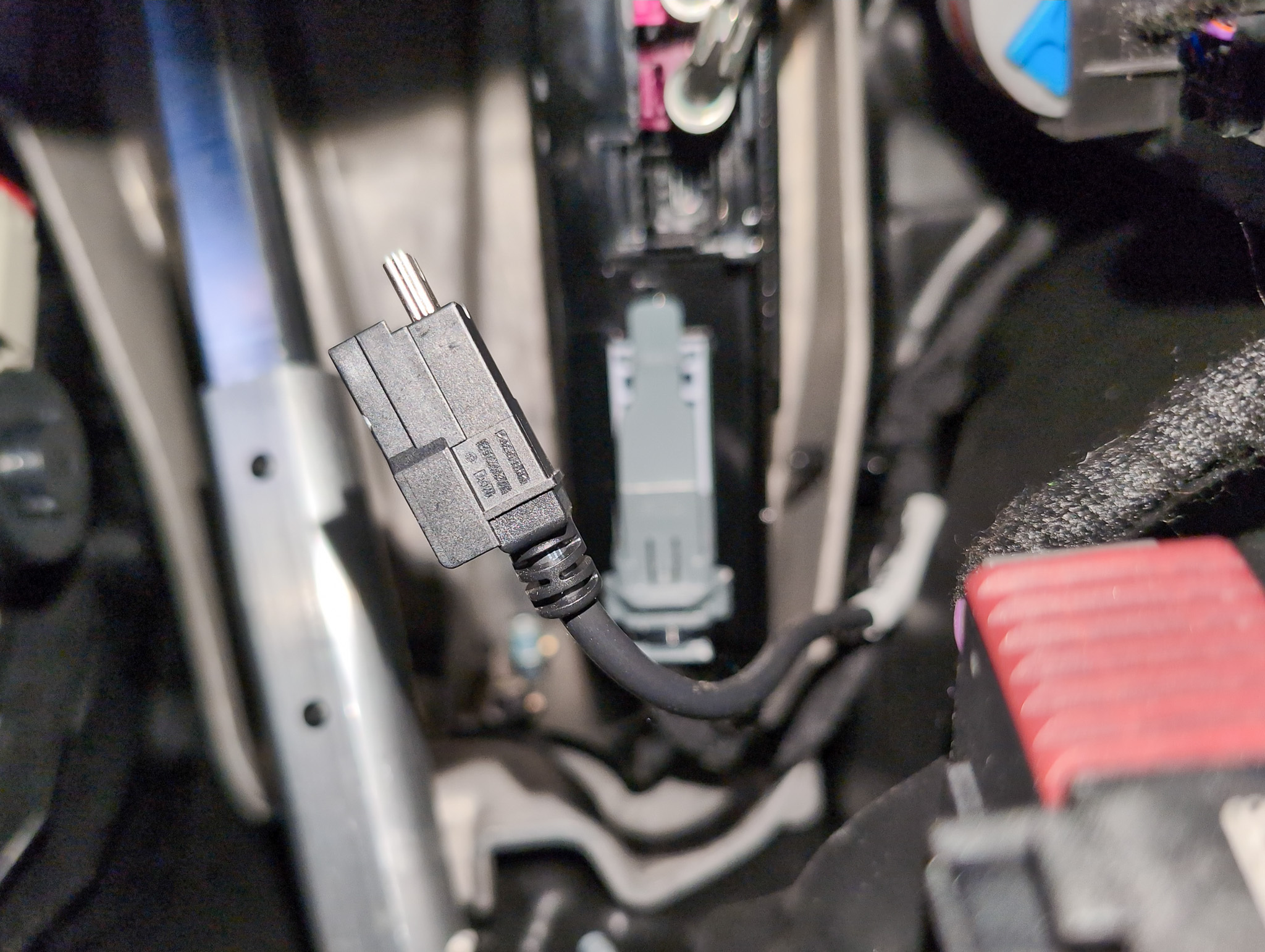

    The Jeep Uconnect box is under the driver’s side steering wheel. Under the steering wheel there’s a panel you can pull off with a bit of force. Crawl in upside down, let the blood rush to your head, and whatever you do—don’t get stuck. (I can’t help you there… and your step-sister might be nearby.)
    Under there you’ll find the box, with cables running in different directions. I followed a thicker coax-style cable, and it was plugged in. I thought, “This looks easy,” and it was.
    It basically amounts to something like a USB-A style input—so I wasn’t sure what I was disconnecting (power to the unit? power to the antenna?). But I figured I’d check my progress.​

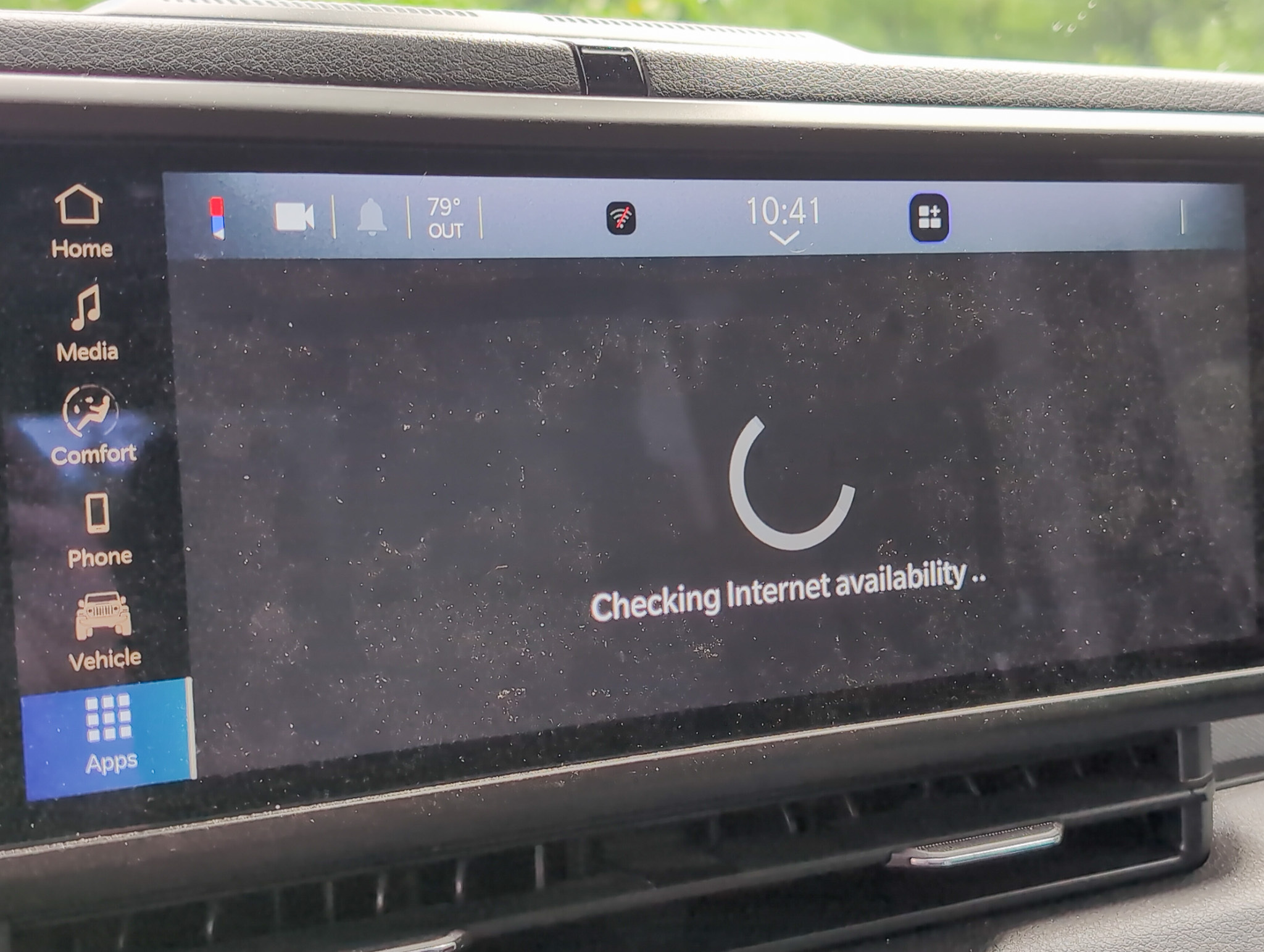

    Let's connect....
    Nope. No connection.

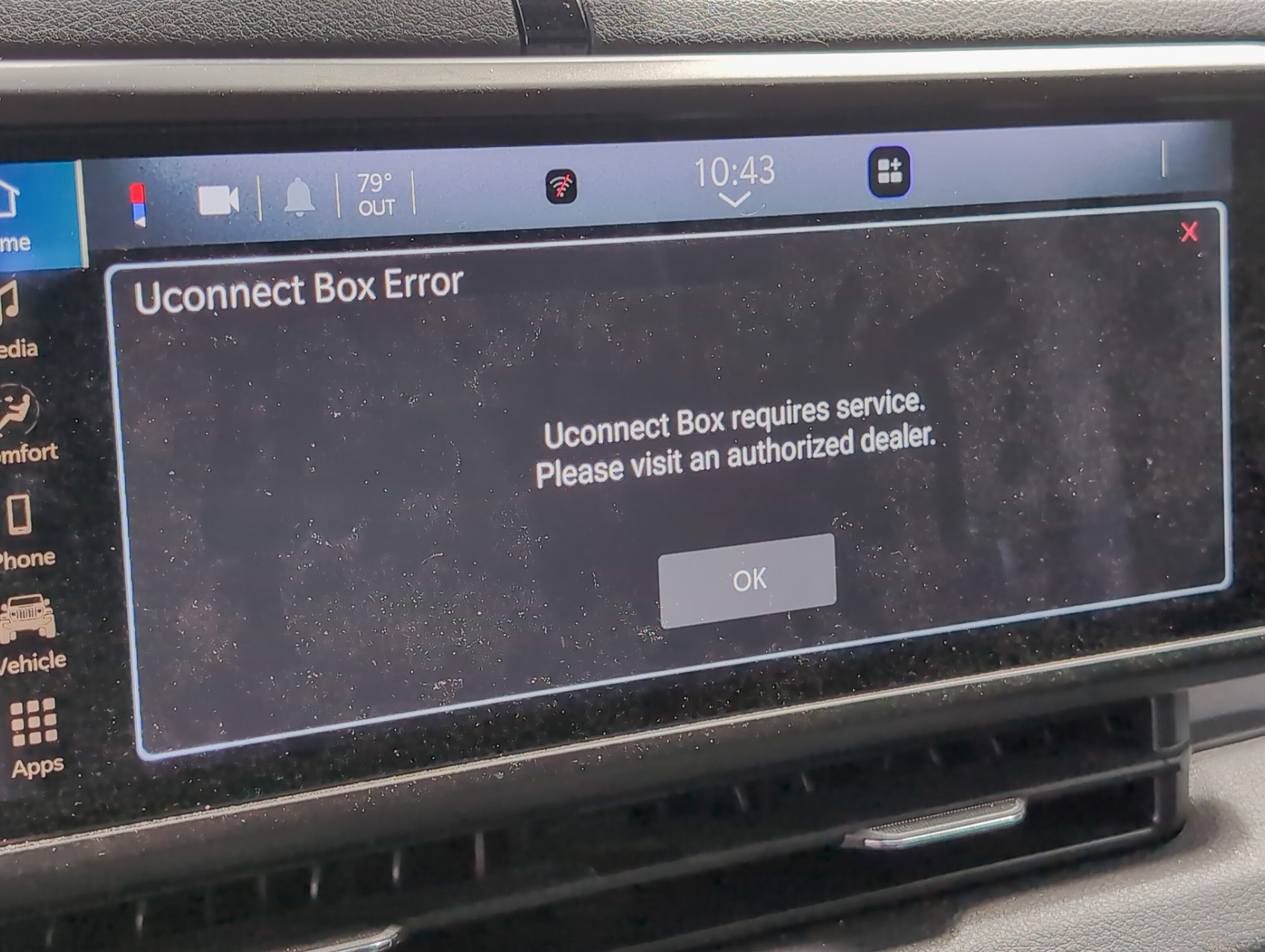

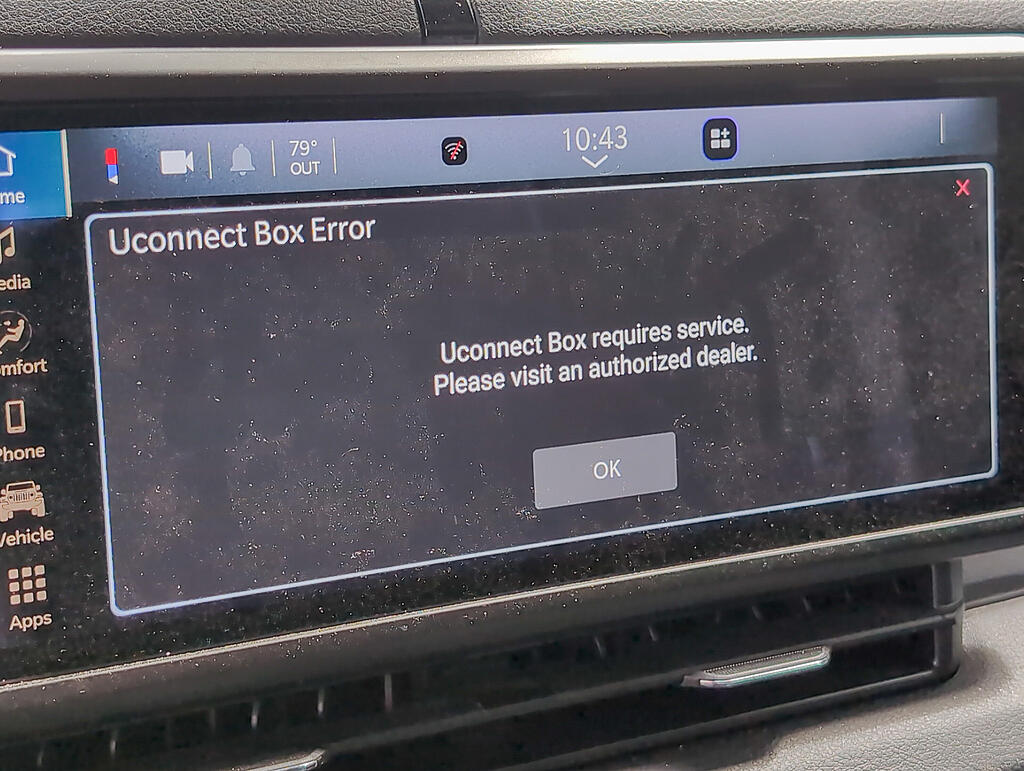

    At that point I did get a little worried: like maybe now the car might not work, or something “evil” might happen. So far, nothing. It pops up with an error message telling me to take it to the dealer. I hit OK, and it hasn’t bothered me again until I turn the vehicle off and start it back up.
    The radio still works. Satellite radio still works too (I don’t pay for it, but I did hear the ad to call the 800 number when I switched over). Basically, if you don’t use certain features, you seem fine.
