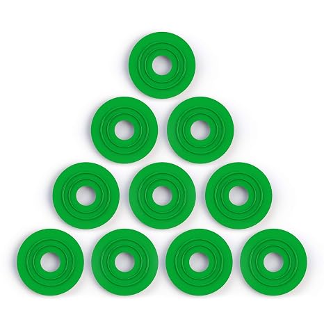

    You’re missing a plastic sealing washer for the fill rig.

    You need the flat disk seal (teflon 🤔), it has a hole in the center of it. I'll do a quick search and get back to you. 😉
    edit ...you'll need something like this. They can be found in the Amazon and other places like welding supply stores.

      There is a shaped seal that sits in the female end of the CGA320 threads (white one in the picture). I think it's a hard delrin or nylon to prevent freezing. A normal oring might work though, idk. You should be able to order a bunch of these shaped seals on eBay.

        It is most likely nylon.

          Thanks all! For the fill station seal, I think I am going with a brass screw in one that uses two ordinary o-rings and stays permanently attached to the bulk tank valve. For the price of 10 nylon washers I won’t have to worry about loosing it.
          CO2 Permaseal Leak Stopper (CGA-320) (1) https://www.amazon.com/dp/B07MH3M9JB...DNMJP8FB5SD9B7
