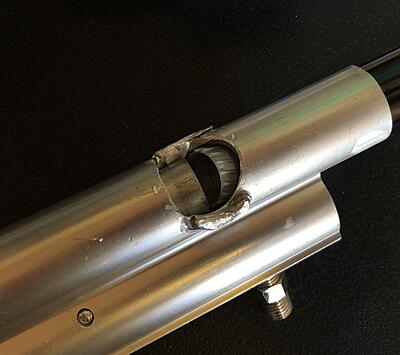

        Greetings Doc, I'm looking to understand First Strike rounds, and figure rather than investing in a new marker, why not modify a beat-up old Spyder.
        Are you available to provide hints on the best way to remove welds from the previous power-feedneck? Also, is there anything that can be done to make loading the First Strike rounder easier? It seems like I'll have to shove the First Strike rounds further into the breech to prevent a chop.

          -Virtually anything. Dremel, belt-sander, hand file, milling machine, rasp, rotary file, Foredom tool... if you're careful, even a sharp chisel and a hammer. Cleanest and best would likely be the milling machine, but if you don't have access, that's not an option. Dremel and patience, an air sander, a 4" grinder with a flap wheel?
          -You might not have the capability for this, but here's an idea for you. Remove the pin that links the bolt to the hammer. That way the bolt is no longer actuated by the hammer movement. Come up with a locking method to keep the bolt forward- a really trick idea would be to mill an L-shaped groove in the upper tube, and add a rifle-style bolt handle to the bolt. Lift, draw back, chamber, push forward, fire. You'd want to add a block or pin or something to keep the bolt from simply flying out the back of the gun when you yanked on it, but it's doable.
          And the slower bolt movement should help feeding.

            Instead of removing the pin entirely, shorten it so it still rides in its channel but won't engage the bolt. Don't want the hammer rotating enough to stop engaging the sear. Don't ask how I know.
