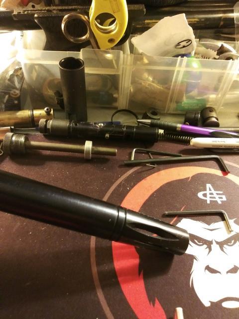

                        Doc,
                        Any idea, Who was the manufacturer of this 14" AC threaded barrel?
                          -Boy, that muzzle brake design seems familiar, but the only barrel I can recall with a sort of "straight rifling" was the old J&J stuff. Sorry I can't help.
                          Doc.
                          Paintball in the Movies!
                            Carp commented
                            Thanks for the effort Doc, I want to say it resembled a Thunder Pig Tru-flight( or whatever it was called).
                          • Magmoormaster
                            Magmoormaster commented
                            I'm fairly certain it is indeed a Tru-Flight.
                            Doc,
                            I think its CMI
