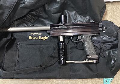

        There's plenty we can do, but you gotta understand, it's kind of an open-ended question. It's like "what can I do to this car?" Well, are you going to drag race it? Mud-bog it? Autocross?
        In the case of a paintball gun, are you looking only for maximum performance? The best consistency, accuracy and efficiency? Are you looking for a wild showpiece that looks as good as it plays? Are you looking for a major reconfiguration, like an electro conversion?
        Repeating my last answer: Bolt, definitely, maybe a better detent; we fit it for an Empire style feed neck, and a Freak back.
        After that? If you wanted to give it a swing, we could try one of those low-recoil valves, add some body milling and have it custom annoed, and if you really want to get wild, replace the pot-metal grip frame with milled aluminum.
        Throw a midrange-pressure inline reg on there and do some tuning for consistency. If you have a choice of rail or ASA, if that needs a T-slot or dovetail, that can be added too.
        I need at least a little guidance. My idea of cool and radical might not be your idea of cool and radical. I mean, I might wind up trying to fit a Gamma Core engine in there.
        Doc.
        Wild showpiece is definitely the right direction, staying mechanical. So here is the pic of the VRaptor. The vertical feedneck has a hole drilled through it to reduce blowback, so it needs to be replaced - I think better bolt timing/length can get rid of the blowback issue. I agree on the detent. I have a BE Eagleworks/Jacko barrel that I'd like to Freakify for this. The regulator will be a MaxFlo coupled with the BE expansion chamber as a foregrip. Bonus points if you can recess a gauge into the bottom of the expansion chamber. The grip frame should be the double trigger pot metal, but maybe reworked/polished up to look better. The Monsoon (in the second picture) has a nickel plated pot metal frame and an anodized trigger.
        Folks used to also put a cocker rear rod onto the striker and a custom beaver-tail to make it rear-cocking. It makes sense since there are no slide slots on this body. Only the top-cocking slot.
        Then custom milling and anno.
        If you really want to get wild, make it mech full-auto the way ME262 designed it 20 years ago. A ram (air cylinder) coupled with a needle valve and a quick exhaust to slow down the cyclic rate. You could even fit it all inside the top rear plug and make it selectable by turning it (selecting different sized exhaust hole). But that may be too much without getting CNC involved.
          -You're always going to have some blowback in a blowback. The only exceptions are for things like the VM or Golden Eagle, whose hammers are so big the whole cycle is slowed down. We can lose the vent if you're going to go with a modern force-fed loader, but I'd recommend keeping it if you'r ejust going to use an agitator.
          -Easily done. I wound up with a binful of those years ago. Rethreaded most of them for other guns, Freaked just about all of them- since the bore is like .693".
          -Max Flow, yes, expansion chamber, no. Well, let's say I wouldn't recommend it, anyway. Won't do you any good, other than slightly reducing your per-tank shot count. Personally, I tend to prefer the old KAPP gas-thrus. If one can't be found, I can make one.
          -That would indeed be cool, and yes, I think it can be done, but just about any generation of the Max Flows up to the screw-ins had a built-in port for output pressure.
          -Easily done. But pot metal tarnishes rapidly, especially in contact with a sweaty hand. The frame would have to be painted, Cerakoted or plated.

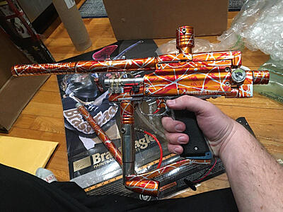

          -I haven't seen the Monsoon in years. Is that your photo? Is it still around?
          -Easily done.
          -Also easily done.
          -It's not something requiring of CNC, but that kind of setup tends to be pretty finicky. The kind of thing that works great in the shop or the backyard, but can be troublesome out on the actual field.
          Other options: It can be remachined to take Autococker barrels, we could make a new ASA, even one of the classic 15 degree ones the Automag and Autococker guys were once to fond of (or, alternatively, angle it a few degrees back to match the main grip angle) and there's always things like custom grip slabs. I also have a laser, so adding a name, slogan or signature after it's done, is also possible.
          Doc.

            The Monsoon is mine, I hunted after it for 8 years. Dave Brisco, who built it, also used to have a Raptor with hand painted flames.
            So it sounds like I don't have any particularly wild ideas for it. Would you care to throw some out?
