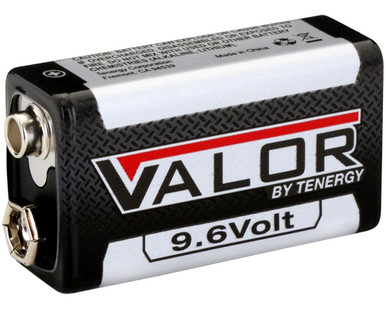

        Have any of you guys found a good source for Rechargeable 9.6 Volts ? I have a spyder with an ESP frame, and although it does work on regular 9V batteries, I read i might get better performance out of the frame if i can find 9.6 V batteries
      • Tarsun2
        • 1030
        what about "batteries +"
        • Cunha
          • 2151
          Powerex is a decent 3rd party vendor for stuff that isn't offered by eneloop basically.
          Can't count on them 100% but they do have decent cells sometimes. I second william the thirds recommend.
