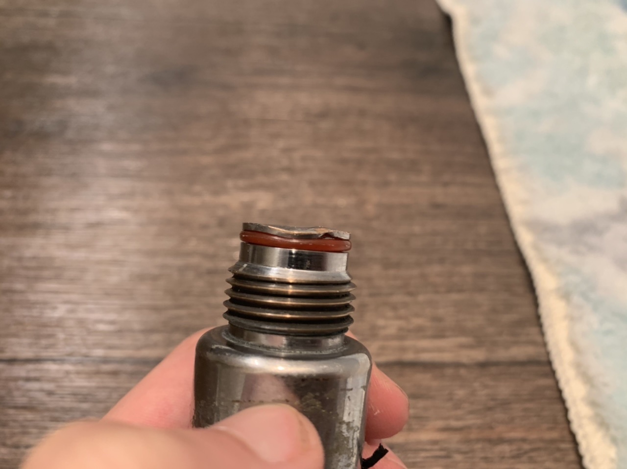

Ever drop a tank?
  • MrKittyCatMeowFace
    • 2378
    Ever drop a tank?
    88C00B1B-297E-4EB8-82B7-CE28569AC884.jpegStill works 100% fine but man that dent always has to remind me. XD

    Oh, the number of rental tanks I've dropped over the years is probably very high. I think I've had a few fiber wrapped tanks roll off of tables but never truly dropped them.
    Dented bonnets like that are a true pain in the ass. It'll tear o-rings quite a bit more often. They can be bent back most of the time. I'd recommend trying that.

      I did tap it a bit with a hammer awhile back and it looked better afterwards. Have two ninja adjustable ultralites regs so i can switch it whenever. Really think i got lucky

          I've dropped a CO2 tank and damaged it in that fashion, although only about half as bad. Worked just fine after. I'm all about thread protectors and fill nipple covers.
          You should be able to pound that damaged portion back into rough shape with a brass and/or steel punch, but the sealing surface is below that, so, as long as the o-ring isn't being pinched too much, you could probably get by doing nothing at all.

                          I've done that god only knows how many times with Co2 & HPA. And I use thread protectors regularly. Be careful bending them back, I've shattered the bent part before.....
