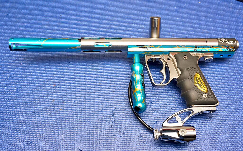

    I've been rebuilding an AutoMag fitted with a retro valve and a level 10 bolt and it's been nothing but trouble.
    The latest issue is with the bolt.

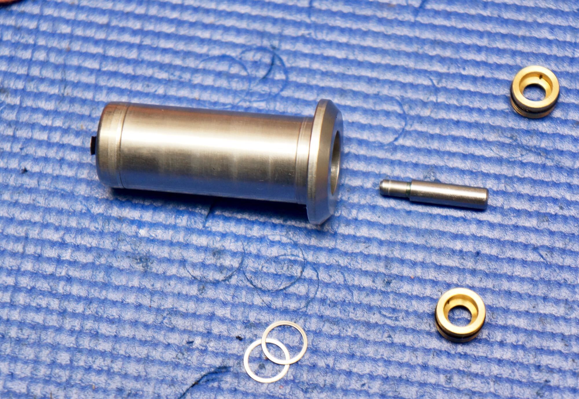

    After a bit of test firing it started leaking a lot of air down the barrel. It had me scratching my head for quite some time before I noticed that lower part of the bolt pin was missing (it was inside the air chamber). From the looks of it this part is pressed in with Locktite or something similar.
    My question is had anyone managed to salvage a level 10 bolt with this issue. I was thinking of using Locktite 620 which is a very good retaining compound and I have it to hand.

    Try the loctite, I’ve never seen that particular failure.

        Only other time I've seen that sort of thing was with the old Pro-Team venturi bolts. Every one we had locally (three or four) the center pin eventually walked it's way back. Never came out entirely, but when it slid backwards, the "timing" went haywire and the gun would stop working right.
        On that L10... There's a lot of inertia on that pin. You can try a good Loctite or epoxy- careful you don't block the vent- but really, I'd be inclined to replace it entirely.

            I've loctited it together and so far it shows no sign of moving. It was a tight fit which is a good sign.
            If not I can get another bolt locally.

              Damn that thing looks good.
