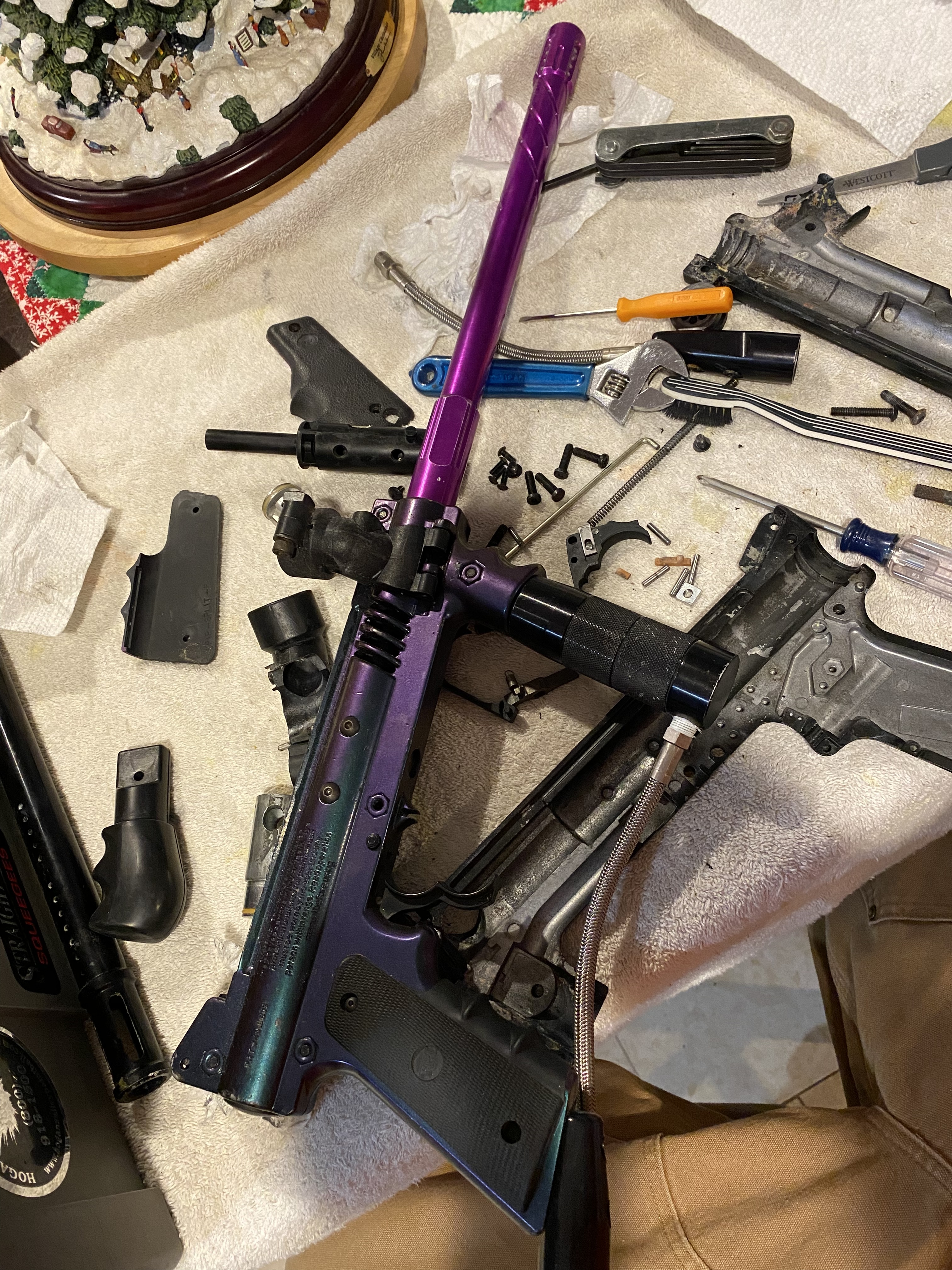

    So this is an extremely basic question but I truly have no idea because I’ve never owned anything Tippman in 34 years of playing. Is the Tippman model 98 trigger frame solid or have a removable guard like the 98 Custom ? Reason asking is because I’m messing around with this chameleon colored one and it came to me without a guard and a double trigger on it. Thanks.

    Stock configuration would be a single finger trigger and a non removable guard.
    Edit: go here and check out the manual...VintageRex

      It doesn’t look cut though that’s what’s throwing me
      Carp commented
      NONOBLITUS I'm just going by the manual. They may have added the removable guard in later versions.

    It's possible that it's not a factory chameleon 98..... Your gills look cut out and painted over

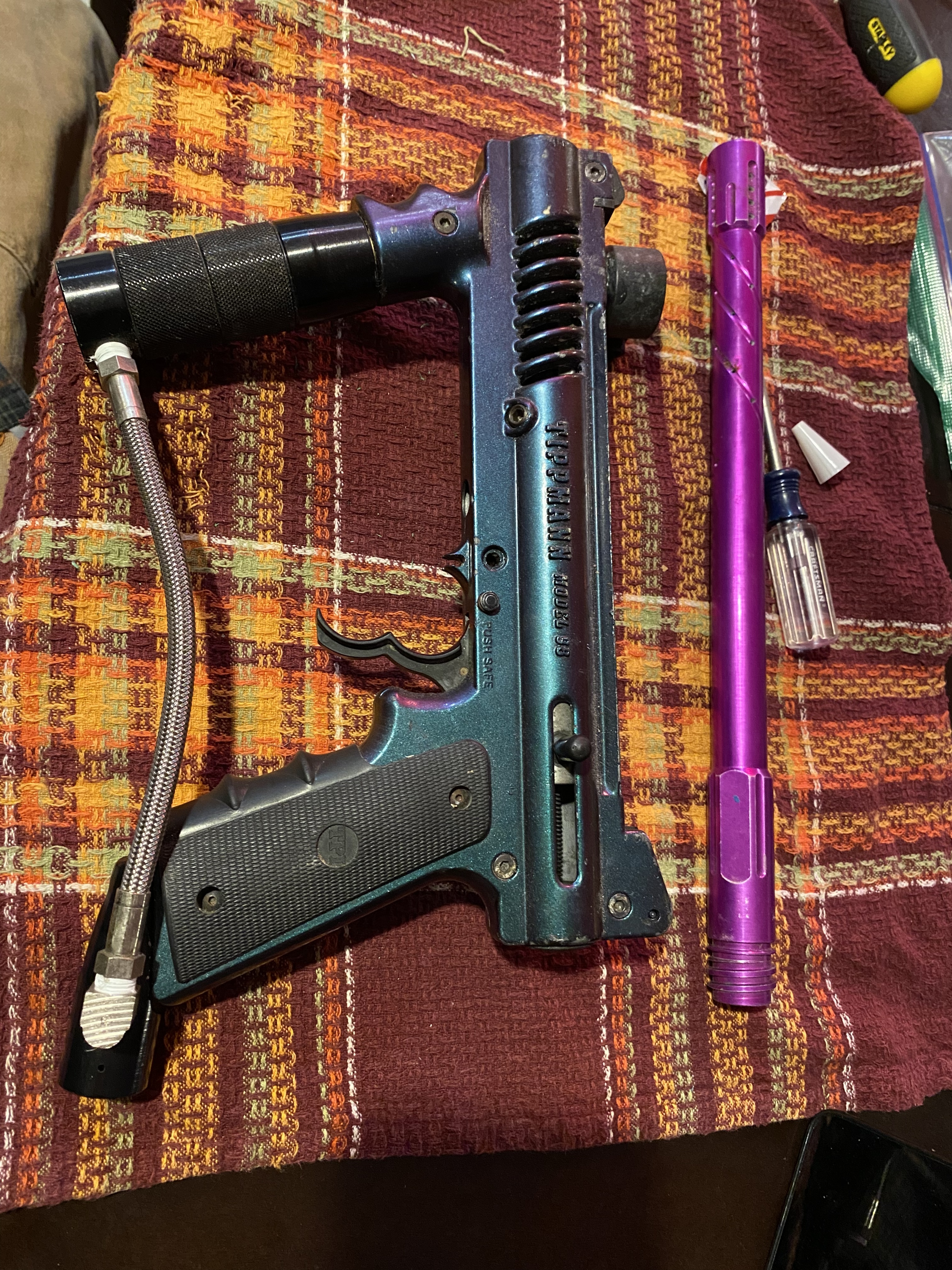

      Here is a little more body detail

          Yeah looks like someone cut off the factory cast trigger guard then painted it. The body nuts are painted

            Kinda odd the way they cut the factory guard. I bet it was to line up with the bottomline mounted guard that came with the double trigger. Looks nice.
              Ecapnation commented
              Likely for use with the early full hand bash guard that came with the 98 kits

                Here is my tear down of one of these. Solid trigger guard.

                  Thanks , the way it was cut at the body had me curious. Thank you and I’ll still get it rolling again.
                    Cdn_Cuda commented
                    The cut is curious. Maybe it was modified to fit replacement trigger guards. Can’t remember if they were A5, newer 98s or X7s off hand. I’ll look in my gear box as ai have a few of the guards kicking around.

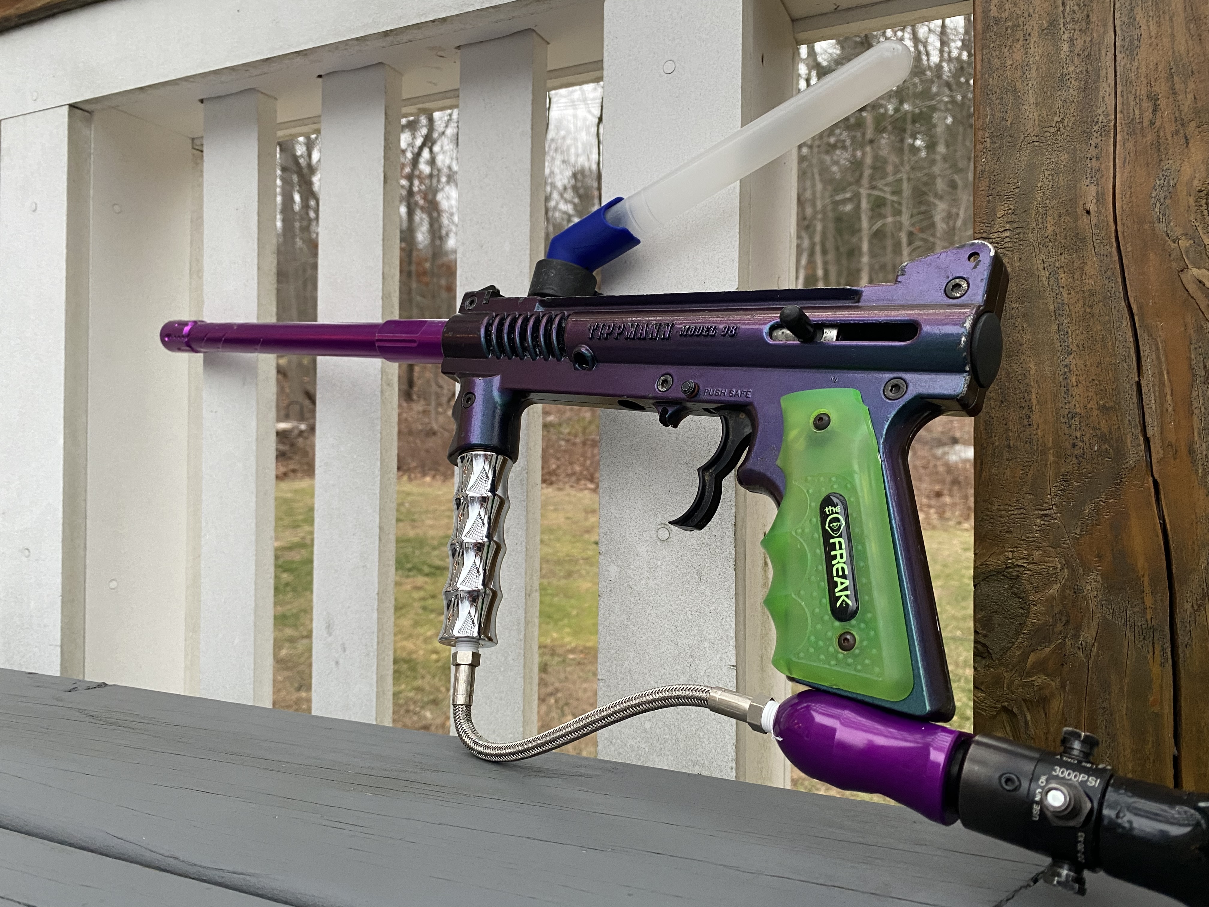

                    Well here is the freshly rebuilt oldie. Shoots great and the Janky look just adds to my enjoyment of it.
