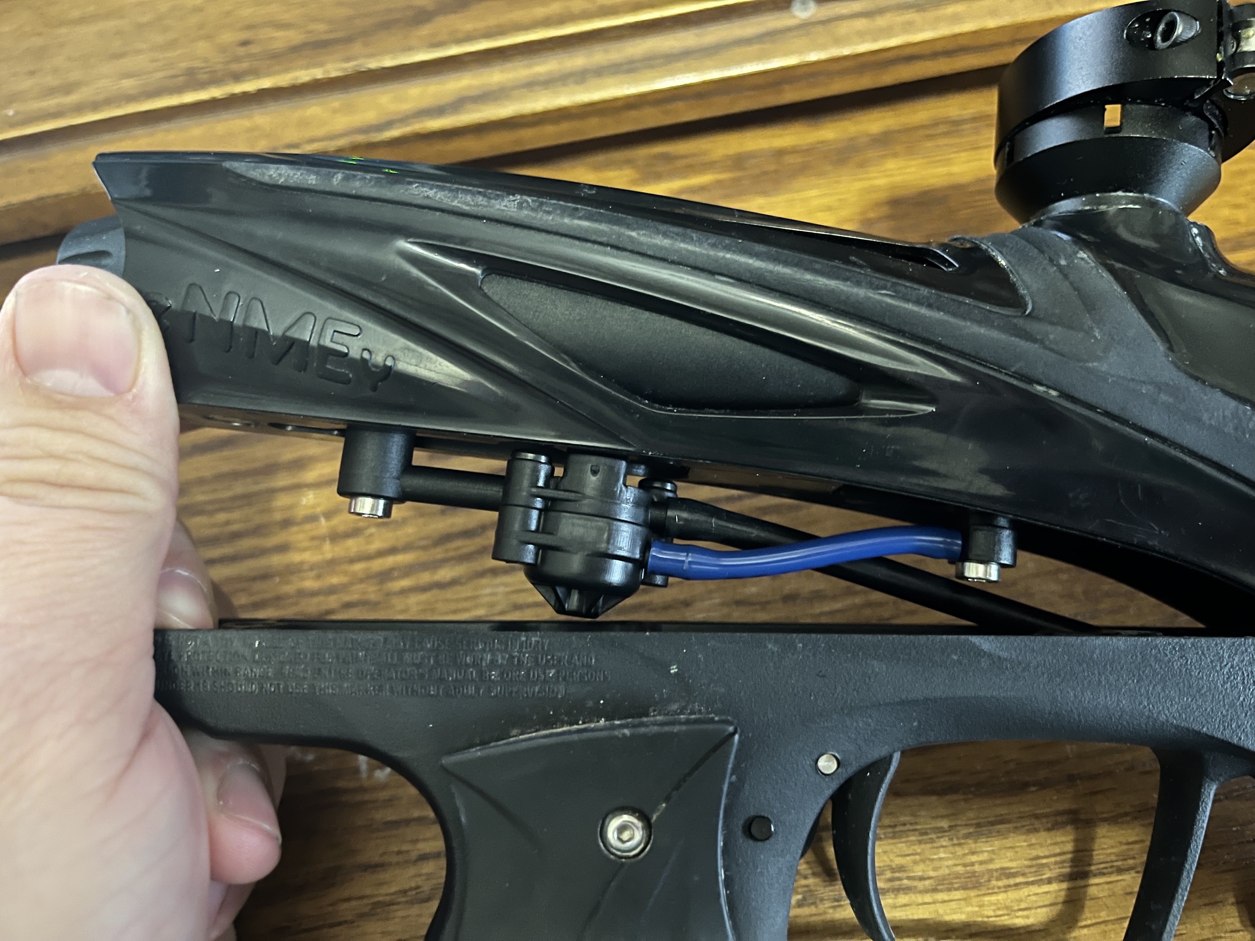

        MrBarraclough Here are some pics I have on my phone. I can snap some without the grips when I get home. I bought it this way from a grow MCBer, and the person he bought it from did the work.
        EDIT: added a picture of underneath the grip. I can get more upon request.
        • MrBarraclough
          MrBarraclough commented
          That's really cool. Haven't had any issues with the trigger tail rubbing against the internal hose?
        • Brokeass_baller
          Brokeass_baller commented
          Nada. There's actually a little space between them. Like, 1/8" or so.

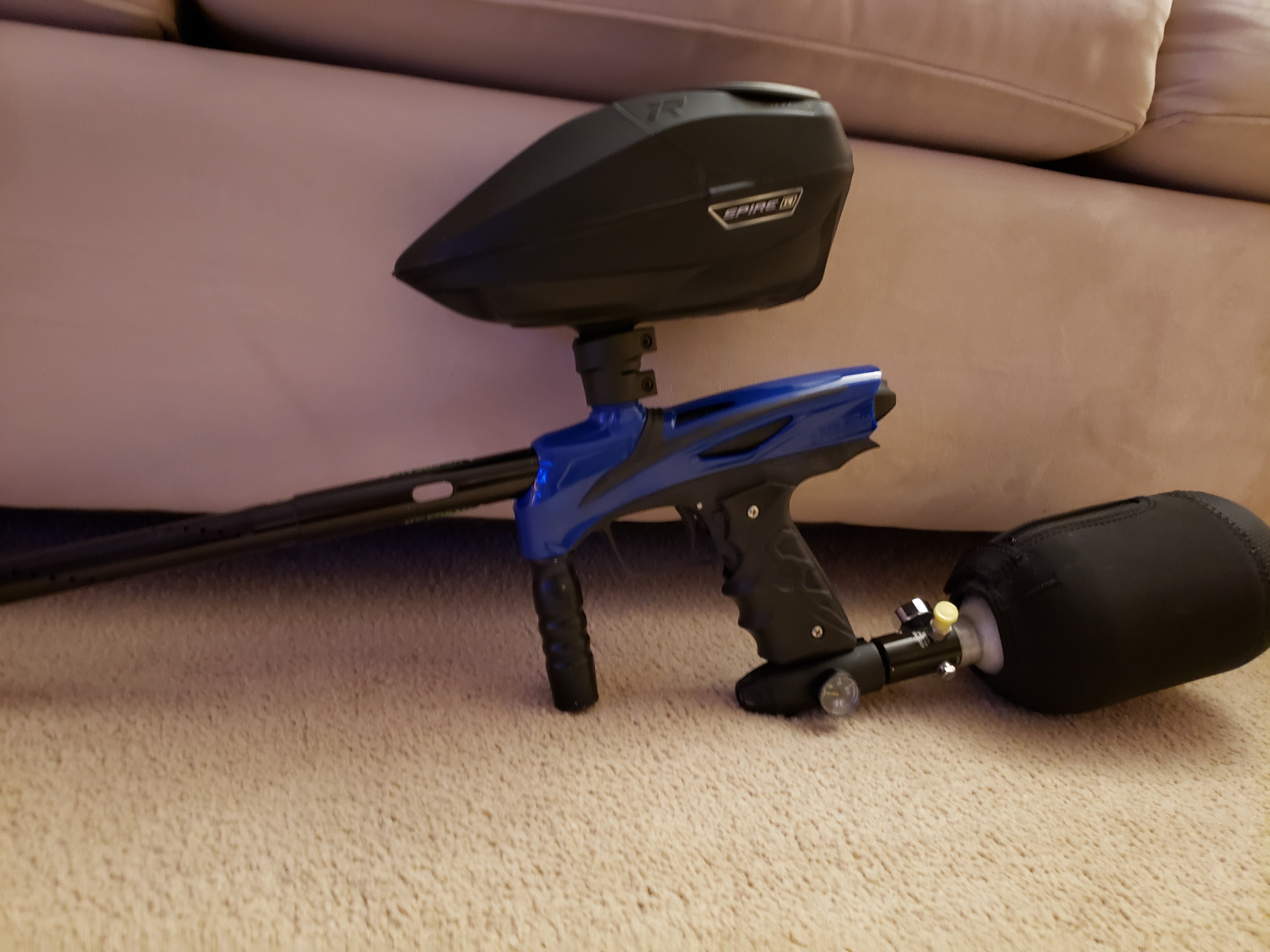

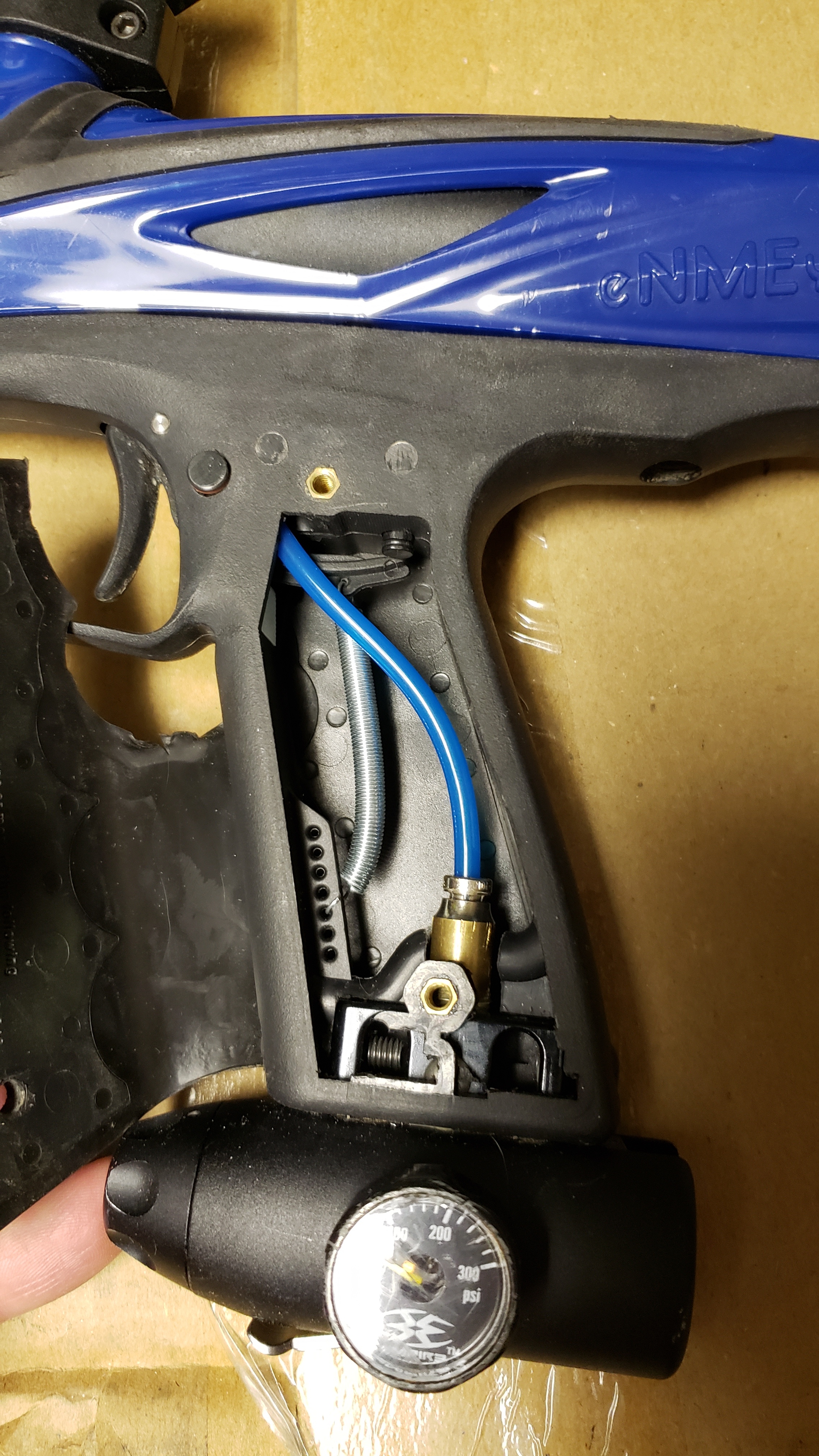

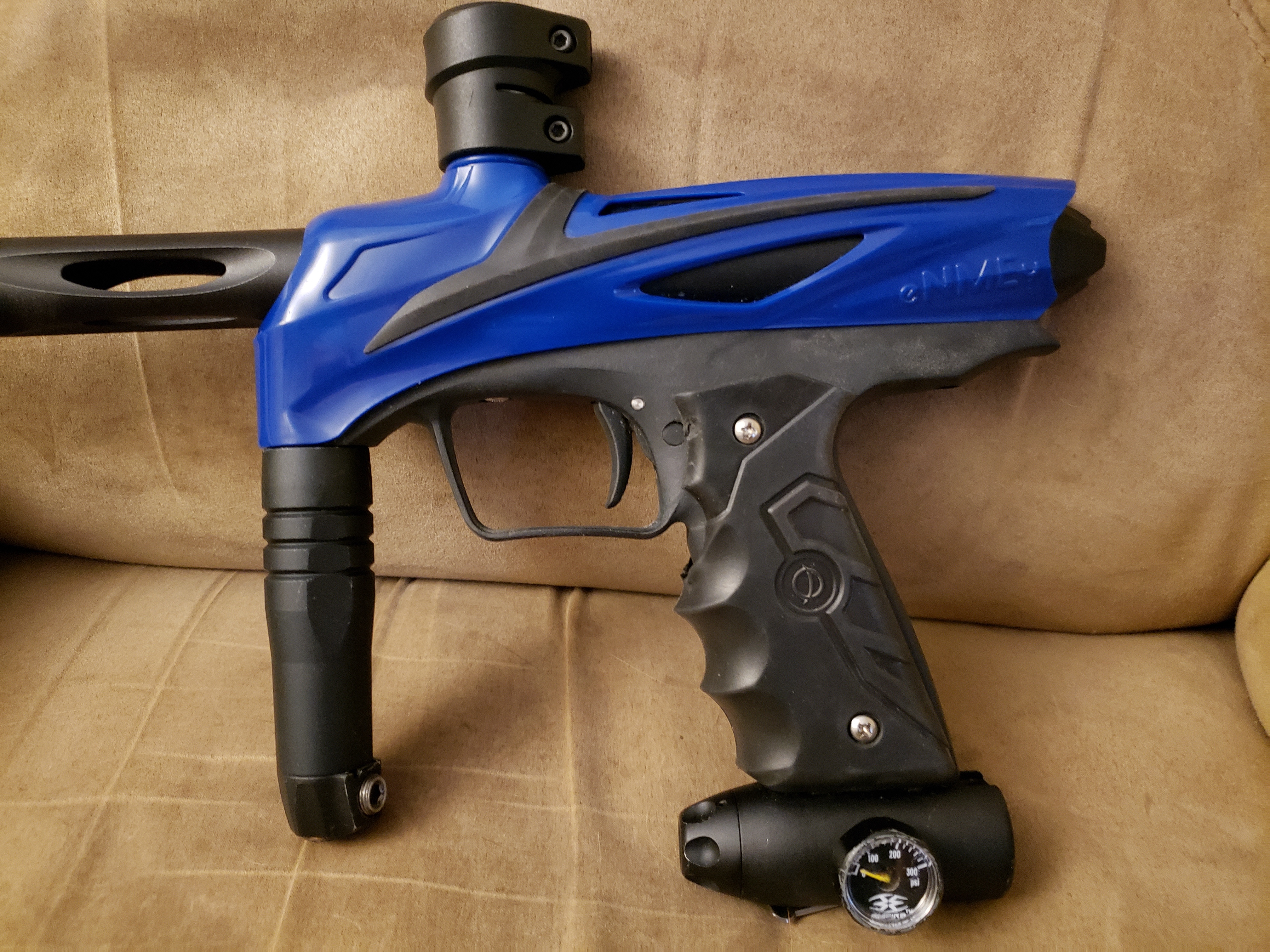

        Gog eNMEy, 3 screws removed to get to this point. The air comes in from the black tube going all the way to the right. It goes into the cylinder looking piece (let’s call that a valve) from that tube, and then 2 tubes come out of the valve. The black tube coming out the back is actually hard plastic built into the valve. It looks like it is a direct path from the black tube in the front, so no crazy paths the flow has to flight. The blue tube is smaller. That puts air in front of the bolt and returns it. A little pin molded into the trigger pushes the valve from the bottom and vents the air in the blue tube allowing the air behind the bolt to move it forward. The blue tube is sealed off from the incoming while the valve is venting, so it you hold the trigger it doesn’t just dump air.
        I added an on/off, a clamping neck, and a Freak barrel and have enjoyed this silly little market ever since. It’s fun, reliable, and easy to maintain. The tube in the plastic body for the clamping neck to grab broke, so I milled off the top, threaded the inside of the plastic for a different clamping neck, and just recently have found 3 tiny cracks in the body around this neck, so it isn’t secure anymore and really opens the cracks with a full Revvy tipped at an angle. I want to tap the metal firing can like I had to do with my other eNMEy when I put an Ion body kit on it.
          I would love an eNMey with a cool Ion body
        • Brokeass_baller
          I plan on modding an Ion body onto my eNMEy eventually. I've heard the v1's had weak feed necks, but the v2's fixed that. I have both, and honestly haven't experienced any issues. Yet...
