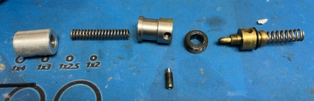

    I’ve got an early 90s cocker with more Sheridan internals than standard cocker internals. Is it worth convert to standard?

      I think the hammer becomes the issue. 2 out of 3 of my pre-2k cockers aren’t drilled for adjusting the hammer lug. The valve looks interchangeable regardless but not sure how the springs will work as the main string is super stiff in comparison to a standard cocker one.

        Worth it? Well if you wany ease of timing (aka top lug hole) and common springs for HPA yeah its worth it. If you just want to run CO2 leave it.

        If you are going to shoot them, upgrade the internals. It's easier to adjust spring rates than it is to clip coils.
        This can be overcome by removing the lug from the hammer, flipping it over, and screwing it back into the hammer from the bottom. You have to take the frame off to adjust it, but you don't have to drill a hole in the top either.

          This is how it was set up when I disassembled it, with the lug flipped. I also have another hammer that has a side adjustment screw in a different body.

          I’m well versed in cockers, but of the 2k variety. These were a great deal on local Craigslist and I pretty much have everything I need on hand, thankfully. I’ll build one to my liking and find new homes for the rest.

        I'm not a fan of dialers and old stuff like that. Getting a lug adjustment hole (if it needs it) and threaded for IVG is inexpensive and totally worth it.

          Couple years ago I picked up a 96 in a pile of parts off Facebook for cheap that had almost identical internals to those. I updated the valve spring, the hammer, the hammer spring, and threw a dialer in. Honestly it's one of my best shooting mechs now. Wasn't really that expensive either.

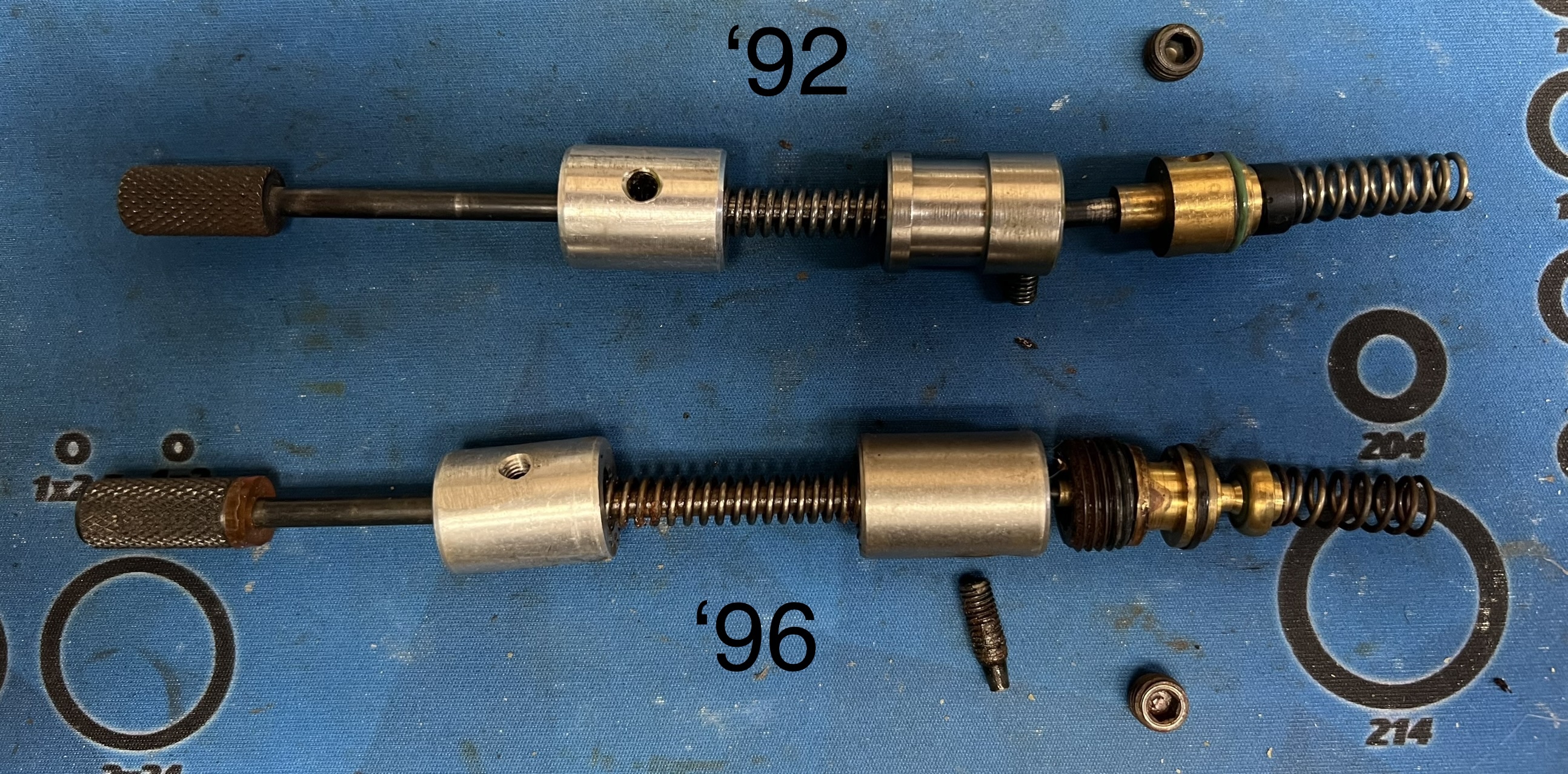

            Let me check I should have spare a threadless adjuster if you want to use standard hammer spring and hammer and use a stainless setscrew screwed from the bottom for the sear lug.

              Two are about ‘95 and one is about ‘92. One of the ‘96s is done up California Style. I have a male and female Stabilizer kicking around, the female being from my Hurricane.
              I think I might do the same and leave the ‘92 as original. One of the ‘96s has been modified (detent, lug adjustment hole) so it’ll be the better one to update.

            Turns out my ‘96 has a mixed bag of internals too.
