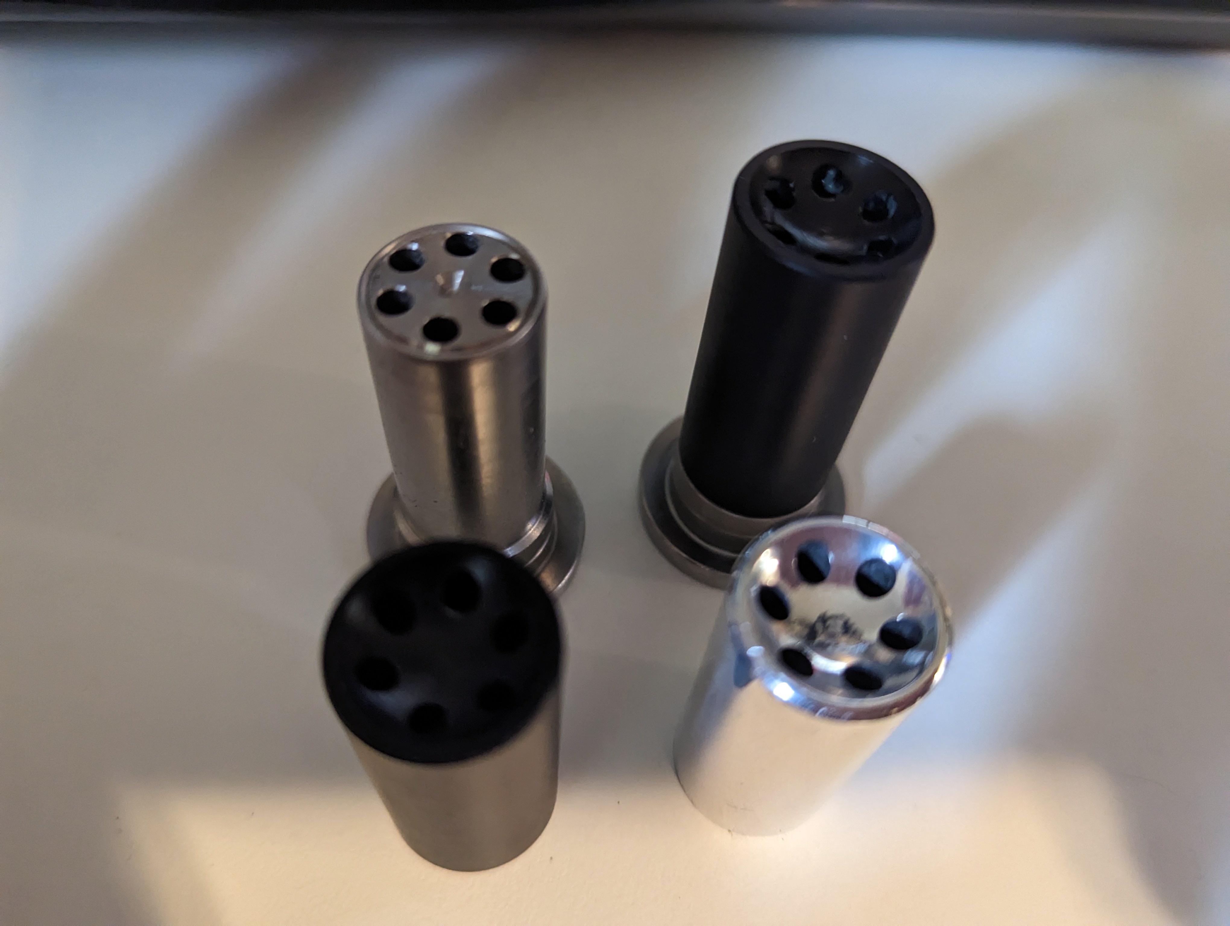

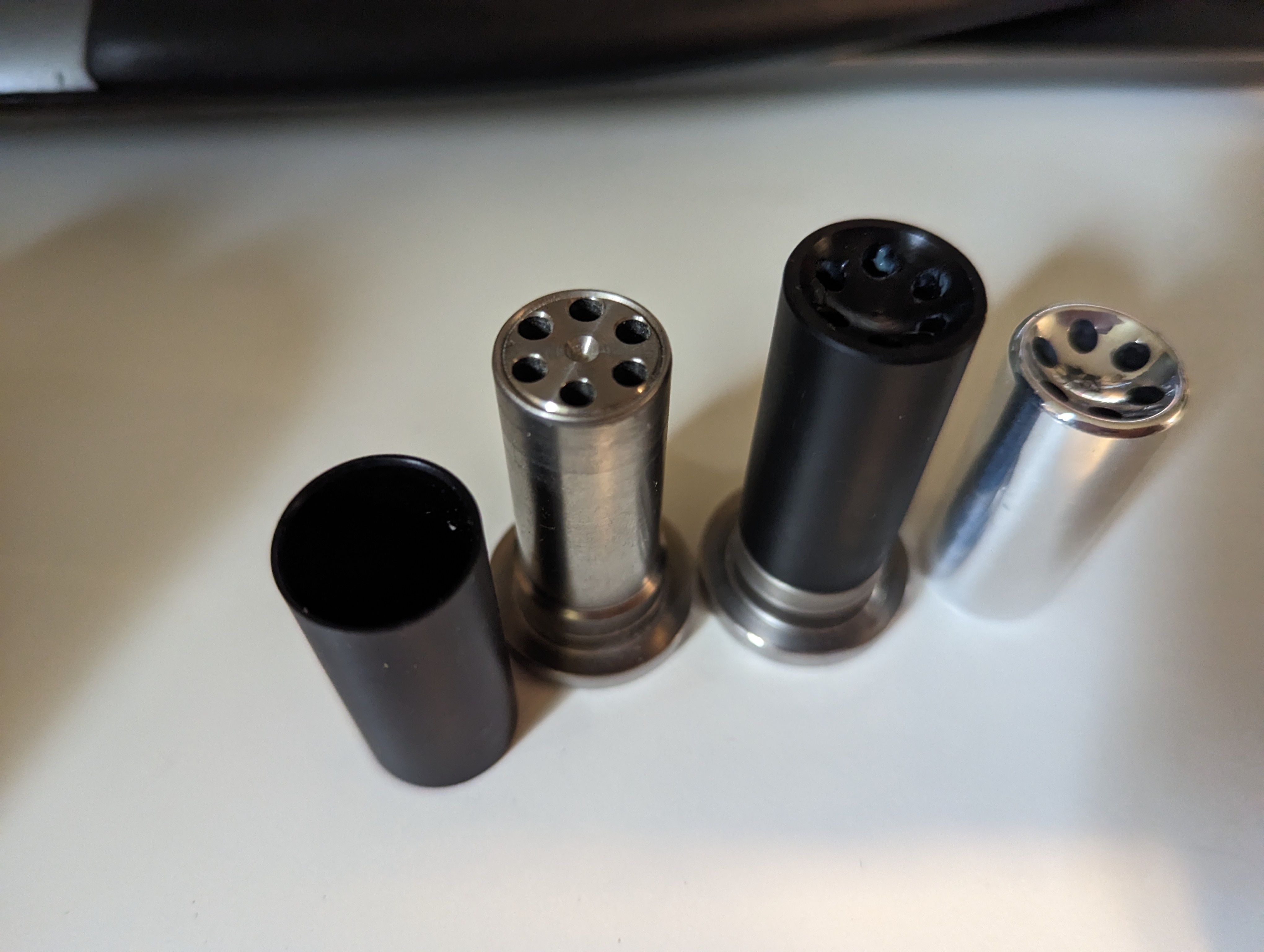

    After hanging out with forest_ptp for a bit he showed me a prototype Automag bolt that was started and never completed. The idea was a bolt that could accept different "sleeves", he had two types of sleeves, a delrin and a polished aluminum. Also this would be the first (and I assume only) delrin automag bolt). He said they had them made, but after the sleeves were press fit onto the bolt they had a tendency to fly off on the field. Unfortunately, the project was prematurely dropped to move on to more important things. He press fit one Delrin sleeve onto a bolt for me and I put it in my minimag pump. After about 100 shots the sleeve moved forward on the bolt about a centimeter blocking the feed port. it popped back on easily enough.
    Is there anyway anyone knows of to glue delrin onto stainless? Any suggestions on retaining this sleeve on the bolt?
    Thanks!

      Interesting that they didn't have it thread on, or at least be affixed with a screw from the front or back.
        scottieb commented
        I was thinking a set screw, or two. There are a lot of STBB bolts with the front delrin portion affixed to the rear metal portion this way.
      • forest_ptp
        forest_ptp commented
        On the right track. Biggest issue was that the sleeve has to perfectly align with the bolt, but that was one 20/20 hindsight thought. As to the other - maybe the best option, but I was always super paranoid about any screw-like exiting the barrel after a possible "Rapid Unscheduled Disassembly"...

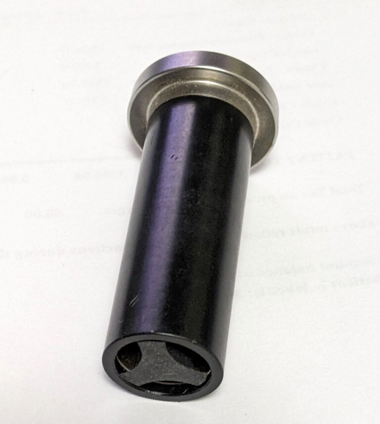

        I think it must be possible to bond delrin to steel, possibly through heating and cooling the parts? I actually have / had (I'll try to check tonight) a prototype AGD Delrin 'automag' bolt. Quotes are because it's actually longer than a standard automag bolt to discourage theft at events where it was shown. It was given to me when I was getting my FN303 up to speed as it too, uses a longer bolt than an automag.
        • uv_halo
          Paintball Ballistician
          • 286
          • Virginia, U.S.A.
          I snapped a pic. It is very similar to the one from PTP. A delrin sleeve over a steel core.
