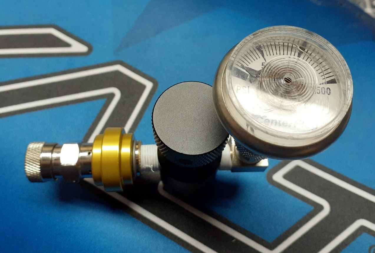

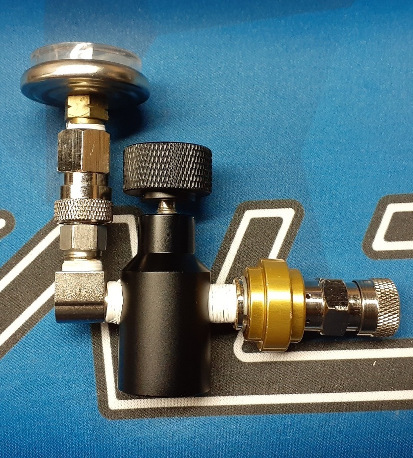

            Here is the one I use. Assbled it with some spare parts. Used a quick disconect so I can change the dial gauge depending on the range I need. Some will use a bigger 2'' gauge.

              I have so many spare remote lines I should repurpose a few. I’m using a DP level on/off which works well.

              What orings does the slide check use? I have a bunch of random unbranded slide checks that will get intermittent leaks when I try to use them. Whenever I take them apart the orings always have a gouge out of them. I've been using 015 in buna and urethane, 70D and 90D and nothing works.

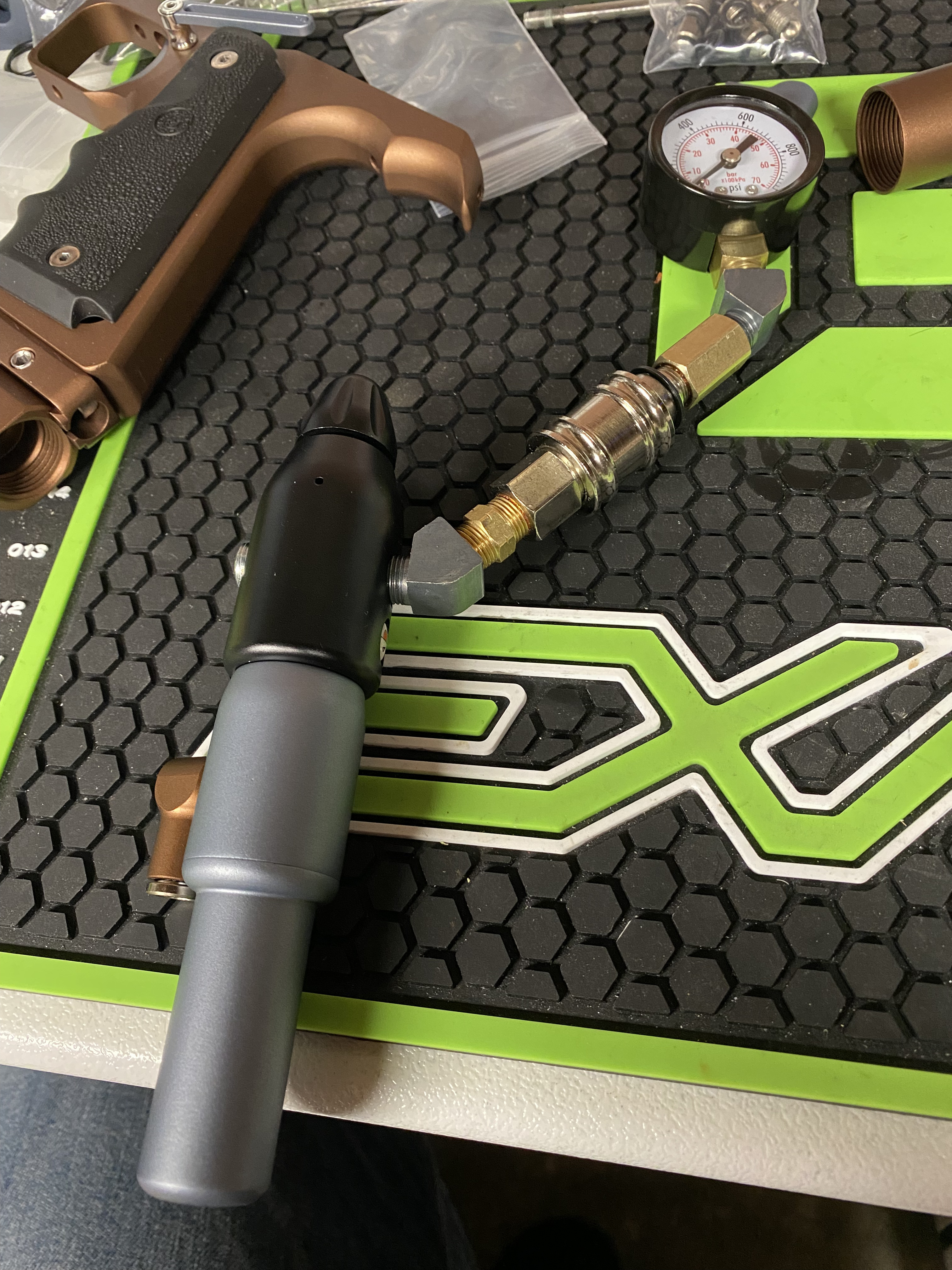

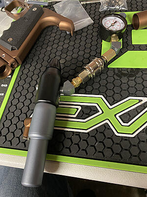

              I use this. Had both the remote asa and the in-line on/off in the parts bin. Works great because the on/off does purge.

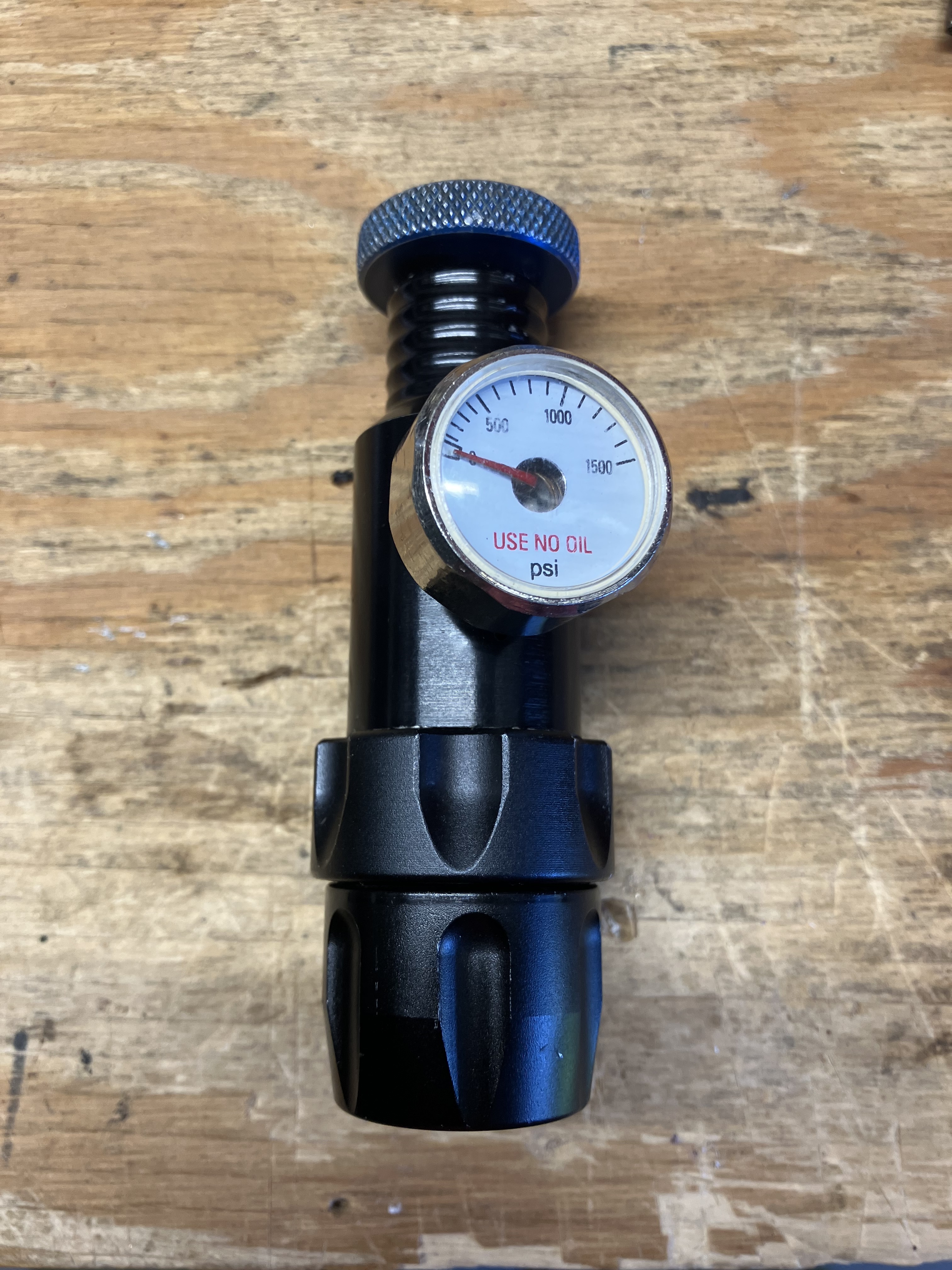

                  Behold the simplicity!
                  Push button on/off bleed. 0-1500 large ish face gauge on top
