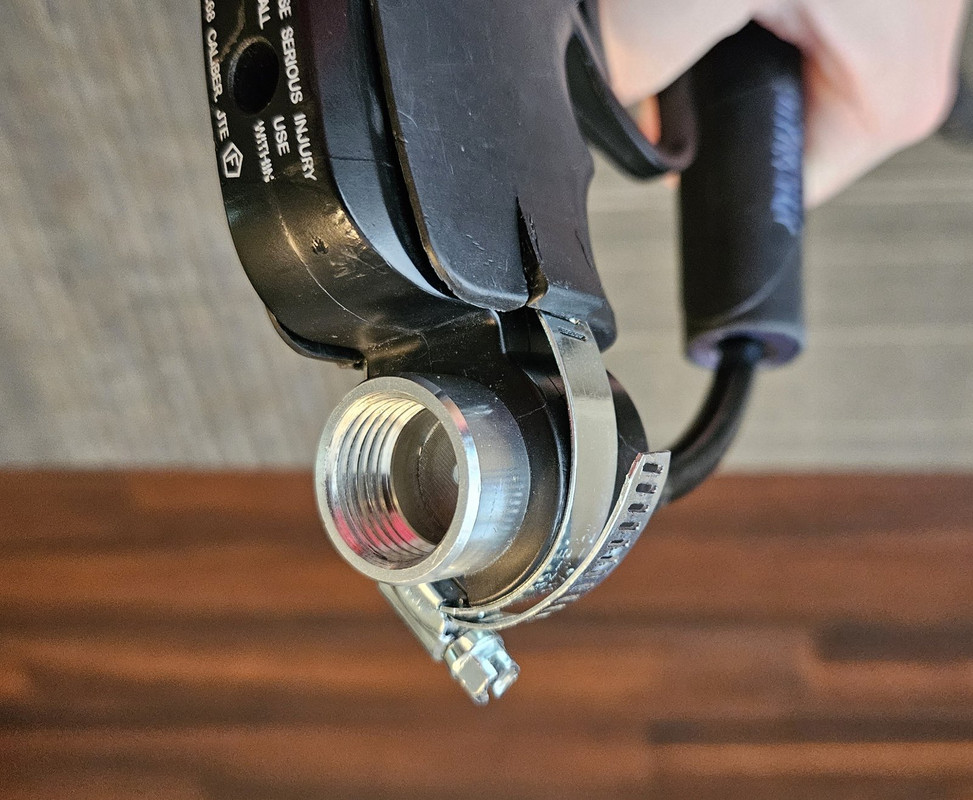

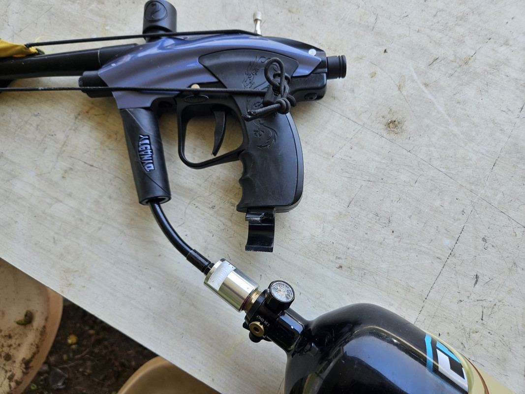

              So I tried to finally give this thing a whirl last Saturday and...
              Well... that ain't good.
                hahahahaaha oh man that's a bummer. I can't say I am overly surprised, but still. Are you going to try and repair and make it work or are you at the table flipping stage?
              • Arthur
                Arthur commented
                Just run it with a remote 😆 😂 😆
            • The Inflicted
              pǝʇɔᴉlɟuI ǝɥʇ
              • 1553
              #23
              I'm not totally done with it yet. My plan is to see if I can re-secure the ASA with a combination of epoxy and a steel hose clamp. I took a look at the structure of the grip frame under the rubber and I think maybe I can carve out a space to thread a clamp through and around the frame and then under it to lock it into place.
              What's kind of interesting to me is the way the ASA is keyed into the top of its little plastic ring mount in a way that makes me think the entire grip frame was injection molded around the ASA with the part already in place- there's no way for it to have been put there after the parts were created.

                #24
                Time for a hose clamp
