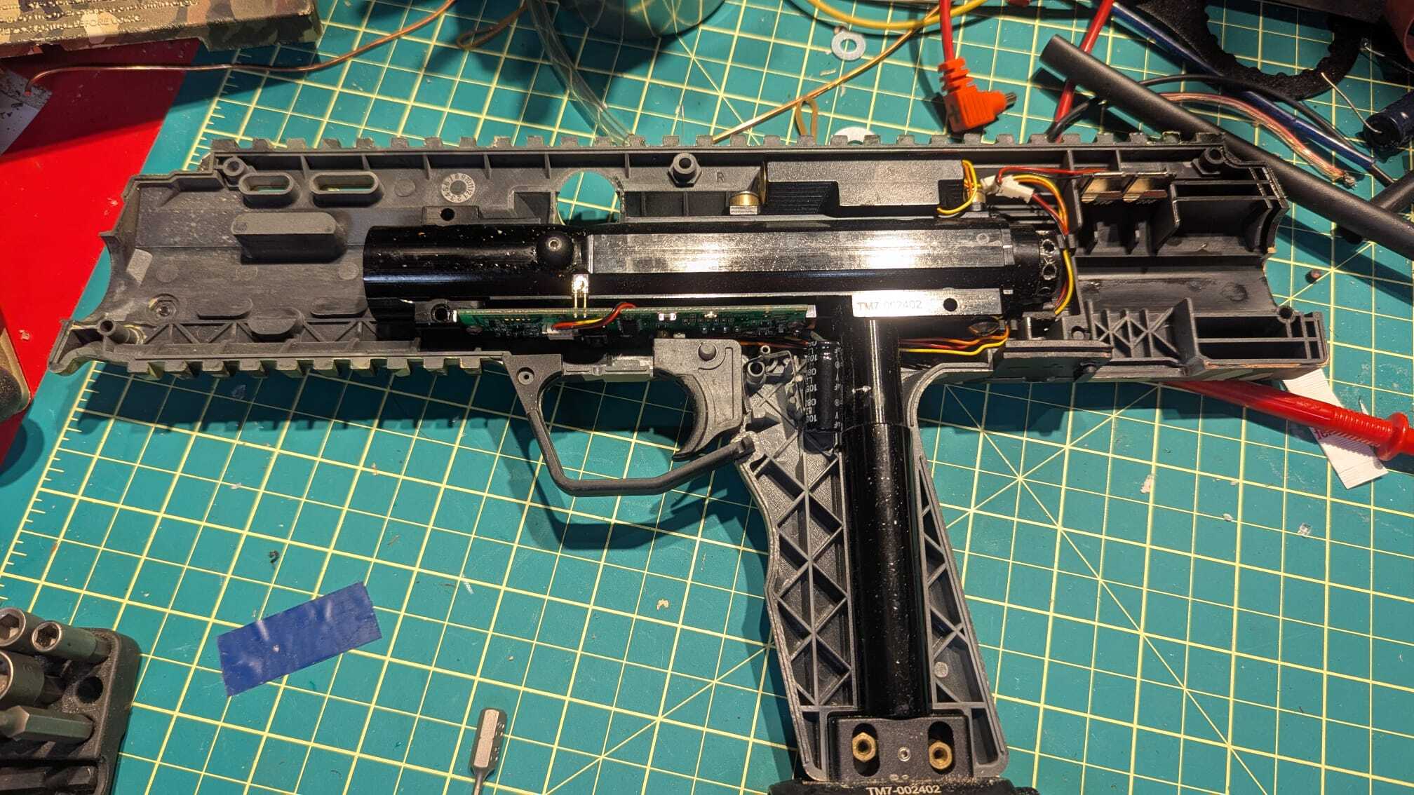

                    BT TM7.jpg ​Resurrecting this old thread. I have an intermittent solenoid.
                    I just inherited a load of old markers and a BT TM7 is one of them.
                    I did a complete stripdown and rebuild. Popped in a fresh 9v and it clicked! The solenoid fired in all 3 firing modes.
                    I went to bed came back the next day. Nothing.
                    The LED indicates Power on but in when I pull the trigger the LED flickers a reddish/orange but No clicks. I put a meter to the leads and no voltage.
                    I fiddle w it for 30 mins and then I randomly got a a few clicks then nothing again. Re-checked all the leads, cleaned eyes, disassembled the solenoid etc.
                    Wondering if it could to be the capacitor?
                    If I can't get this working willing to sell it [from Canada]

                        • 6185
                        Do you know if it's actually trying to fire? This is one reason I'm not a fan of the hall effects triggers, they are hard to tell if the board is actually trying or not. Same with the mode selector switch, it's hall effects as well and you can have the same issues
                        • badger
                          • 79
                          Ah, the Hall Effect trigger. Yeah, I get the theory. No moving parts, faster cycling, but it has a dead feeling.
                          I had wanted to put a meter to the components while activating the trigger and selector but unable to do this in situ.
                          • badger
                            • 79
                            Originally posted by RPP
                            I have a solenoid in a parts bin somewhere if you want to try that route.
                            Hey Thanks for the offer. I don't think it's the problem as I don't see it recieving any voltage-- There seems to be more electronics in the body of the noic but it's potted
